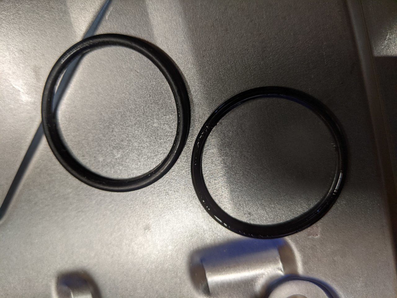

    The fluid check was done with the truck running and with the AT temp check light illuminated on the dash. The old fluid was slightly darker, but didn't smell burnt and wasn't bad looking. I don't have the old filter anymore, but I've got another replacement on order. I think I'll be replacing it again and trying to save what I can from the new fluid. I'll let you guys know what happens over the weekend once I get a chance to work on it again.

    The 1st replacement filter was not OEM. I assumed since it was such a simple part that any brand would do. The new replacement is a WIX branded filter from rockauto.

    Issue solved. The replacement WIX filter came in today and I got it swapped in. It looks like the Amazon one had the right diameter, but the wrong thickness oring installed. The filter was bought from a reputable store on Amazon, but with the bin mixing Amazon does, I should have known that I would end up with a cheap knockoff anyway. Lesson learned.
    The new filter went in with a little bit of resistance on the oring (as expected). I saved all the fluid that came out when I dropped the pan (minus about 1/4 qt that spilled) and it ended up taking all that plus another 2 quarts to fill the trans back up to the right level. I then put just a touch more in as I've seen posted elsewhere. Another upside to the WIX kit is they purposely make the bolt holes in the gasket smaller than required. This lets you put all of the pan bolts through the pan and capture them in the gasket before you put the pan on the truck. No need to go fishing around and trying to line up the rubber, it was completely held in place on the bench.

    That’s great news. It’s wild that a seemingly insignificant O ring can have such an impact on proper operation!

    Sealing is important! The infamous Challenger disaster was caused by faulty o-rings. They seem like simple parts, but they are actually incredibly dynamic parts that provide very important roles for many applications.

    My guess is that it got to a certain level of full, then it started sucking air past the oring. Since the level check was done at idle, it reached a balance of pumping a mixture of fluid and air through all the internals, and I'm betting that mixture had about 2 quarts of air in it. Once the oring leak was fixed, it could flush those 2 quarts of air out and needed the extra fluid to replace it. It was driving like it was low on fluid, but the level checks kept coming back full, so there was definitely air trapped somewhere taking up the extra space.
