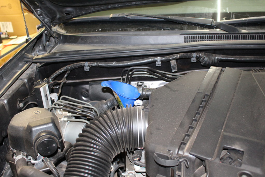

    Since it had so many miles without any ATF service I wanted to do a pan drop, new AT filter, and full flush. I used 12qts Maxlife, WIX filter and gasket set, a 4ft 3/8" ID tube for ATF cooler drain and 5ft. 1/2" ID 5/8" OD tubing for ATF gravity fill.
    I must say DO NOT use sprayers, pumps and any other method to refill ATF into your transmission, just use the funnel in the engine bay~gravity fed into your transmission is effortless, no drips, and makes it a pleasure to refill your ATF. Thanks so much to all that suggested this method, I will be using this for a couple other vehicles I own that need ATF service. Here's a pic of the long transmission funnel, there was plenty of hose to pull the funnel up and easily hold it and fill it, able to add 2 qts each time in 20 seconds or less.

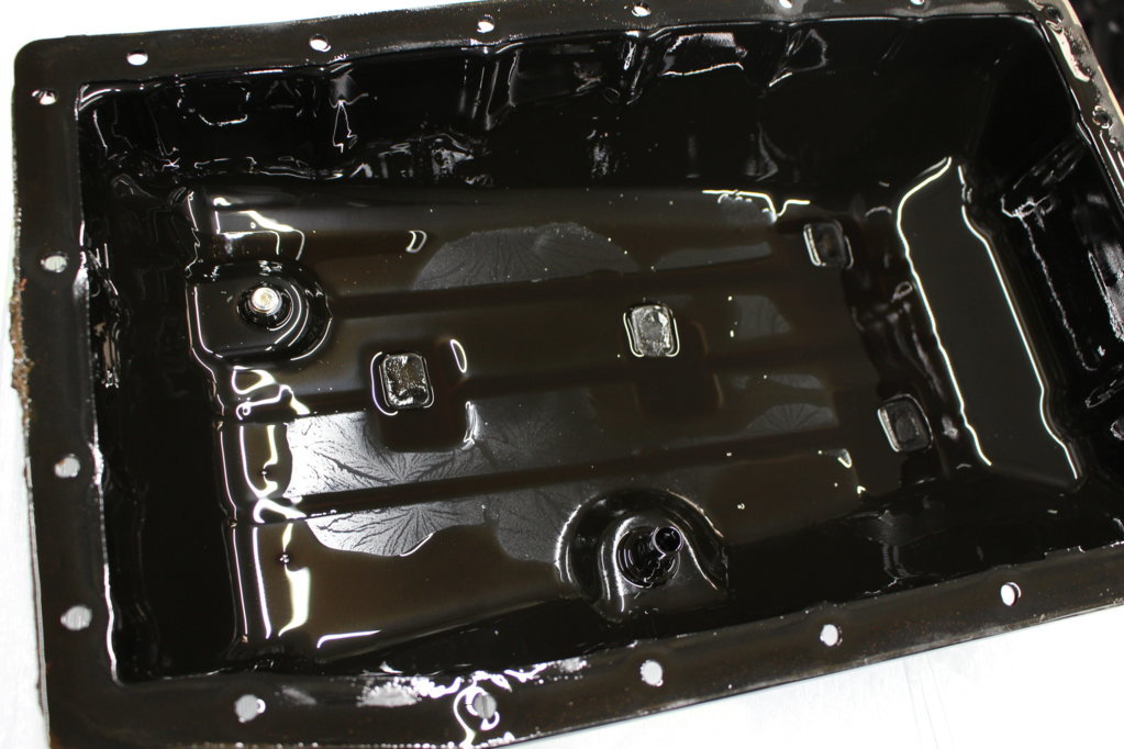

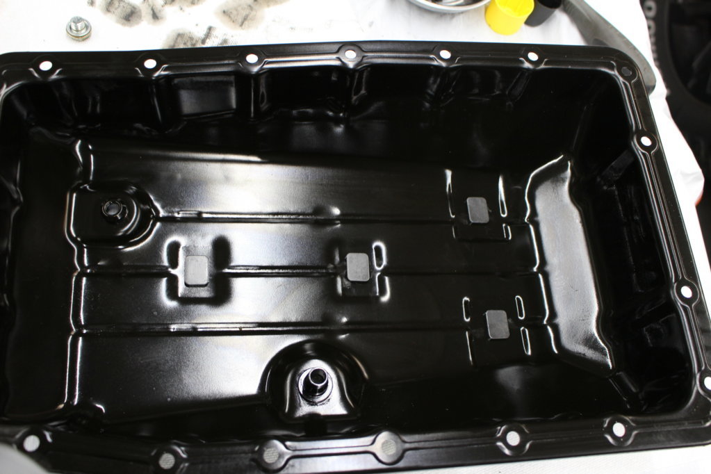

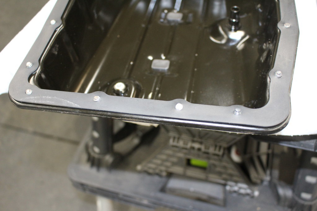

    Here's the dirty pan and clean pan, just clean the magnets & pan, and reinsert the magnets in the 4 recessed squares in the pan bottom.
    Install the new filter, MAKE SURE the o-ring is on there (and the old o-ring is removed if still inside the AT housing). Clean the mounting area for the gasket on the pan and the transmission mating surface. Install the bolts into the pan and gasket just a couple threads in to keep the gasket aligned and makes it much easier to set the pan. Then install the pan snugging the bolts along the way, go around and final set them to 15 INCH lbs.

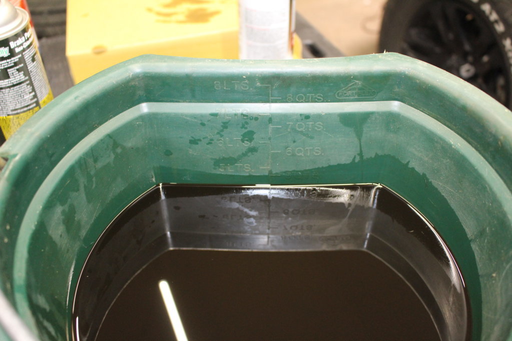

    Once pan is installed you replace the exact amount of ATF that you removed when draining and dropping the pan, I drained out about 4.5 qts (about a qt. more than those that didn't drop the pan)

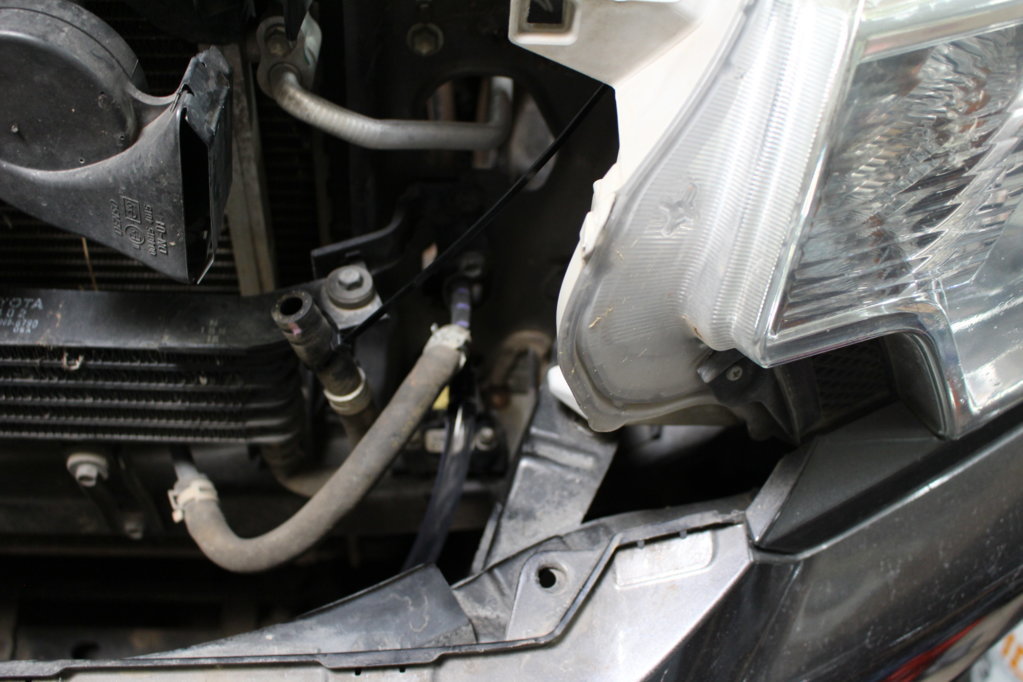

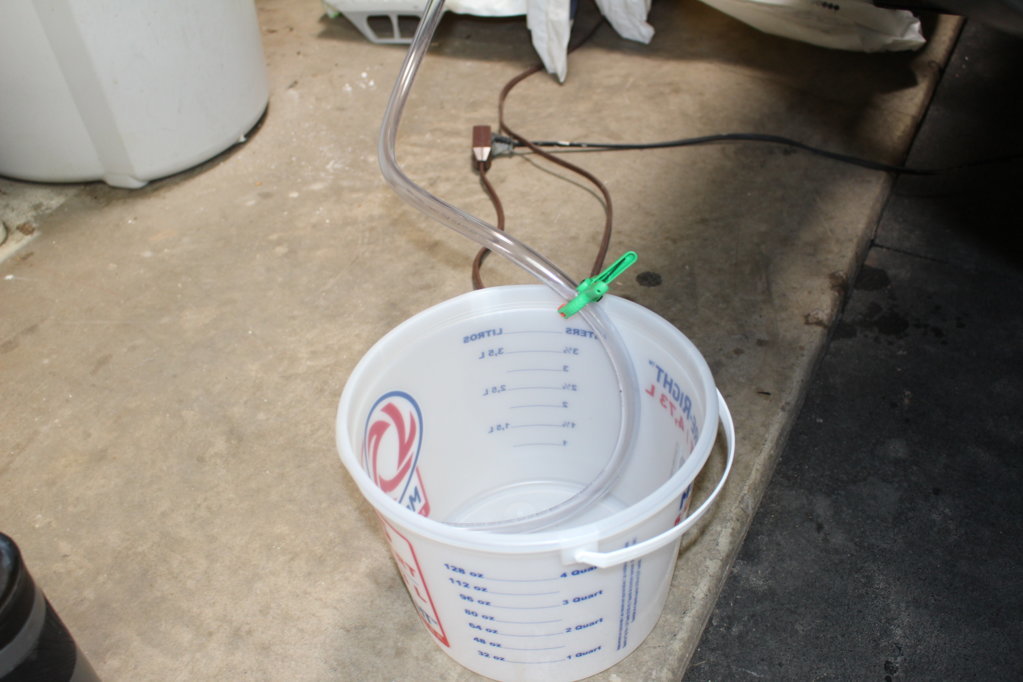

    If you have the tow pkg it's simple, just remove grill (2 10mm bolts and 4 push clips) and remove lower cooler hose. Connect a 4 ft 3/8" ID hose to the hose barb and clip it to your bucket.
    Once you replace the amount you drained from the pan drop you then start the truck and drain 2 to 2.5 qts into the bucket, be sure to cover the bucket w/ a towel or plastic as it will get air in the line and make a violent splash when it starts to flow out the line (it will do it each time).
