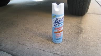

    1.) Get a can of Lysol with a scent of your choice.

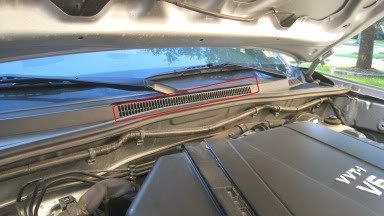

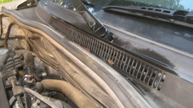

    2.) Locate the air intake vent for the A/C Fans, NOT Engine Air Intake. (highlighted in red)

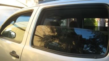

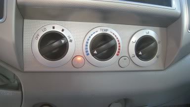

    3.) Start your truck, put the Blower on High, A/C ON, and Turn off the recirculation. You can leave your driver's side door open for now, so it can vent out.
    4.) Spray Lysol into the air vent, i did about 4 sweeps back and forth. I didn't want to do to much in fear of shorting something. Then let the A/C & Blower run for a while so the Lysol can work its magic through the system.

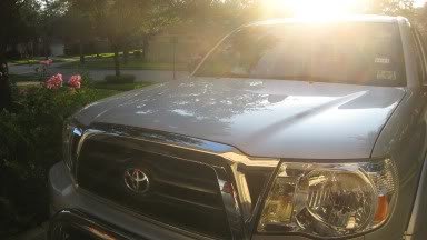

    5.) Close the drivers side door, after waiting a while shut the A/C & Blower off, Open the windows a bit to let the truck air out and then shut off the engine, if you read the warning on those lysol cans it says , "Hazards to humans and domestic animals" :D
    6.) Close the hood, and now just let your truck Air out! You're Done!
