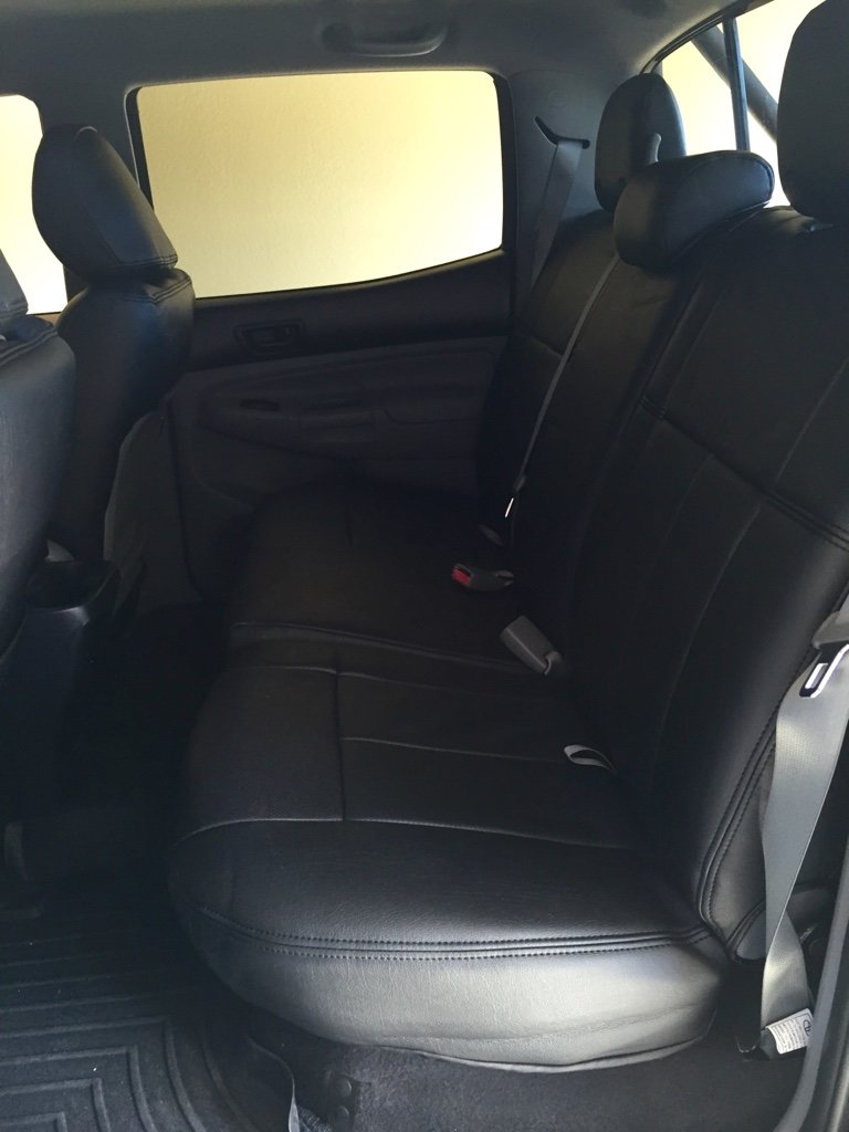

    Clazzio rearsf711716a5f4c1e4a5345056f70c94571_57077245900c6f8e5d8f074d2a4d6ab02fdedb64.jpg
