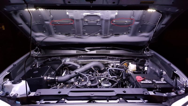

    Would you mind taking and posting some pic's, I'm having a hard time understanding exactly where you placed the film. I have the "functional" scooped hood, but it still sometimes vibrates right at the back when when wind is just right, and it drives me crazy. I say functional scoop and clearly it's function is to use it's mounting bolts to sandwich the hood between it and the cross bracing.:D

    I did not fix it myself, my dealer fixed it. I would not let the dealer replace my hood considering how easy it is for them to fix it with proper adhesive. This is not a Toyota specific issue and fixes are well documented from other mfgs. My dealer talked to Toyota and was told what adhesive to use.
    Once you have it fixed, you may still see some flutter from the bracing flexing in two spots depending upon speed and wind. If you never had the initial issue you probably wouldn't notice this, but this is what the thick lamin-x is for. It keeps the two braces from flexing so much. If your hood frame is separated from the sheetmetal you need to get that fixed with proper adhesive prior to worrying about trying the lamin-x. Not sure what you think double sided tape will do......

    I am not sure the underside of our hoods would be the same. I found this image online and circled the places where I put the clear lamin-x. 20151207_204552.jpg

    Thanks very much for that. I believe the hood bracing is the same between hoods, it's the skin and scoop that are different. Notice the holes in the center two supports in your picture, that are a little further forward than the red marking. That's where the scoop bolts through to.
