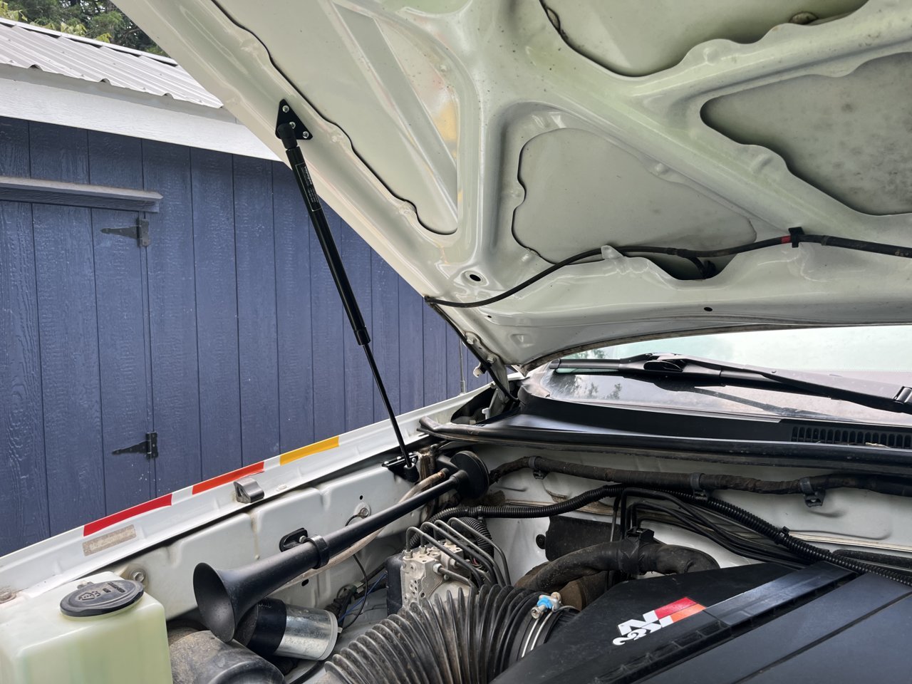

    I just came to the realization that I needed struts on my taco after raising the hood on my Kia and finding it so wonderful to lift!! lol
    I just ordered 70lb struts as 80 still seems like overkill. I'll follow up when I'm all installed.
    https://www.amazon.com/dp/B0BNBM4JKL?ie=UTF8&th=1
    https://www.amazon.com/gp/product/B08MWK6DBF?smid=A1A7ZFHKP74422

    So I installed my hood strut today. Yes, a single strut! I bought a 70 lb kit and discovered that a single strut from it was perfect to lift the hood and hold it in place. I think both would be too much. I’d include a video, but admins don’t allow it :p
    it took all of 10 min to unpackage and install. :thumbsup:
    dpele[OP] and TRDSport10 like this.

    The only concern here is the leverage placed on the single strut mounting points when opening and closing since it’s not being distributed evenly to both sides. I could see the mounting holes where you used rivets or screws wearing out.

    I've had the ball studs break off from to much lateral load

    I’m digging that “get of the damn phone” horn. This is what I call the tailgater button.

    I would agree but the sturdiness of the hood hinges and the multiple screws on both sides of the strut, I wager the frame will rust out before this becomes a concern.
