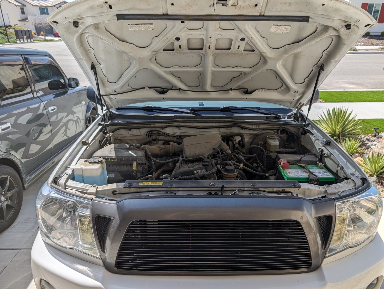

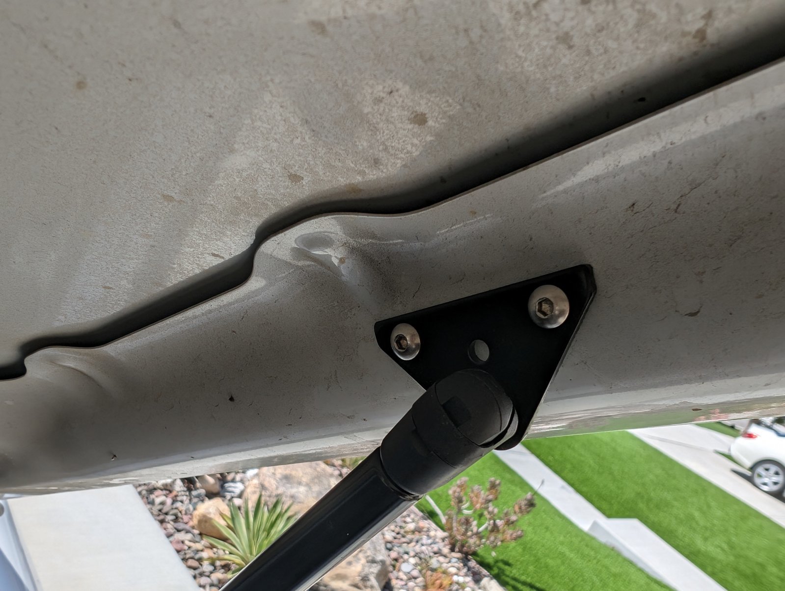

    Just did the 60 lbs. struts and they work great. For the first time in forever my hood pops up enough to get to the latch easily and goes up nice and smooth. Closing doesn't have too much back pressure, just have to close it firmly. I ended up going with the strut and bracket bundle for $41.99.
    C16-08260 19.7 inch 60lb Per Gas Strut Shock Lift Support, 10MM Gas Spring Lift Strut Bracket Ball Stud Black
    https://www.amazon.com/dp/B09DSZ6XXY
    I decided to go with rivnuts and stainless button head screws as I want to be able to remove it and the supplied screws look like they are cheap and will rust over time. Also, I had it all on hand so why not.

    Nice touch with the rivnuts and stainless screws!

    I agree with the stainless rivnut idea. @gstodd, what size rivnuts did you use?
  12. Mar 13, 2024 at 10:57 AM
    #52
    gstodd
    gstodd Well-Known Member
    Jan 17, 2023
    #415649
    410
    2005 2wd base 5-lug
    Pretty sure they were 1/2" #10-24. Might have been 10-32, I've got lots of both and just grabbed whichever screws matched the rivnut box I used. Thinking about it they were slightly coarser so they had to be the 10-24s Really doesn't matter as long as they fit.

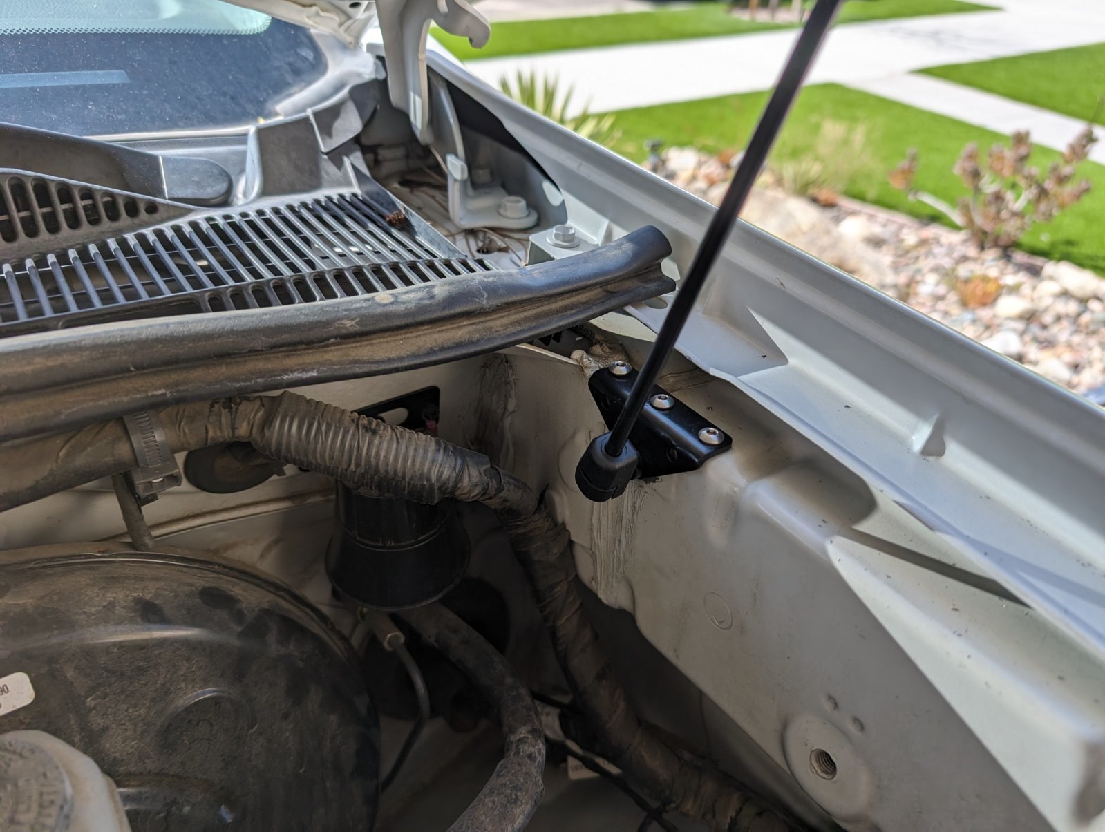

    Finally got around to this and glad I did. Used the 40lb 20" vegapoos set about 2" higher than stock hood prop and works great. Also a fan of rivnuts and the stainless button screws, already had some and they felt alot more secure than regular rivits. 1/4-20 or M6x1.0 were a good fit, just had to open up the holes on my bracket a tiny bit.
