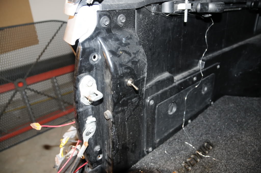

    Decide on a place to mount your switch and drill a hole:

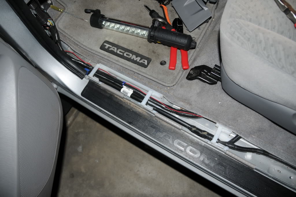

    Start running the wires from the tail light. I recommend not cutting the wire yet and leaving it on the spool so you have as much as you need. Just follow the black conduit (the pipe-looking object that holds all the wires) of your tail lights to under the driver's seat. This is where a solid copper wire is easier then a stranded because you can bend the wire into the angle that you need to push it through some areas and it will keep it's shape and not be weak like a stranded wire. You can pull it through where you can get enough grip on the wire while unspooling it from the tail light so you don't have to cut the wire yet and can get the right amount.
    Step 9:

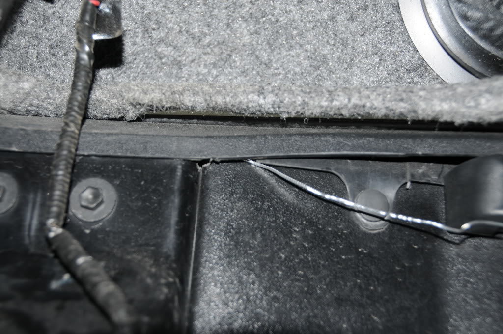

    Once you get under the driver's seat you should see the conduit split with one end going up into the cab under the driver's seat. Now pull apart the door sill of the driver side (just pry it up) and the kick panel by pulling up the foot rest and unscrewing the hand screw behind the kick panel:
    Step 10:
    (Before you do this read this post by caribe makaira: http://www.tacomaworld.com/forum/lighting/154477-diy-how-led-strip-bed-lights.html#post3108230 and http://www.tacomaworld.com/forum/lighting/154477-diy-how-led-strip-bed-lights.html#post3108146)

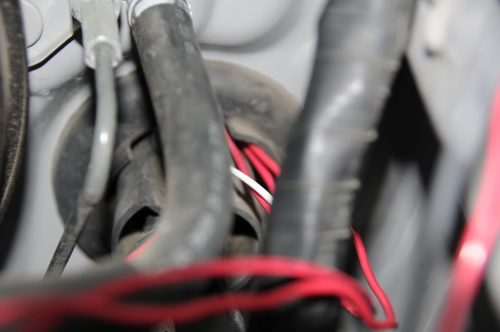

    Go back under the truck and you can push this rubber boot to the side a little bit and push the wire through and grab it from under the driver's seat's carpet, pulling it out:

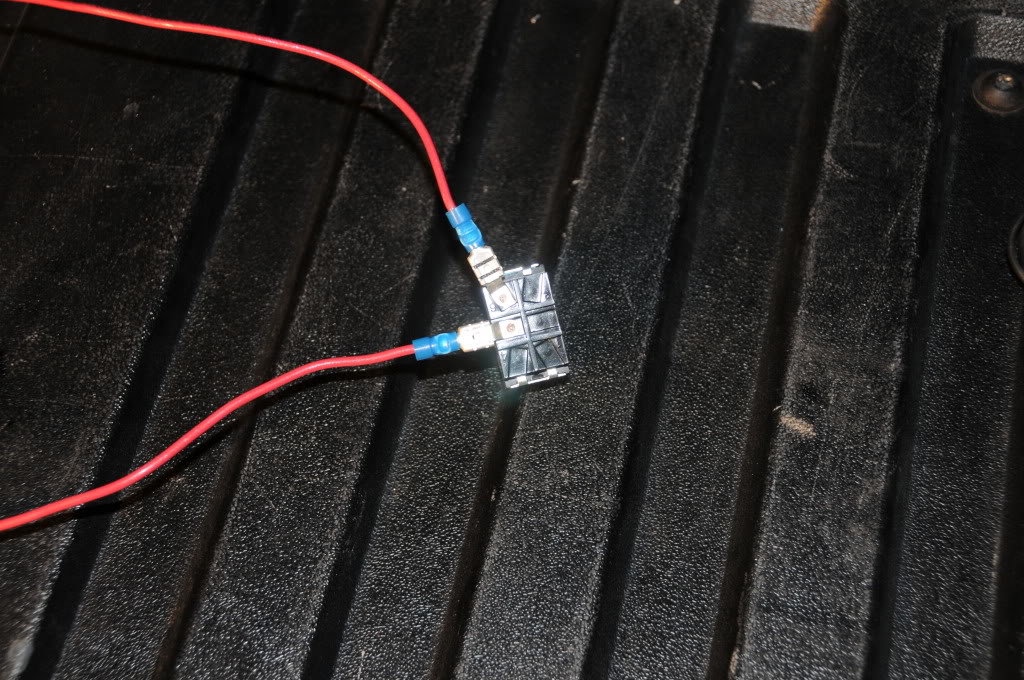

    Step 11(If using a fuse tap):
    If you are using a fuse tap, pull out your change holder and you will see an internal fuse box behind it. Using the back of the change holder as a reference, pull out the illumination fuse (in theory you can use any fuse) and insert this into the top slot of the fuse tap, insert a small amp fuse into the bottom slot (3A-5A) and slide the fuse tap into the slot of the original fuse. Then connect the wire that you ran from the tail light to the wire on the fuse tap by stripping the wire from the tail light, sliding it into the blue connector and crimping the connection.

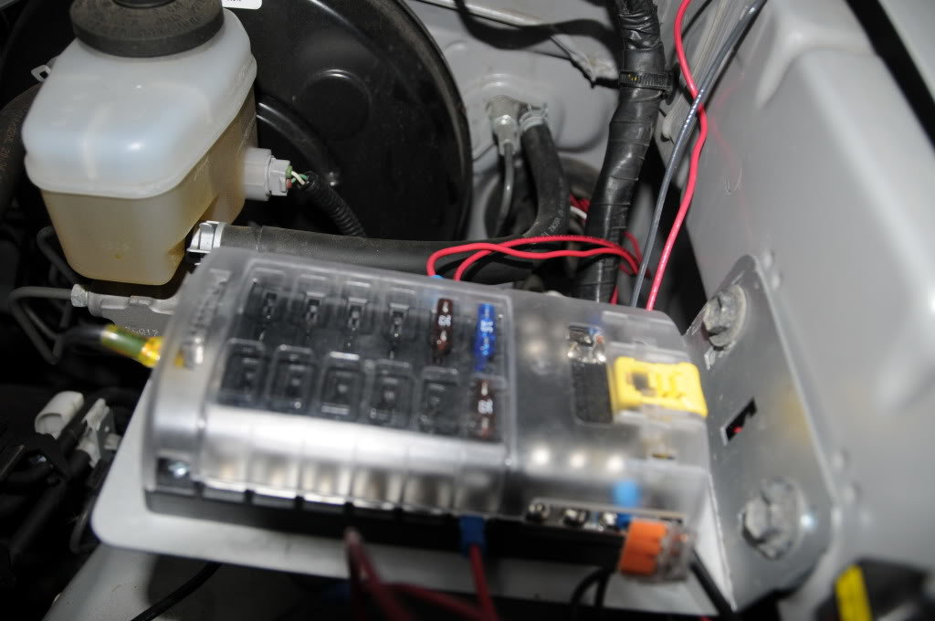

    Step 11 (If Using An Aftermarket Fusebox):
    Run the wire up where the kick panel would be and push it through the rubber boot that you can see a black conduit going through. I recommend using a wire hanger that you bend a small hook on one end and hooking it onto the wire and pushing the other end through the boot, pulling it through from inside the engine bay. Then connect this wire to the positive output of your aftermarket fusebox (remember to insert a fuse into the appropriate slot):
    Step 12:
    Now that you have all the wire ran through to your power source, you can go back under the truck, and zip-tieing it to the conduit that you ran it with where ever you can, keeping them as close as possible. Once you have it secure enough, go back to the spool and now you can cut the wire, but leave enough to reach your switch and maybe another foot or two longer just in case.
    Step 13:

    Mount the switch using what the switch has to offer:

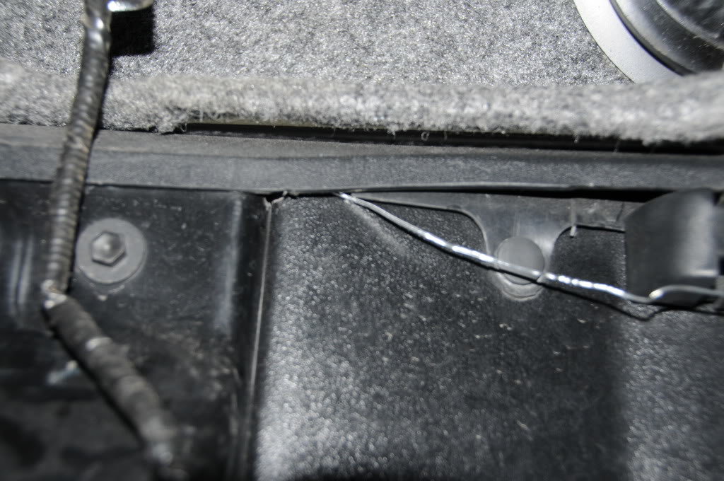

    Once the silicone has dried on the lights (mine said 3 hours). Apply molding tape down the backs of the lights. Clean where you plan on mounting them with rubbing alcohol, and mount them under the bedrails of your truck or in your desired location keeping in mind where you plan on running the wires from the lights. I had both of the 12v/Ground connectors closest to the tailgate. Make sure you have them in the same location on both sides.
    Step 16:

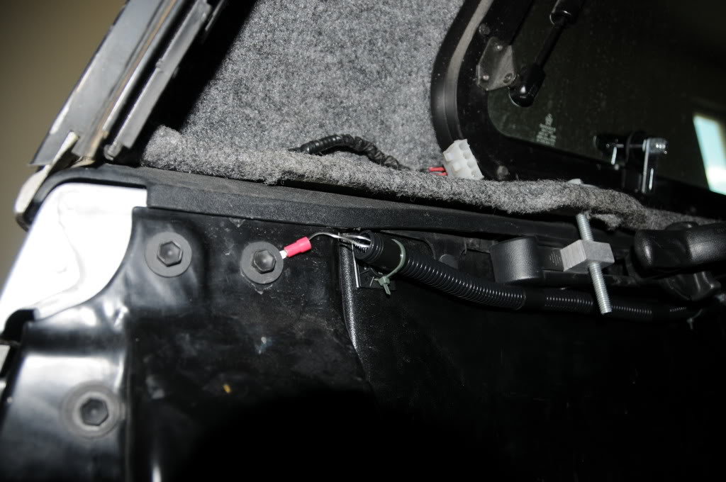

    Connect the ground wire to a ground on the truck's body/chassis. I used the bolt that you see on the left in this picture:

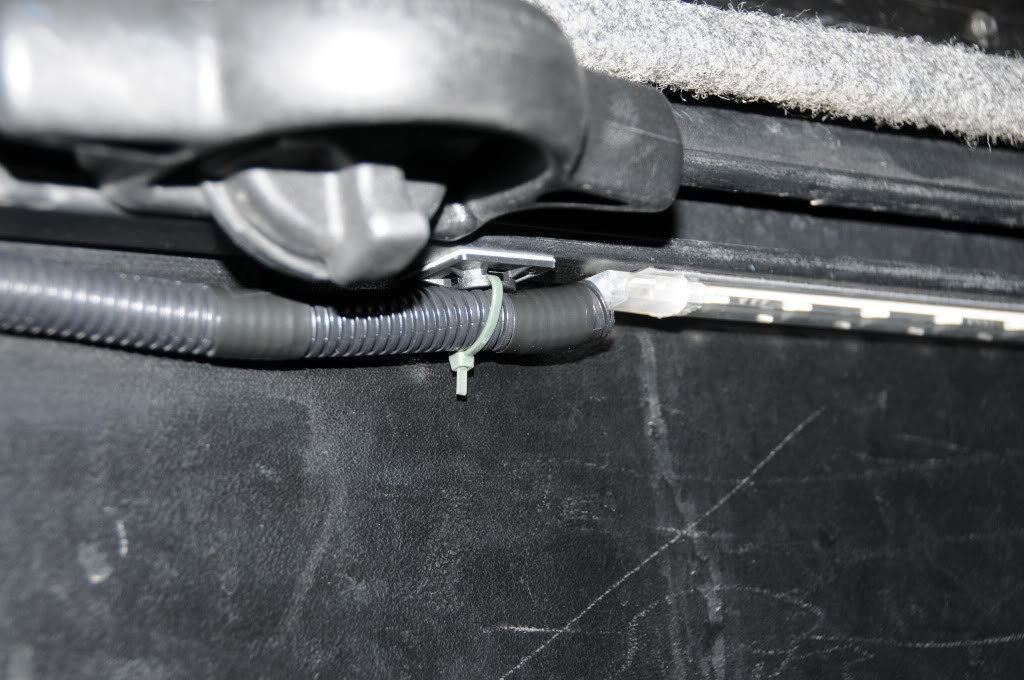

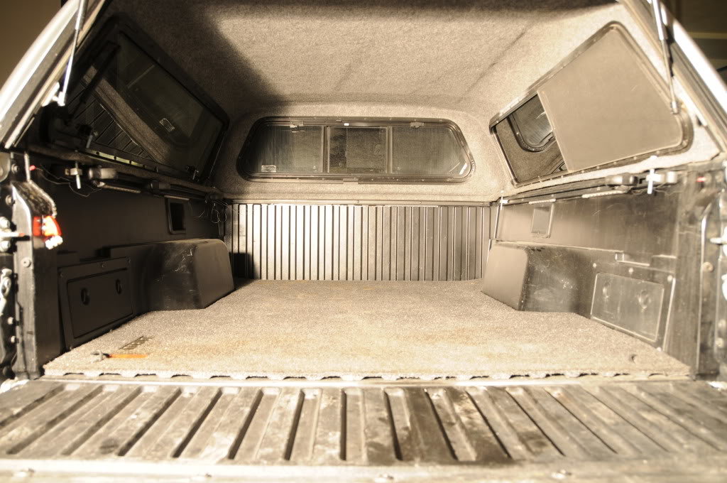

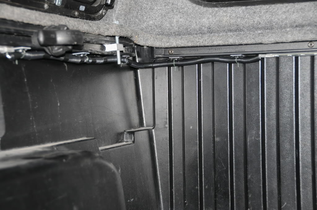

    Step 18:
    Use the black conduit to wrap around the wires in the bed and wrap black electrical tape around the conduit where you think it needs it. Then tape the zip-tie mounts where you think you need it and zip-tie the conduit to these mounts:

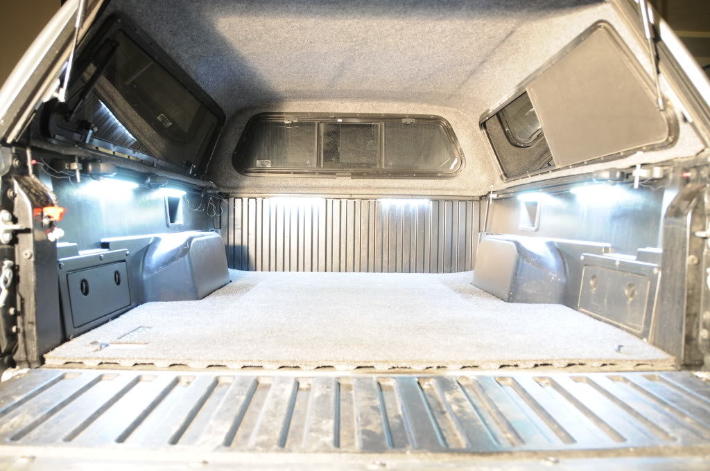

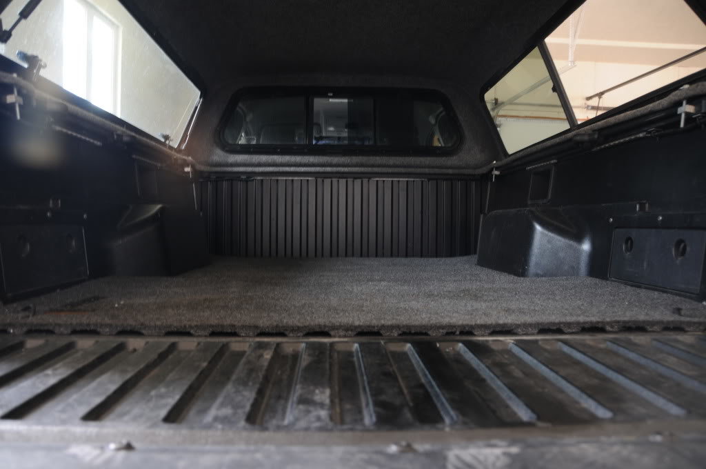

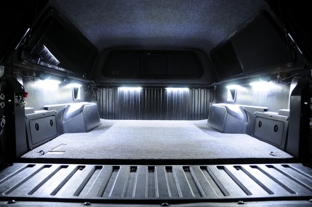

    How Mine Looks:
    VS 500W Halogen Lamp
    As you can see, my lights wash out the halogen under where my camper shell is :D

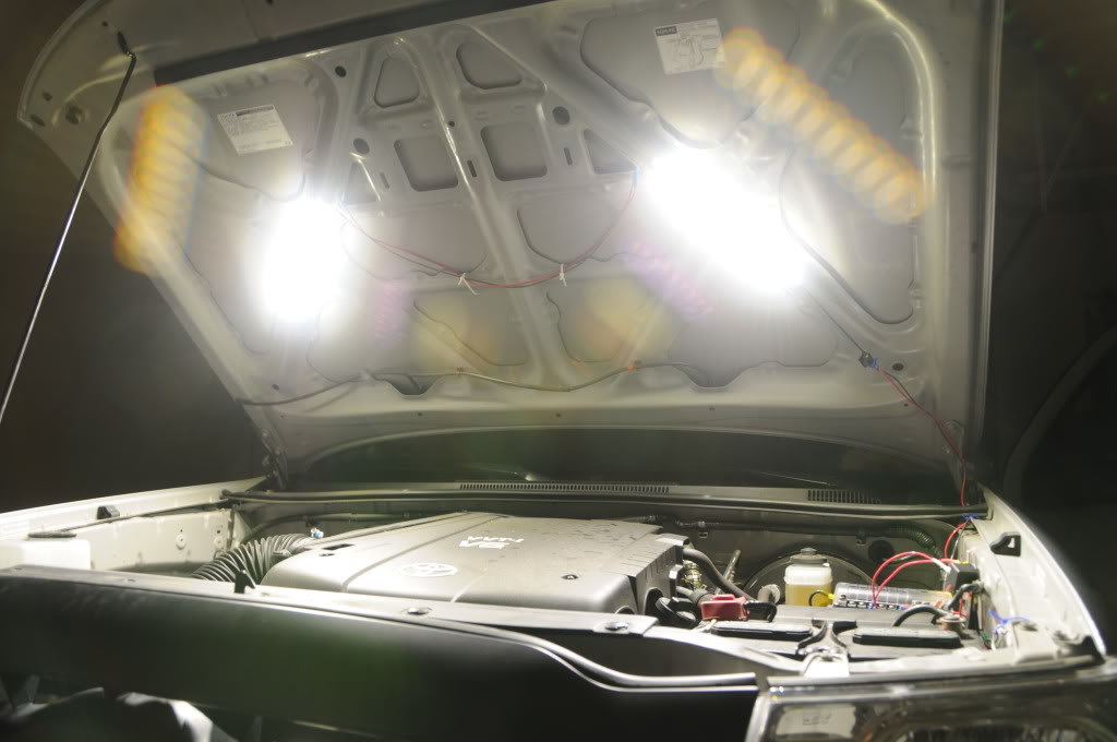

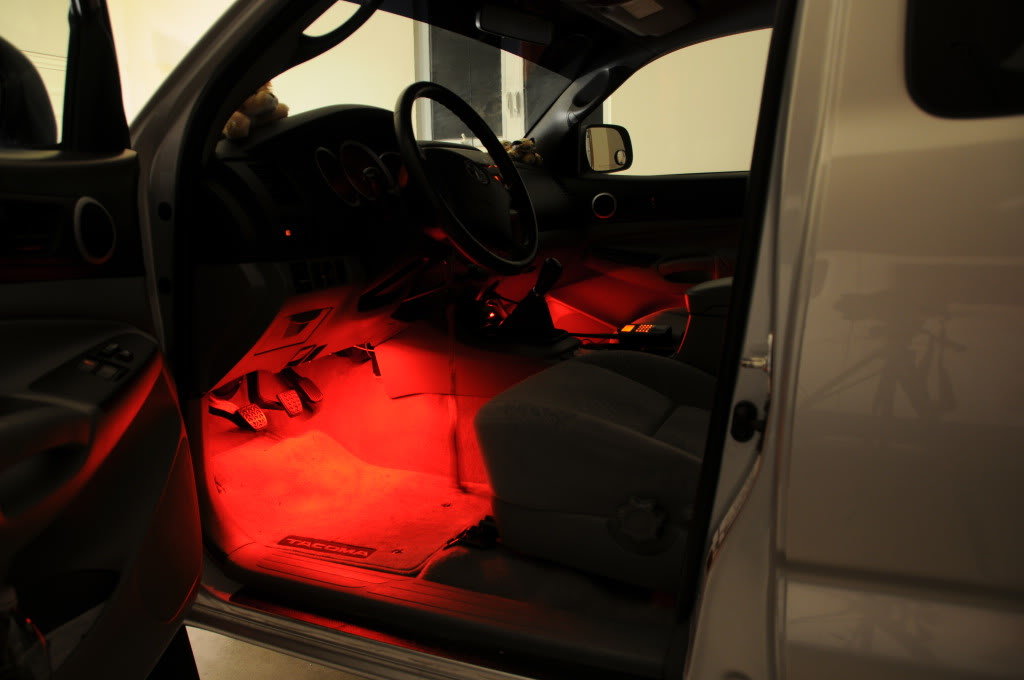

    My current other applications:
