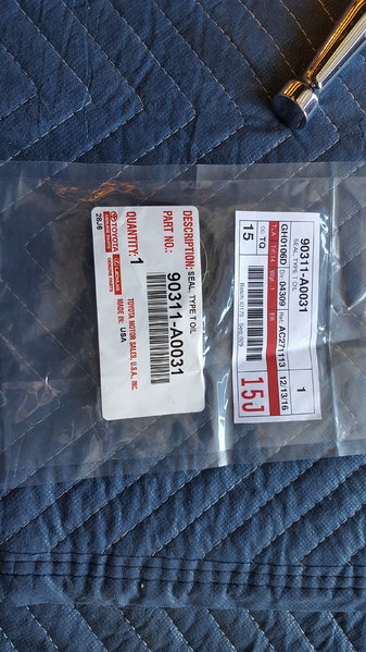

    Mar 15, 2016
    #181320

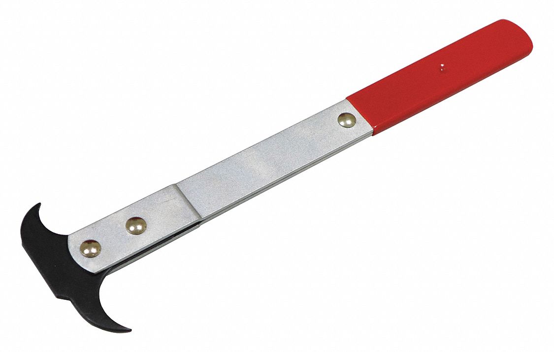

    Great write up. I own an 06 TRD Sport and it's been the most reliable vehicle I ever owned. Just hit 90k miles and after my last oil change my local dealer found the extension housing leak during the multipoint inspection and wants ~$540 for the repair. Needless to say I just joined Tacomaworld and I'm going to fix it myself. If anyone is still following this tread that made the repair. I would greatly appreciate a picture of the seal puller that you used.
  9. Jun 7, 2016 at 6:59 AM
    #69
    81shark
    81shark Well-Known Member
    Nov 7, 2008
    #10567
    4,079
    @Azrfr just saw this... i used one that looked like this https://static.grainger.com/rp/s/is/image/Grainger/45FF24_AS01?$zmmain$
    just work your way around the seal. it's takes a little elbow grease to get it out.

    I installed this one.
  19. May 10, 2017 at 5:19 PM
    #79
    1000rrk
    1000rrk Member
    May 4, 2017
    #218199
    14
    Brian
    Prerunner
    What is the actual part number? Looking to order the double lip one and want to make sure it's right
