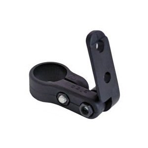

    What size of rear bracket would work on the Tacoma? Is this too big or small?

    There are basically two about that size and either one should work. You will want to use some of that foam tape on the inside to make up any gaps that occur.

    ^ Thanks for the advice. Foam tape... sounds good.

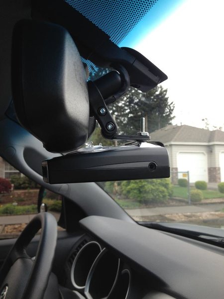

    Tried it on my '08 RC Base.
    Dunno if the mirror stems are different or not but there was no way it was going to work.
    WalMart only had one size... it was for a red flashing light, not the reflector.
    It included a piece of rubber to wrap around the stem to take up the extra space, but it wasn't nearly enough.
    I ended up using a U-Bolt and steel corner brace.

    Well with the ones in the picture you have to remove the screw and spread it open quite a ways to get it to go around the stem. From your description I'm not sure if this is the issue you're having or not but the mirror stem should be pretty close and the foam tape should make up the difference. Did you remove the plastic keeper that is clipped on the stem to hold the electric cable? I mentioned that in the first post as there's no way any of these will go around with that still in place.

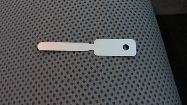

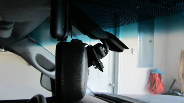

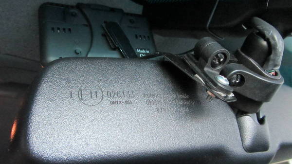

    Just got my Ultragauge thanks to the GB. Did the mount with the reflector bracket and digging around my garage to find something else to help with the mount (my reflector bracket was a little different from the OP's BTW but it was free) and found a stereo removal tool from one of my old aftermarket units. Bent it as needed and painted it black. Stuck some of the velcro to mount the UG to it and done. Cord was just barely long enough btw. Here's some pics. This install didn't cost me a penny. :)
    [​IMG][​IMG][​IMG]
    And this is the removal tool I used for a bracket.
