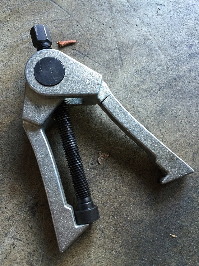

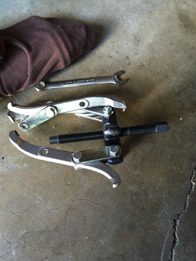

    Use this 5 ton puller from Autozone to remove steering stop. Pickle fork didn't cut it for me.
    Crank on the puller, smack top of balljoint, crank, smack, till it falls.
    Tried this puller but fractured it. Mine were seized pretty good.
    Either way I still won.

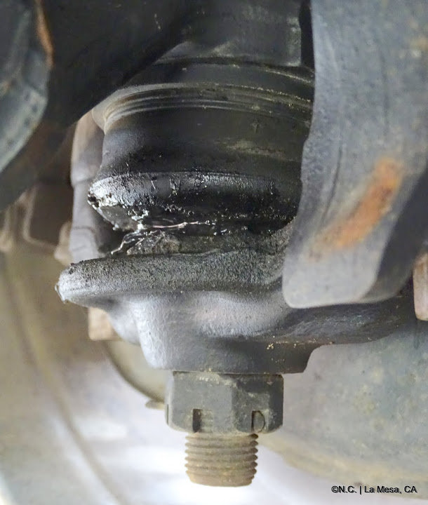

    I'm not at all happy that I'll have to deal with this soon. My drivers side LBJ boot is torn and leaking grease. I've tried to tell and I can't tell if there is play in the joint. Either way, it's a time bomb I'm gonna have to deal with in the near future. Truck has 60K miles on it.

    My driver side LBJ looked identical to Crom's; however, after removing it, it had no tears. Just a shitty design that let grease spilleth over. However, mine did have some play after 130K.

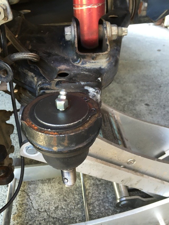

    Does anyone know if Moog finally started threading the hole for the zerk fitting? And is it necessary to use a 90* fitting, or is the 45* fitting okay.
    Thanks
  18. Mar 2, 2016 at 1:59 PM
    #78
    pseudomike
    pseudomike Well-Known Member
    Nov 4, 2015
    #168638
    132
    Michael LaValley
    2012 DCLB TRD Sport
    I just got a set from Rock Auto. They have the newer style boots which appear much nicer. Came with 45 degree zerk fittings and doesn't appear threaded but the I had no issue threading zerk in. As other have stated, the diameter is larger, you will definitely need a custom adapter to press them out if they ever fail. They say made in USA on them which is promising. I would replace the 45 with a 90 degree fitting.
