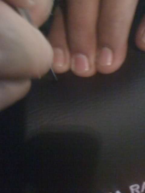

    After searching online for a DIY i couldnt find anything helpfull, only thing that helped was a video from youtube. Heres a quick rundown of the way i installed my leather, hope this helps!:cheers:
    with 2 people working together it took about 4 hours for the rear.

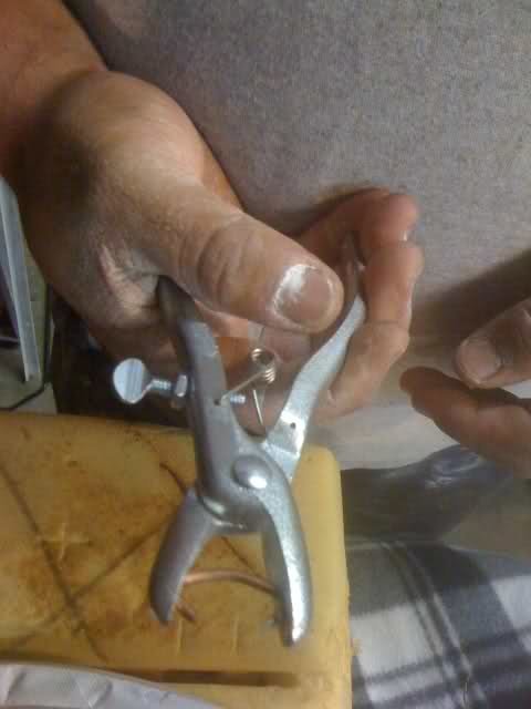

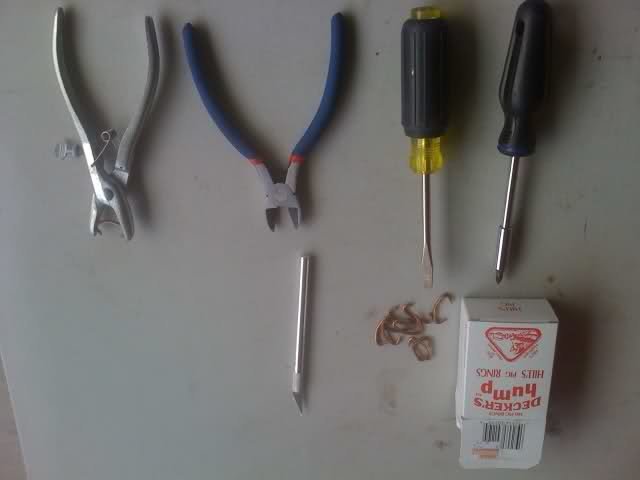

    Tools i used...i heard the hog ring pliers are hard to find and can be expensive, luckily i went to Acehardware and found a pair for $10 and a box of 100 hog rings for $3.

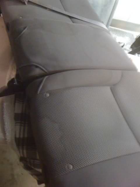

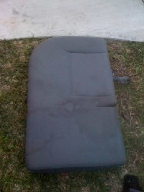

    I first took apart the rear seats...

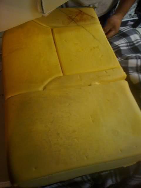

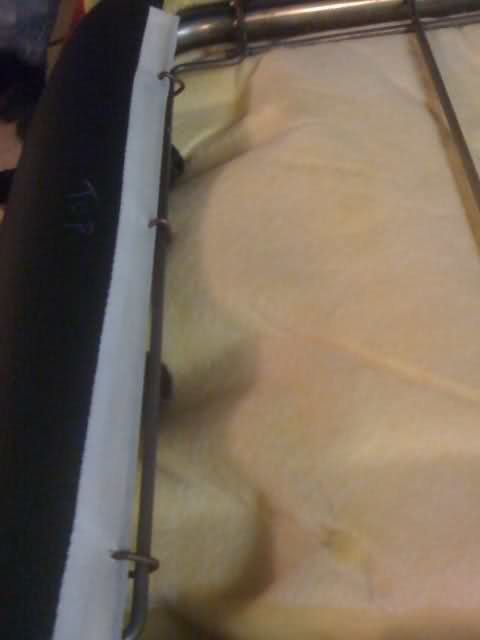

    flipped it over and pulled apart the stock fabric...in the cracks youll see hog rings clamped to a metal rod. using your tool snap/break it off by applying pressure and twisting.

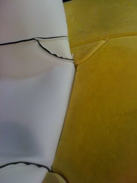

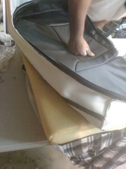

    Turn the leather inside out and place over your seat...

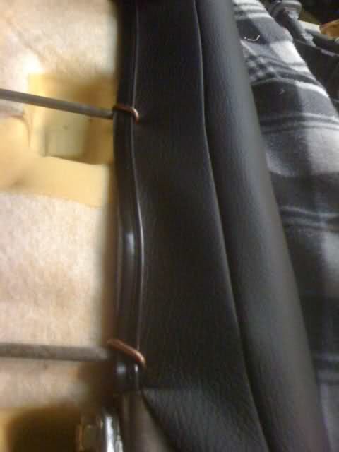

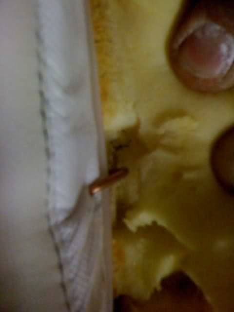

    Next you will be using your Hog Ring Tool...
    as you can see it comes with a plastic linning. you insert that between the cracks. at the bottom is a metal rod. thats where you'll attached the ring to.
    each side has 2 places where youll need to add a hog ring...heres what one side looks like...

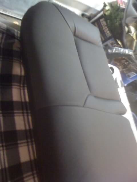

    after you apply all the hog rings to the needed places you then pull the leather over the seats. flip it over and it should look like this...then you need to pull the leather over the wedge and push it down so it locks into place. start on one side and work your way around.

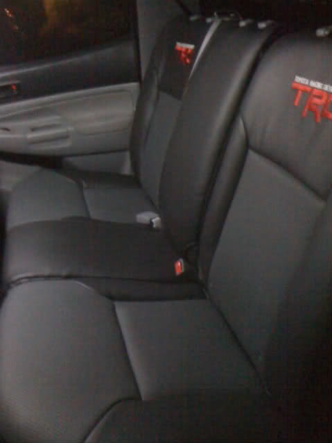

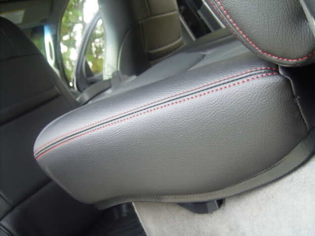

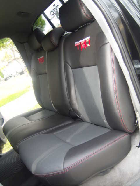

    heres what it looks like finished.

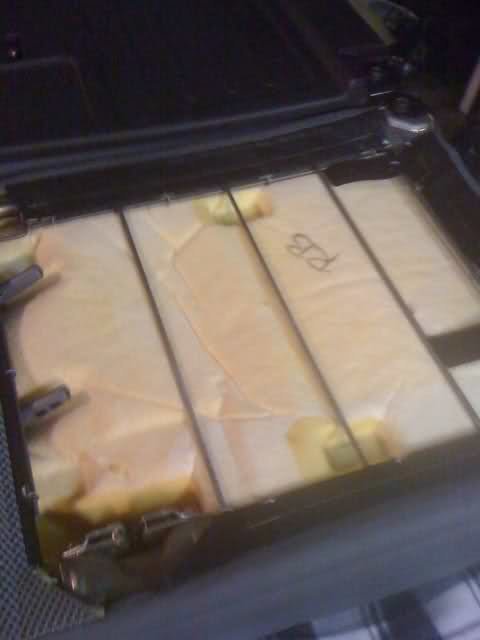

    Repeat the steps and take apart the stock fabric...

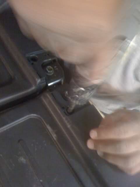

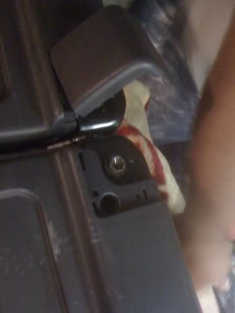

    You need to take apart the plastic back piece...pull the squared corners and with a socket wrench unscrew everything....
    heres what it should look like...break/snap off the stock hog rings...

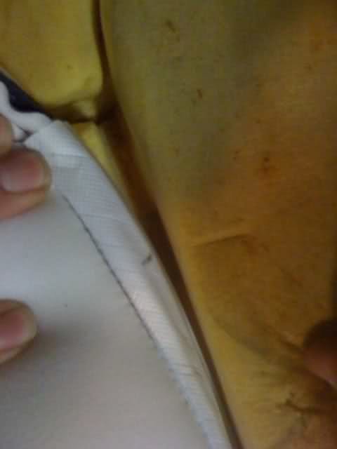

    Pull apart the stock fabric...
    Then you need to follow the steps from the other seat, turn the leather inside out, place it over and insert the plastic linning into the cracks then use your hog ring tool and attach the rings to the metal rod. after pull over the leather and just like the stock fabric add hog rings all around...

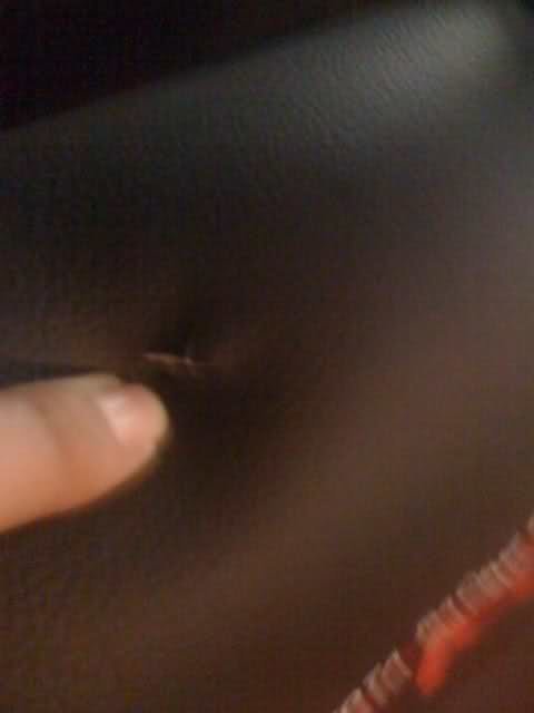

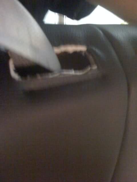

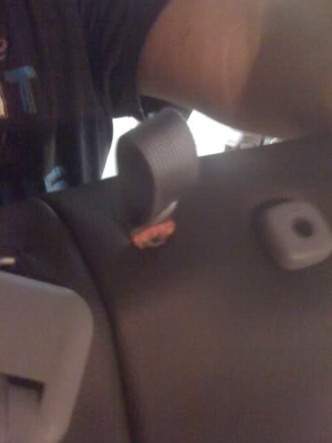

    the right side had a pre-cut hole for this strap but my left side didnt so i cut a small hole using a exacto knife or blade then pulled it out...
    cut another whole for the seat belt...

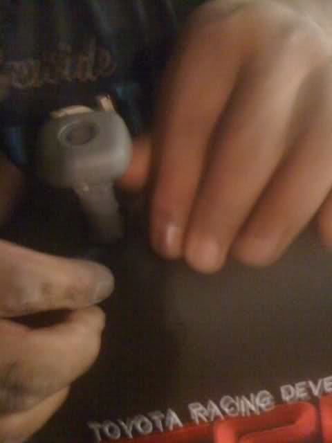

    In the begining i forgot to mention that you need to take apart the headrest POST by looking from the back, you simply pinch the side and push up.
    Here when the leather is now on...using your fingers feel on top for the "square shaped" hole. when your positive on where its at cut a small X in the middle.
    Insert the headrest post through the top of the hole, i guess the bigger the hole is the easier it might be but i was scared to cut to much...

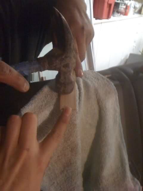

    It was a pain to fit it all the way down so i hammered it down

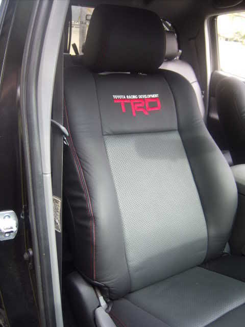

    i finished late so i didnt get to fix all the tiny imperfections but ill get to it soon, next ill be doing the front seats with seat warmers, head rest and my custom leather armrest!

    The front seats are already there.... the last pic

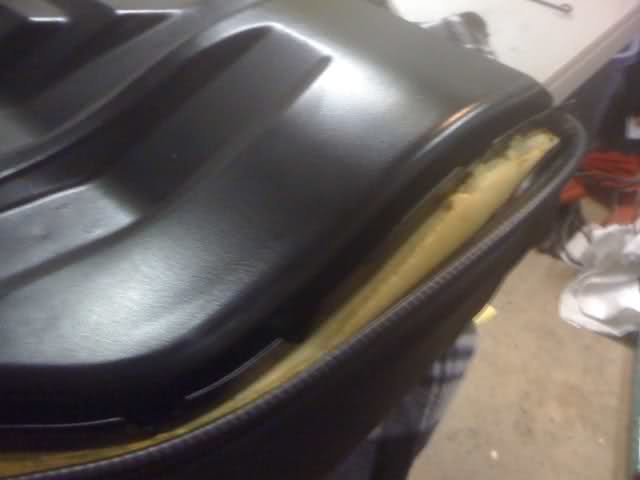

    If you hear creaking/rattling from the rear seats going over the bumps in the cold weather, check the rectangle hole that you cut and the plastic cover for the middle seat belt. The plastic parts rub against each other making the noise. Took me a long time to find where the noise came from. Didn't happen with cloth seats.
