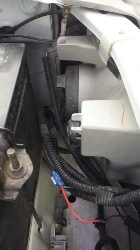

    I don't believe so. I have my "raptor lookalike lights" tapped into them. That way on the light controls near the stearing wheel they're off at the first position, on at the second and on at the third along with my head lights. I'll go take a picture of what wire i tapped into.

    I tapped into the parking lights not dtrl. Green wire that runs to the outermost top bulb. Then they would work just like I said with the head light controls
