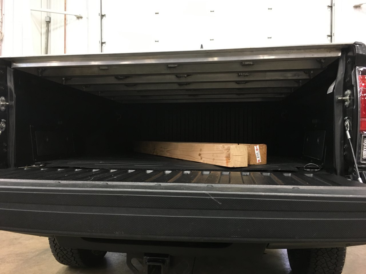

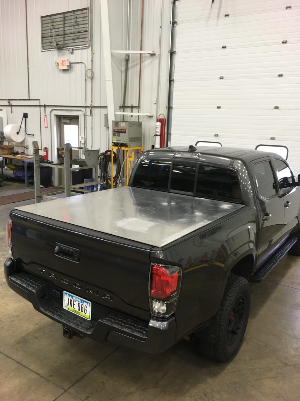

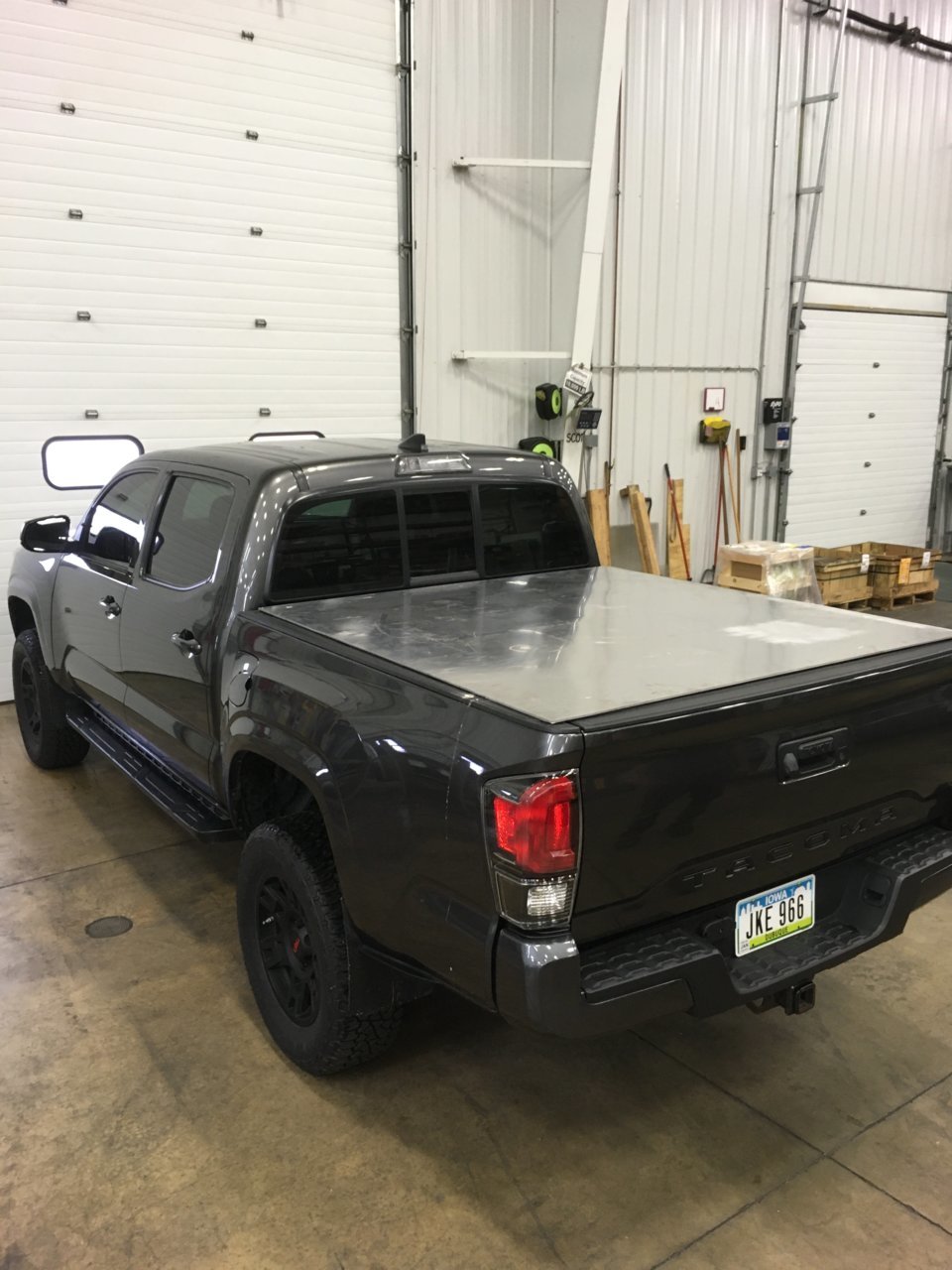

    I took the grinder to the edges of this cover to get rid of the high areas where we plug welded this thing together. After that we took it to a press to straighten it out. It bowed a bit due to the welding, which wasn’t really a surprise. After we got it straightened we threw it on the truck for the first time.

    My coworker and I (400ish pounds) were able to move around in the middle of this thing without it budging.

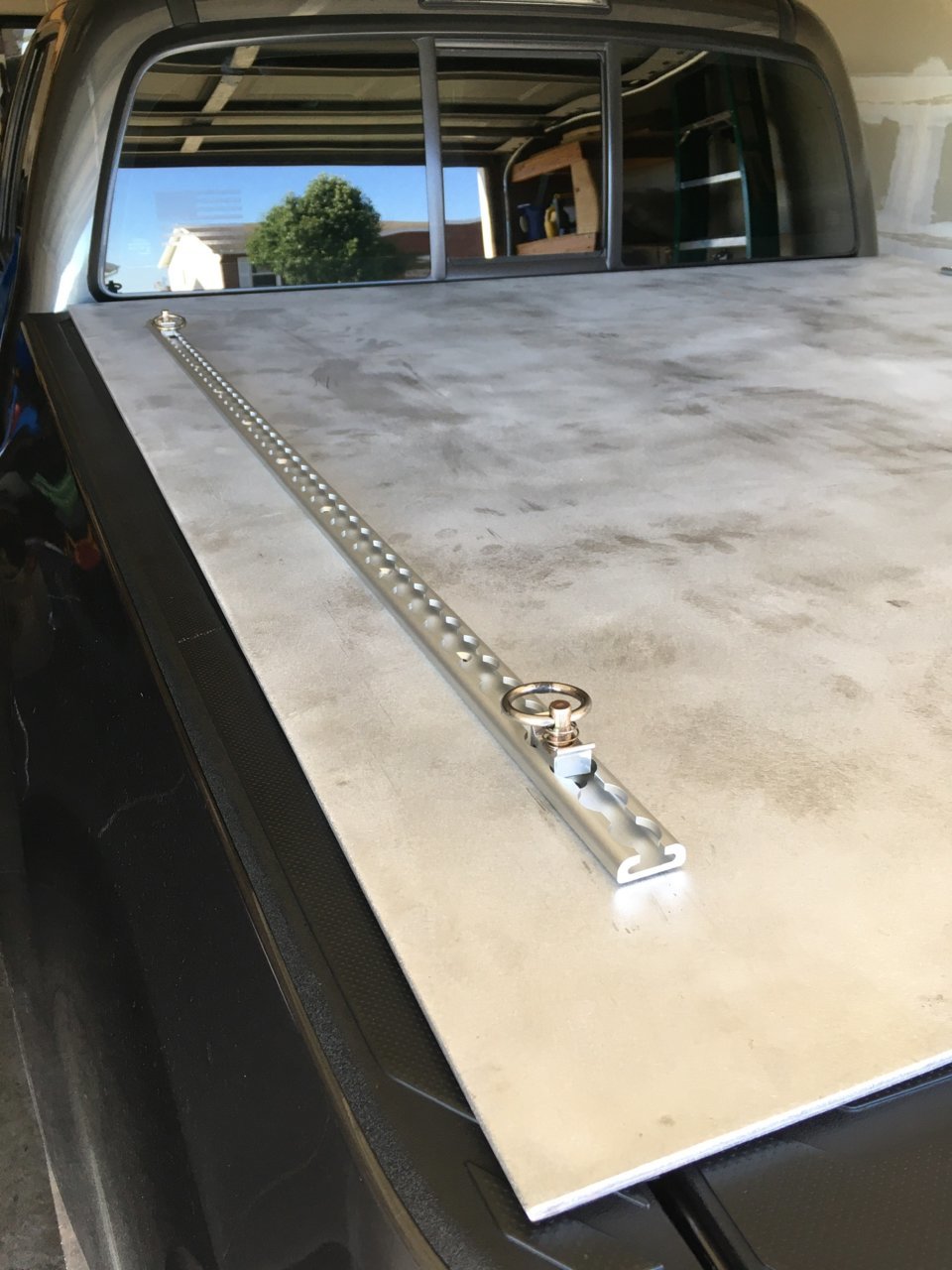

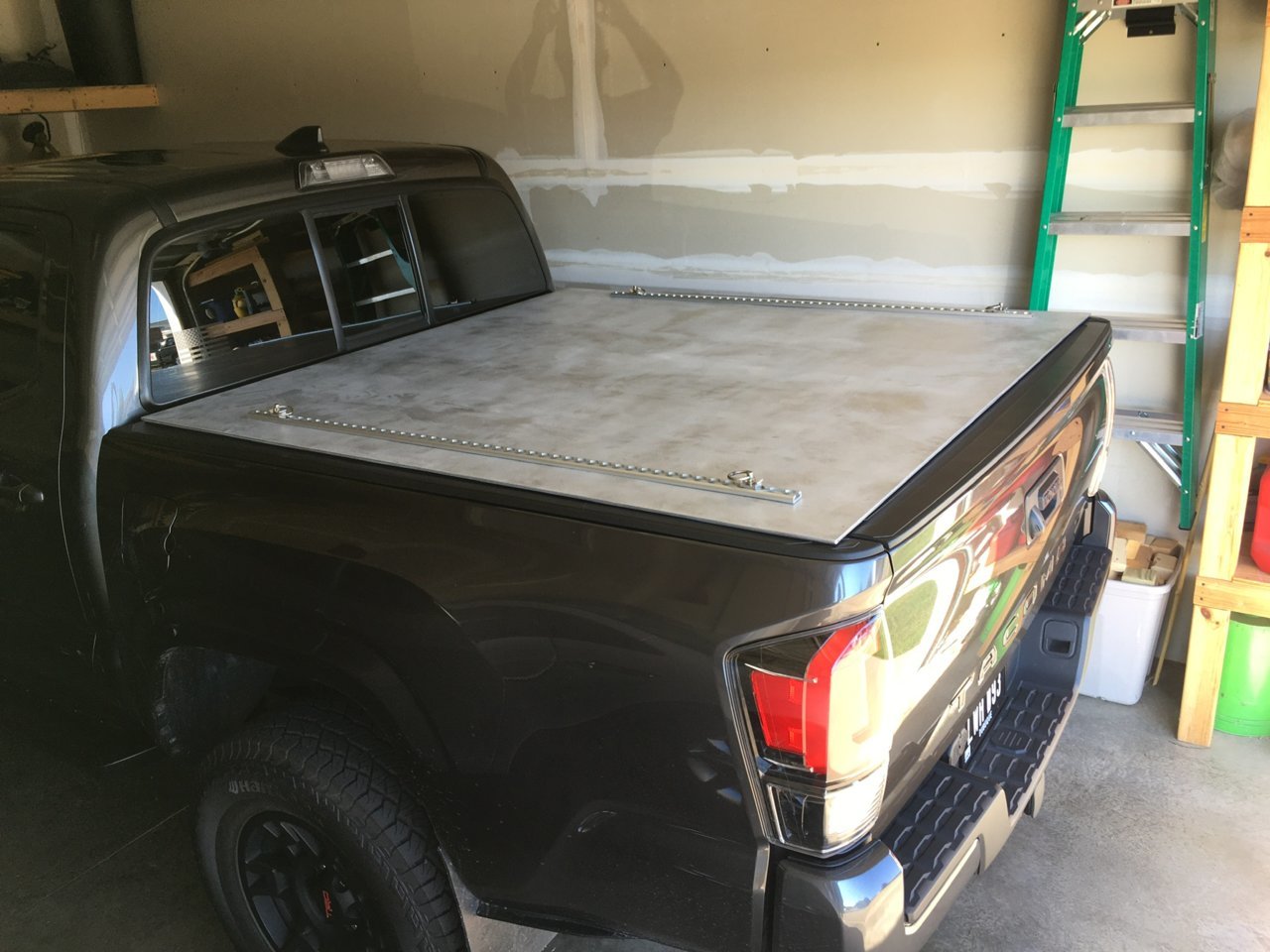

    2017 Tacoma SR DCSB
    Got two 48” pieces of L-Track delivered this week along with some Raptor bed liner. I will hopefully position the L-Track and drill/tap the mounting holes within the next week. 11526E9C-C715-41C4-98A5-7EA2964FDF44.jpg6336A84E-F3F6-4DF5-AC0A-251E79C8BF30.jpg 6C2CA701-8BE1-4799-BEA3-E7EB1D65DC96.jpg
