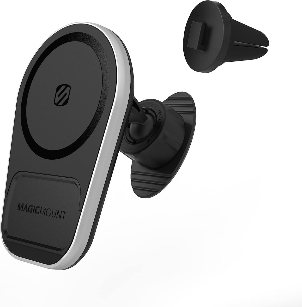

    I recently got a new iPhone 13 that has Magsafe wireless charging capabilities and wanted to get a new dash phone mount that had a built in charger. The mount I had was the Scosche Magicmount that I mounted above the airbag switch. The tape it came with kept coming off so I eventually super glued it on (I know it doesn't look pretty). Scosche makes a wireless mount that uses the same dash mount, and I considered buying it and unscrewing the existing magnet from the base and screwing in the wireless mount. But the wireless mount seemed too expensive at $60.
    Scosche MAGDMB MagicMount $13:
    Scosche MPQ5DV-XTSP MagicMount Pro $60:
    I did some research on making a DIY version for cheaper and found a video on YouTube of a guy who used 3M double sided tape to attach a wireless charger meant for your house to a car vent phone mount. So I followed his lead and purchased the TOZO W10 wireless charger for $20 and taped it to my existing Magic Mount. The charger doesn't have enough metal on the back to stay attached to the magnetic mount without the tape. Also this will only work if your phone case is also Magsafe / Qi charging compatible, or if you are one of the brave souls who don't have a phone case.
