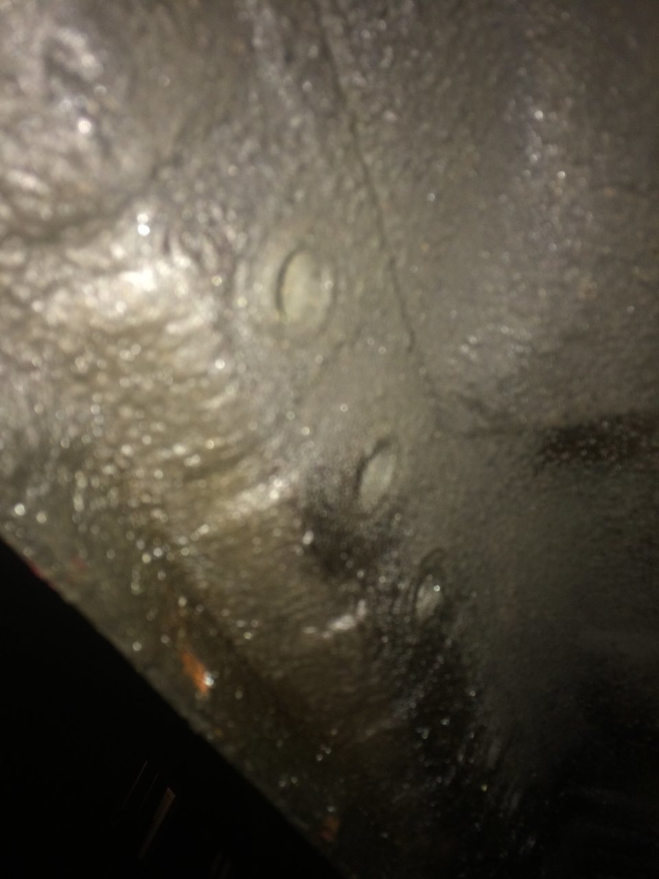

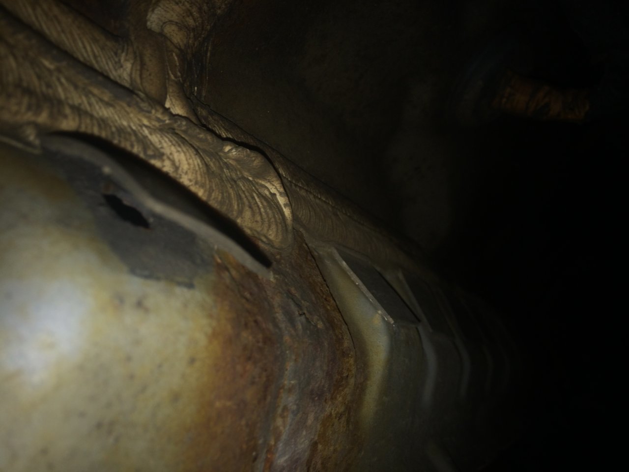

    From the factory toyota has a number of holes in the back of the rocker that are sealed with rubber, they come off and allow water in. My solution was to find the plugs they use to cap the hole they drill when rust checking. I had to use a step drill to open them up one size for this to work. Two different trucks my 02 and 04
