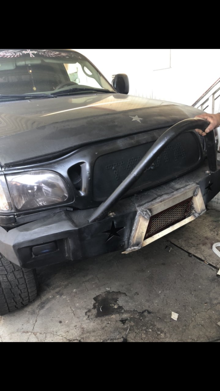

    Also seen those billet grills for the 01-04. How in the hell do you get in there to push the lever to pop the hood open

    Lol I open from the latch between above the grill between it and the hood

    The grill being blocked off like that seems like it would cause the engine temps to be higher than normal no? The little side openings aren't very big compared to the main grill which is where the fan pulls air from... looks good but I'd be worried about the lack of air flow

    I understand but the grill is full of little holes and so far no problems we are thinking of add holes actually

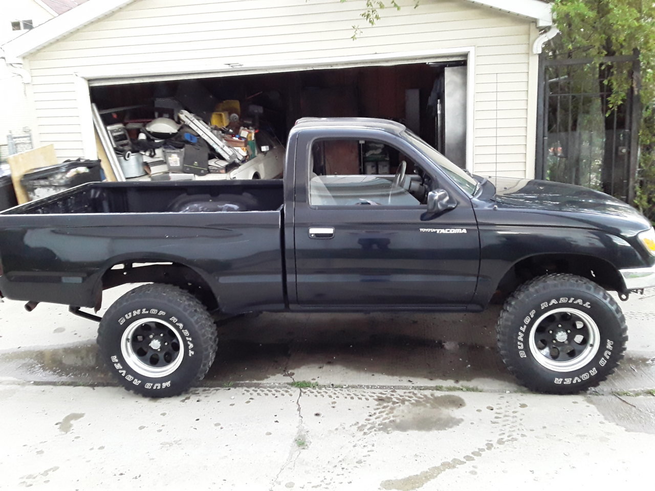

    Just bought this. Any one have any ideas to what i can do to increase horsepower?20200623_204810.jpg 20200623_204855.jpg 20200623_204810.jpg 20200623_204855.jpg

    Nice 5 lug. What size tires u got

    Where did you get the lift kit from I'm trying to raise 2003 Tacoma 2wd 5 lug

    U can buy the fabtech spindles for 3 inches in the front from Amazon or fatbobs. Then u can buy moog 81070 coils for an inch of lift for 4 cyl 5 lugs, and can stack the daystar spacer for an additional .75 to an inch from amazon as well

    Ok someone told to do 3 inch in the front and 2 inches I'm the rear my question would it look right.Is that what you use to raise your Tacoma.

    If u do just the spindle in the front and stock rear u will be level. If u do the moog coils and the spacer u will have just a small rear rake with stock rear. These 5 lugs take a bit to level
