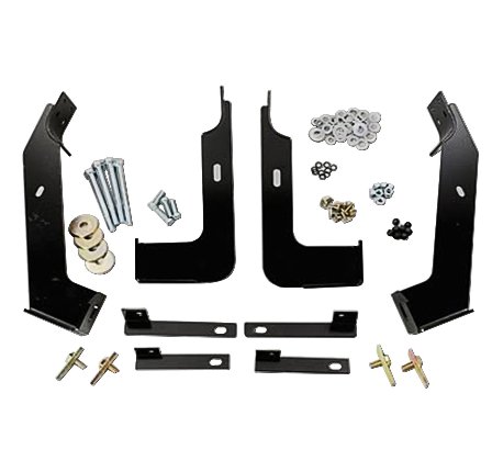

    It will not be expensive to have them welded together.
    You will need to buy mounting brackets.
    This Westin kit below sells for about $100 on Amazon.
    This seems the cheapest way to do it.
