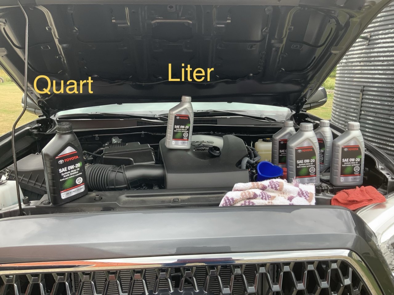

    Liters! I like it.
    I'm very ready to go metric. Way past time.
    Ah! Still, the oil on my dipstick is tan and not loaded up when I have checked it just prior to the ToyotaCare changes.

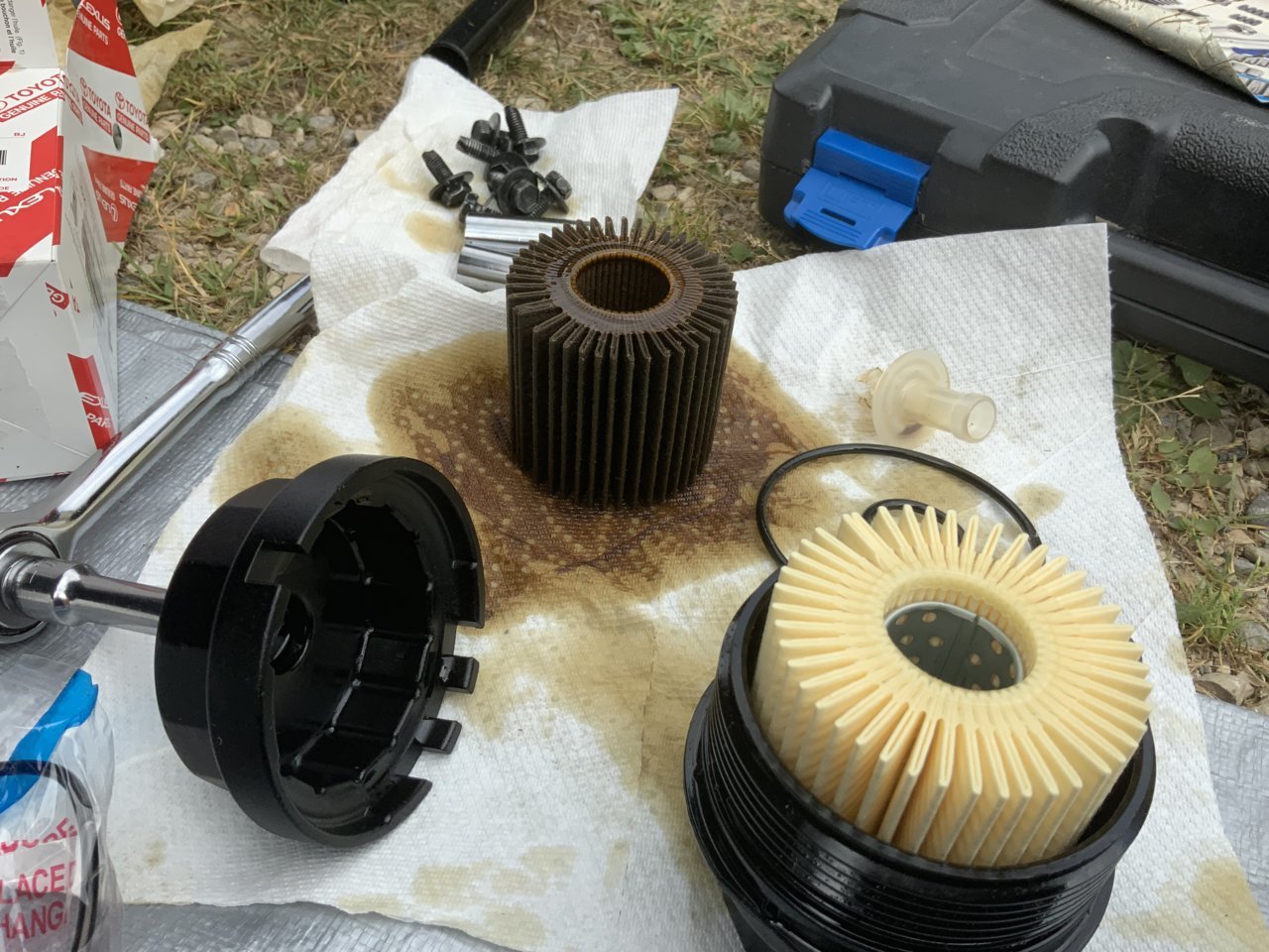

    Comparison of new vs used oil filter. First oil change. ~ 5000 miles.
