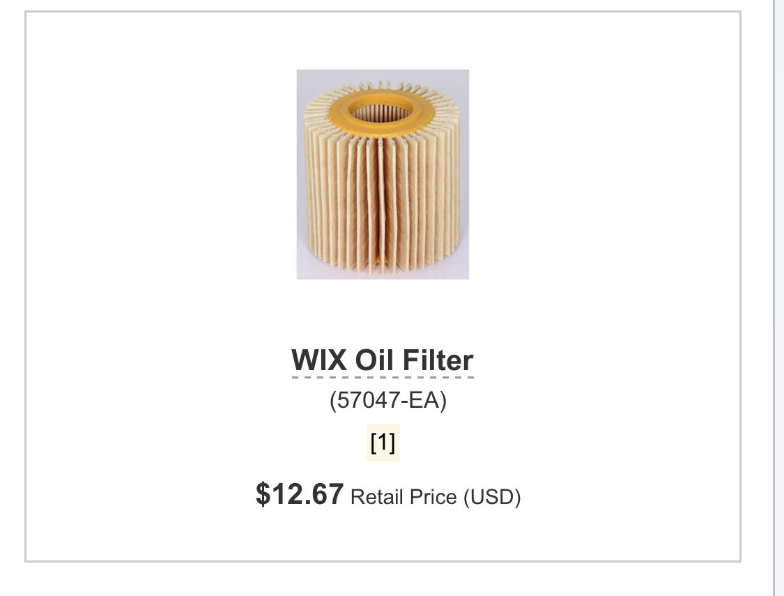

    Hello, I've been confused as to what kind of filter to get so I can change the oil on my 2018 Tacoma. When I look up oil filters on O'reilly I get a list of disposable filters that I can buy, but I was under the impression that the truck has a reusable oil filter housing with a drain plug and that you replace the cartridge inside.
    I recently moved and didn't have time to figure out how to do the change myself so I brought the truck to a Valvoline station where they installed a Valvoline VO25 filter. Does this mean I'll have to buy a reusable filter housing if I want to install an OEM cartridge? Is the OEM filter system better than disposable oil filters?
    My last question is Valvoline says to come back in 3k miles or 3 months for another oil change but Toyota recommends replacing the oil every 10k miles. Am I good just checking the levels and topping it off until I hit 10k miles? Thanks for any help!!!

    It is a cartridge style filter on the V6, just get it from a Toyota Dealer and the OCI is 10K.

    3rd gen 6 cyl Tacomas don't use spin on filters. Pick you poison from O-reilly's, your original cartridge style housing is still gonna be where it was before you made the mistake of pulling into a "Jiffy Lube"

    Shellshock
    Nov 21, 2015
    #170338
    23,427
    Iowa
    This is what’s used on the 3.5
