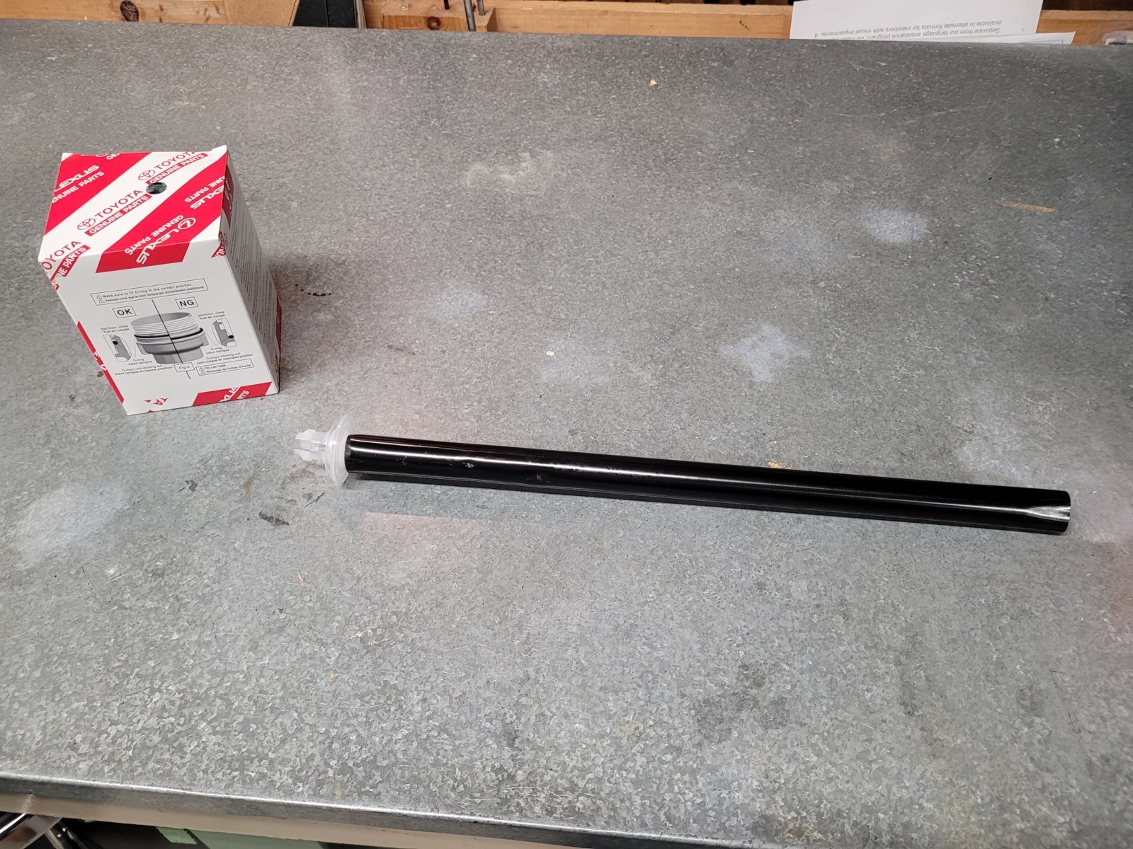

    I use a piece of scrap metal tubing and the plastic gizmo (that comes with the filter kit) to cleanly drain the filter housing into my drain pan. Works like a boss! 20240412_121511.jpg

    Making less of a mess is more important to me than the time to do the OC. So, I use the drain tool shown above and replace all o-rings. You don't need to replace O-rings everytime - I get that.
