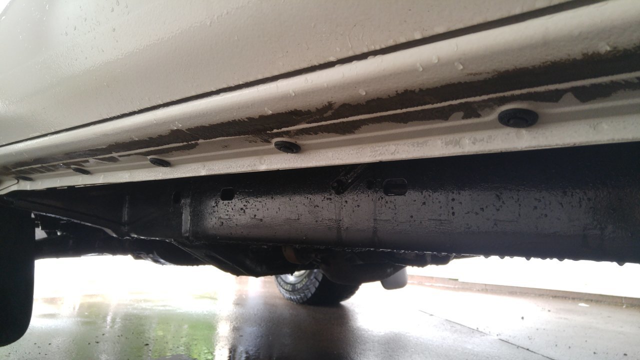

    Was looking a few weeks back for a thread and found one but the photos had since been taken down. Did it myself today and thought I would spread some knowledge.
    Difficulty: Beginner
    Time: 4 hours (incl prep)
    Cost: 8.95 Can of Paint + 9.56 2 Inch painters tape = 20 bucks

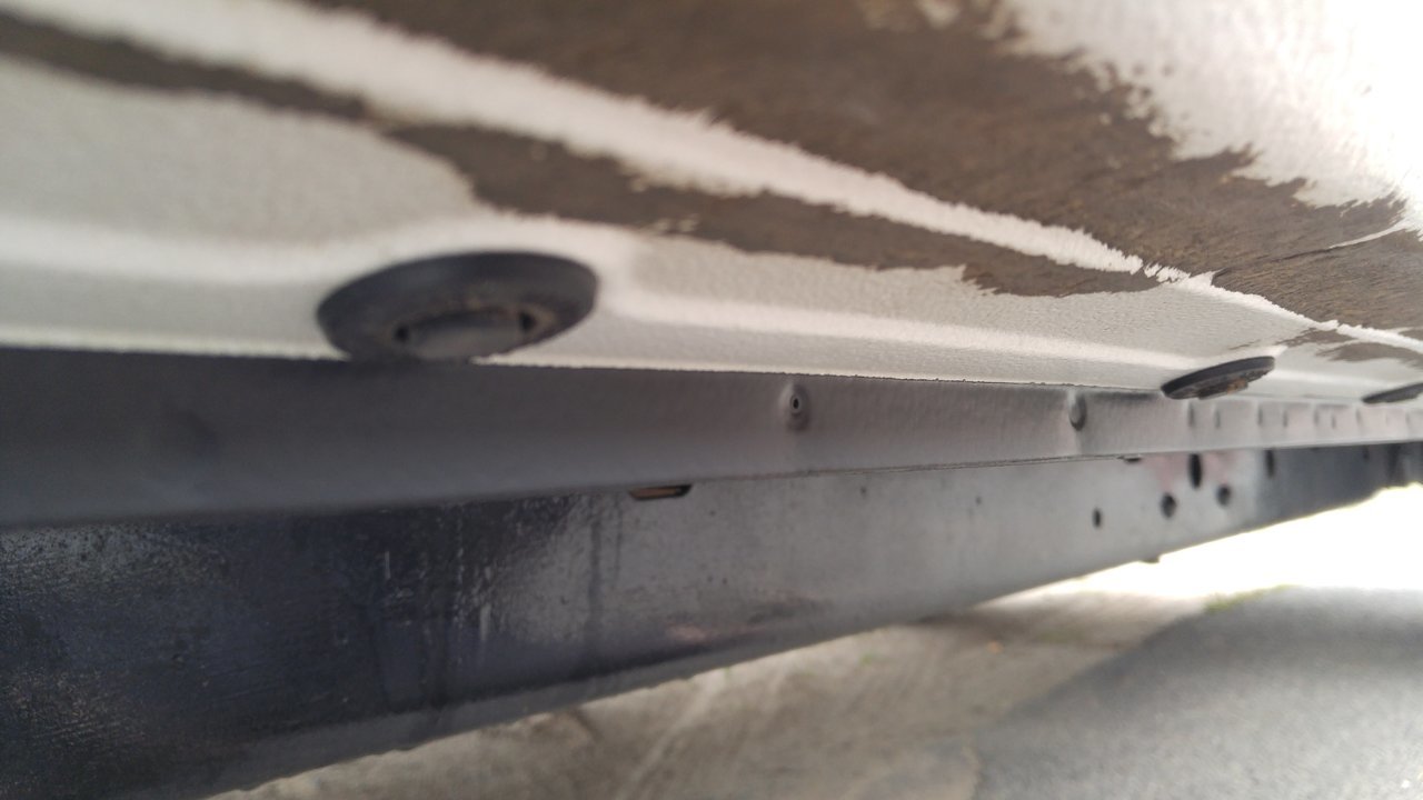

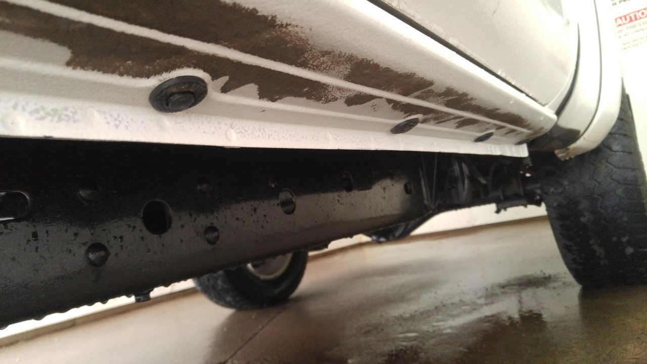

    Start off by blasting any crud off. For me it would be years of undercoating
    lightly sanded with 150 grit, just enough to scuff up the surface
    removed the plugs for better tape adhesion. press in the middle to remove/place it

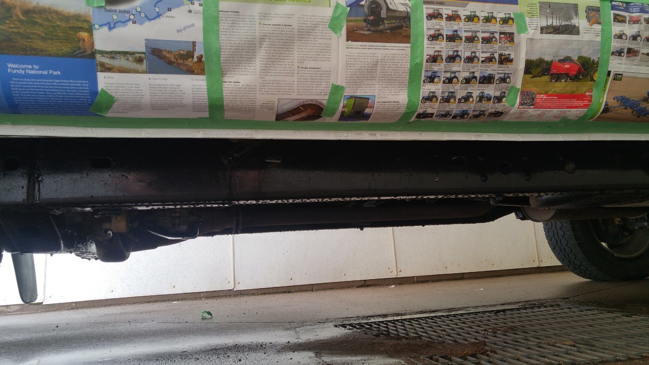

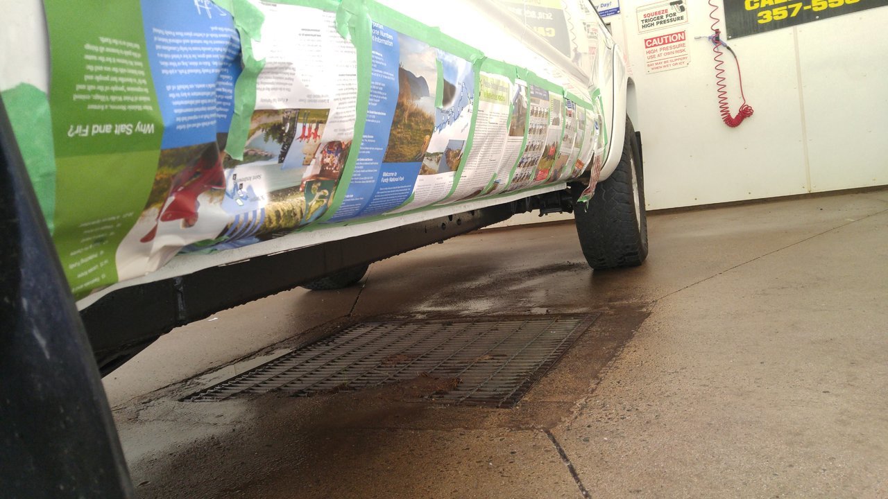

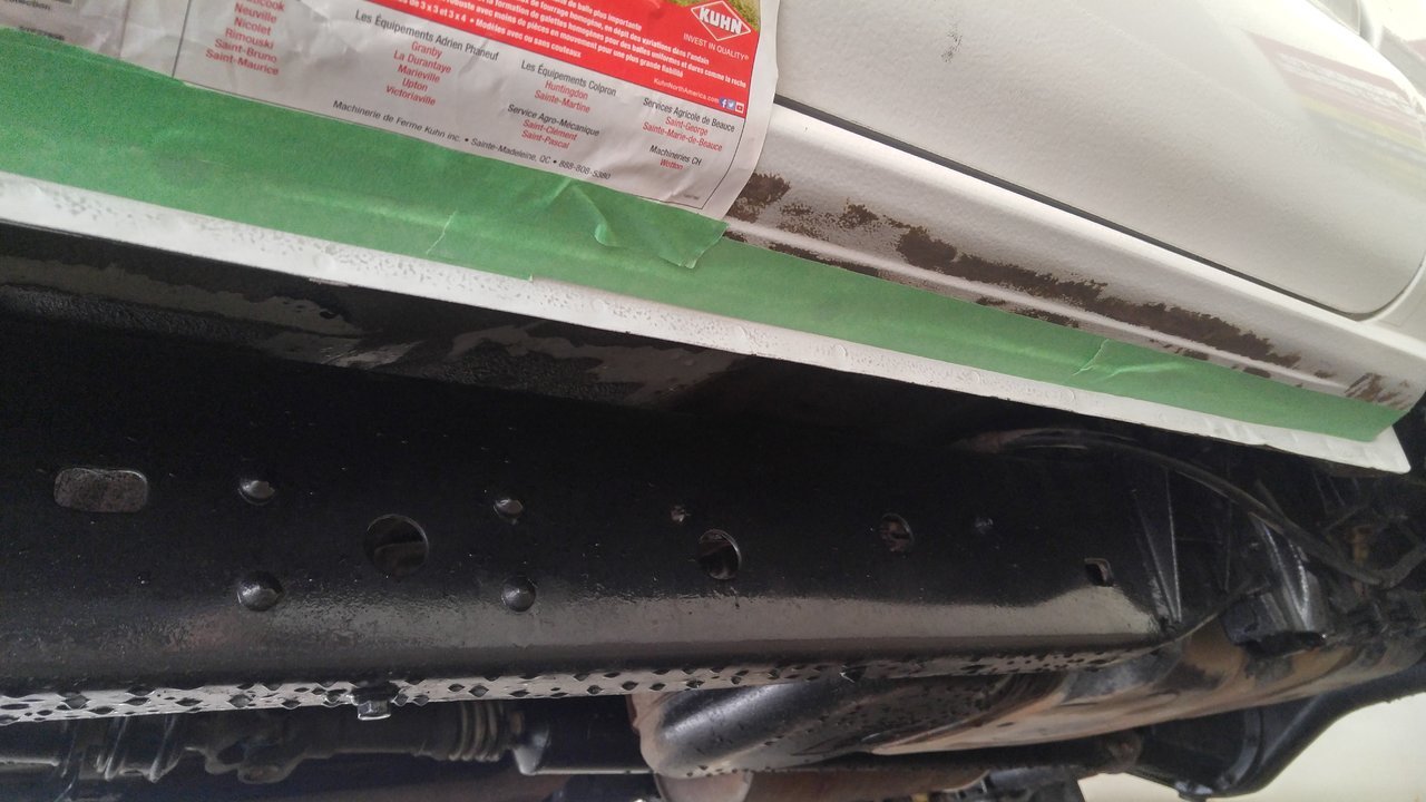

    used 2" tape strip to get the area i wanted to paint blocked off. Then placed my newspaper over it
    went full retard on the taping job, didnt want to take any chances with over spray
    all tapped up and ready to go

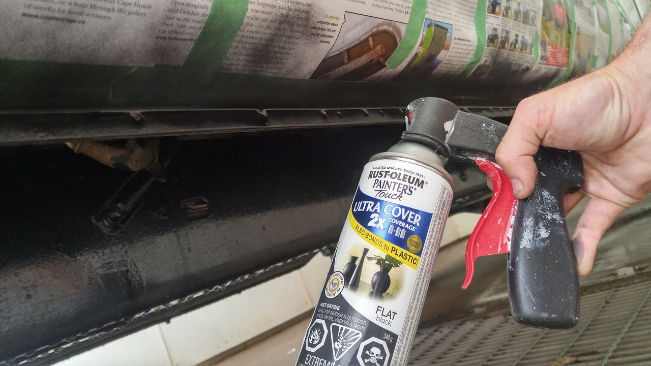

    I used a sweeping motion left and right and made sure i hit a high angle to get the corner of the pinch. Used Rust-oleum because of our winters here in Canada, didnt want to risk rust. that little spray nozzle adapter is a God-send.

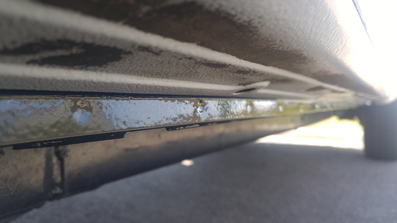

    I applied four coats. Two coats allowed a 5 minute dry time of one another and then an hour wait, before applying two more (as per cans directions). Flat black while drying.
    Flat black after 1 hour of drying. At this point I have not applied a clear coat to it.
