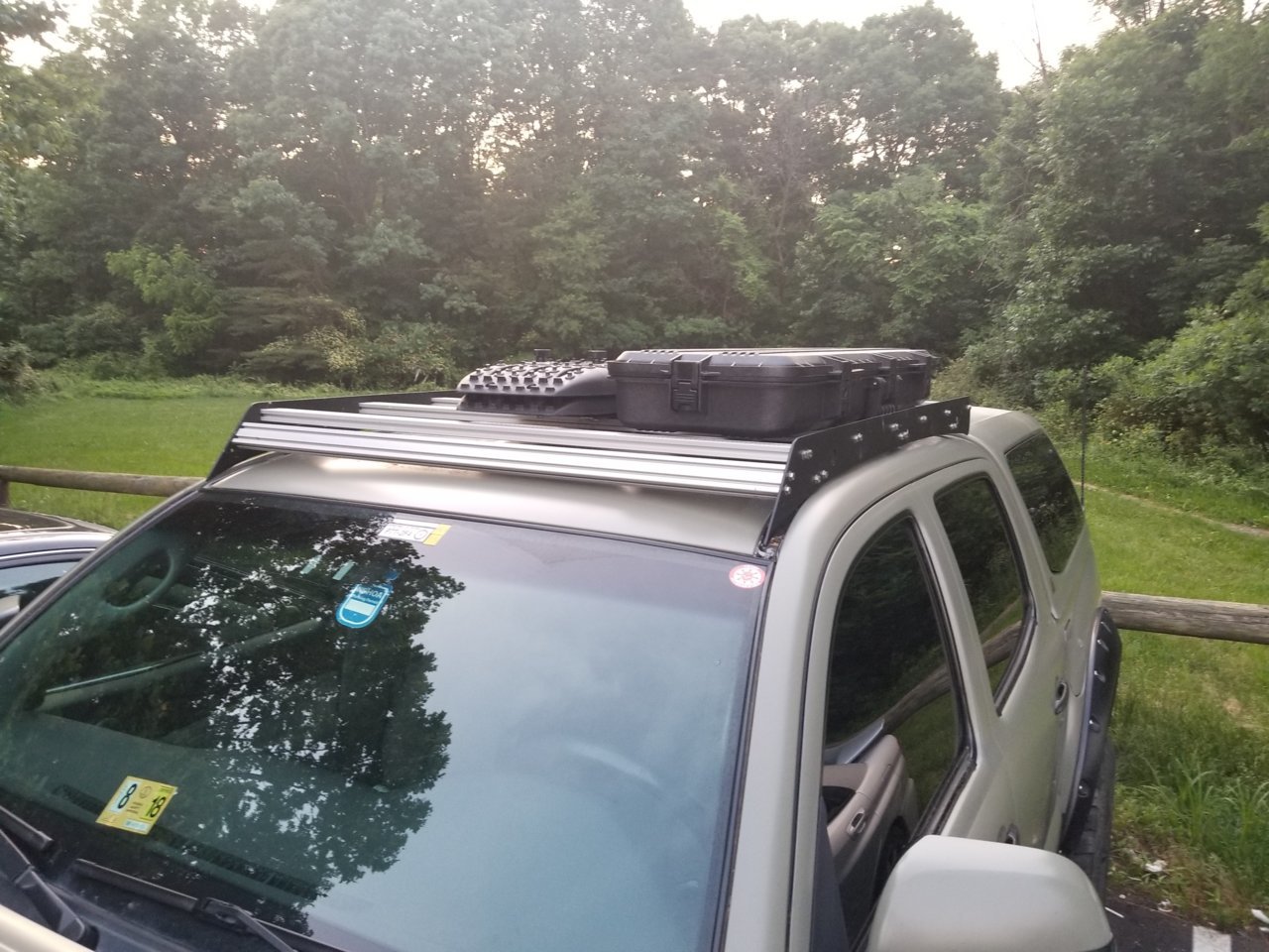

    Installed!
    It was getting dark and it's black is we don't see the details much.
    Learned a few things and seriously the mounting feet are quite long to install/align. In my case there was a significant difference in height between the middle and the front/back so whatever I design needs to be easily adjustable for height.
    Also, I really need M6 carriage bolts because two of the drop ins fell.down and inserting then upside down was a PITA.

    I forgot my tape measure on the roof.

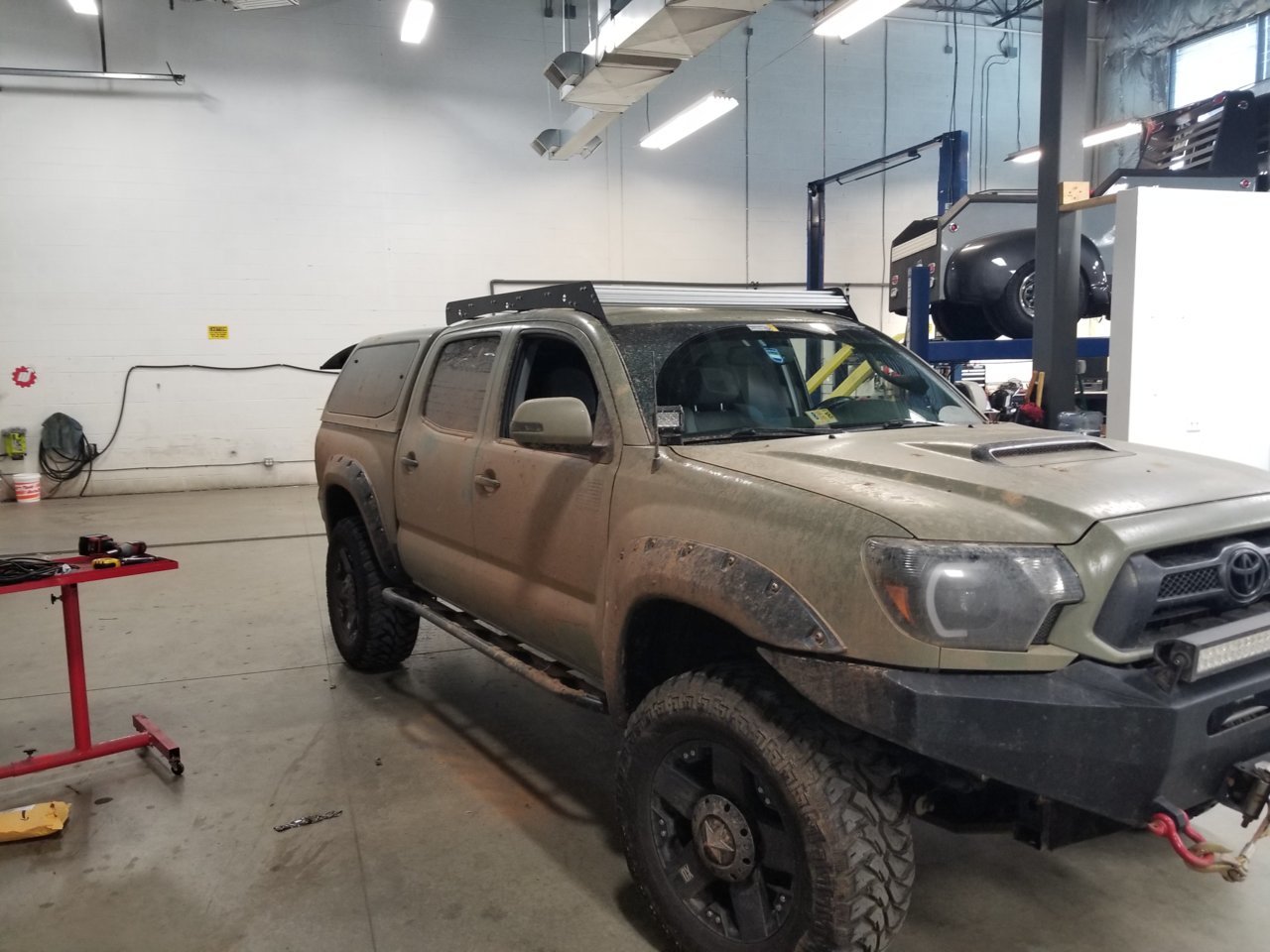

    Jeremy
    2012 DCSB TRD OR
    Just got my rack finished up. Basically the same as the OPs, but I am happy with it. I probably should have gone a bit higher with my mounts (used 1 1/4" square steel) because it isn't taller than the shark fin antenna. The awning fits nicely on it though.
