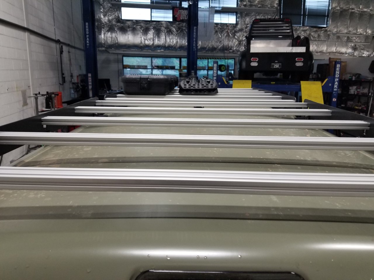

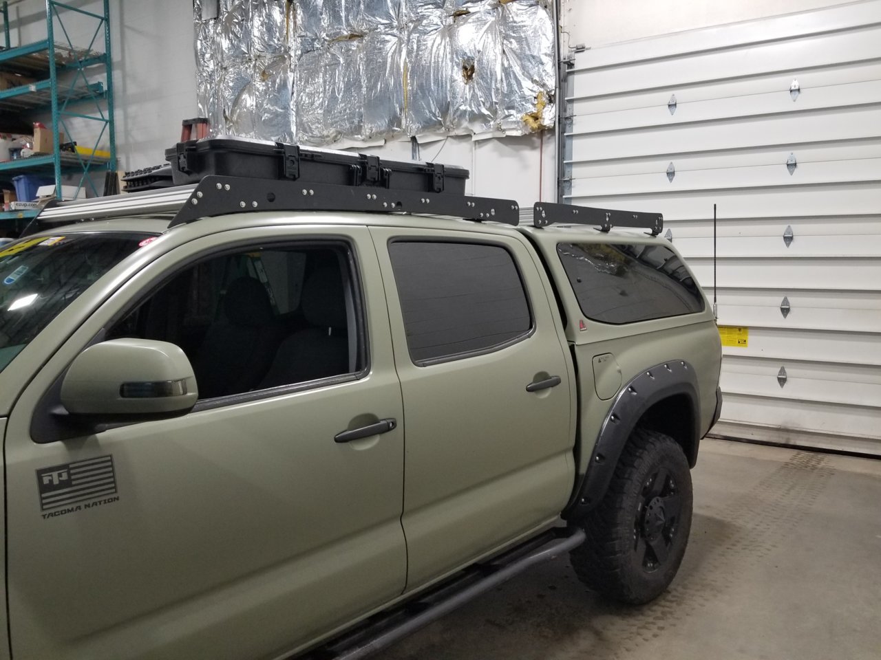

    So here's the "almost final" design for the short bed (53" length). I have made it so you can easily configure equally spaced 6 bars or 7 bars.
    I also have made it so that you can position vertical end bars and horizontal ones.
    Any feedback welcome

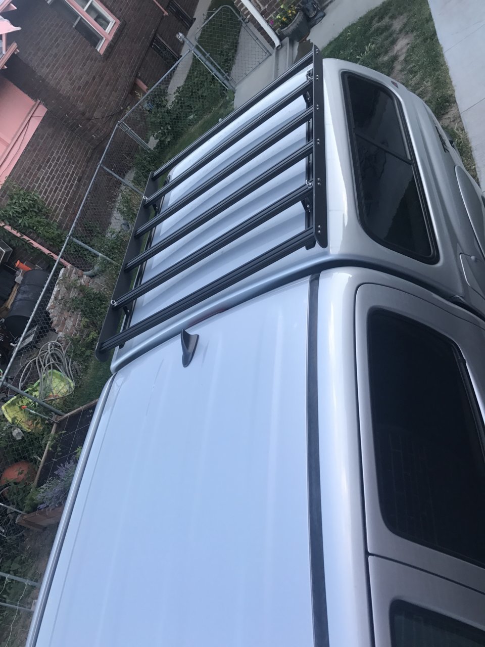

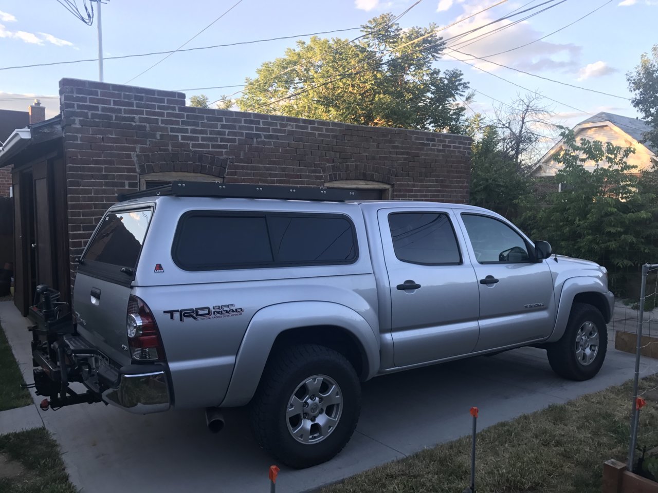

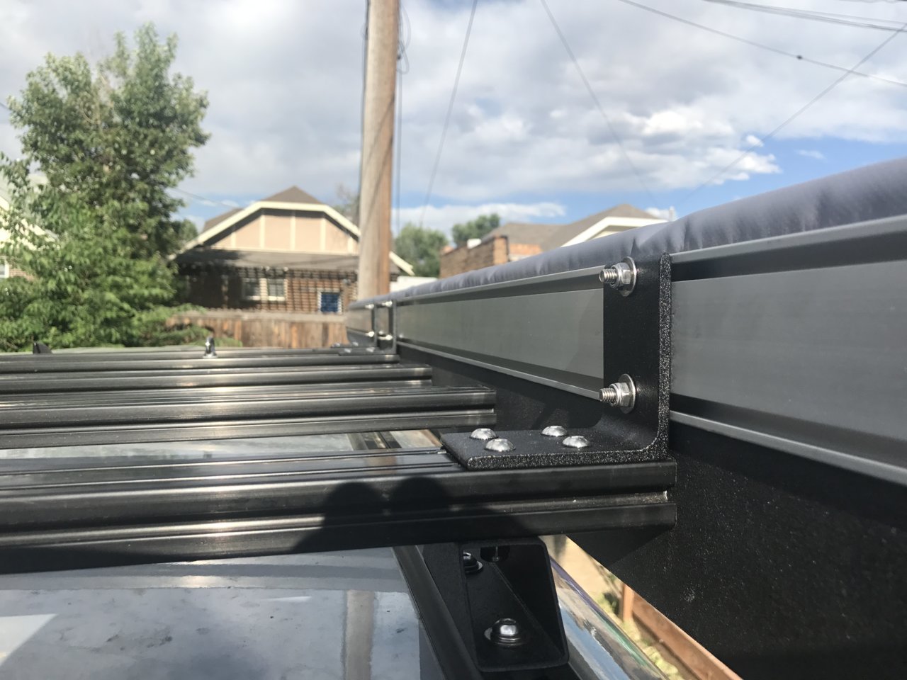

    Thanks for the pics. They help. The pictures of the smittybilt on Amazon don't do it justice. They look really flimsy there, but these pics make them look usable.
    I need to take some measurements and see what I am going to put together. I expect I will be using between 3-4 cross bars as opposed to the 6-7 on most other builds. I am pretty sure I will be able to get the rack to be low enough to be below my regular cross bars so when travelling with kayaks, everything will still tie down appropriately.
    The only thing I am still struggling with is how to attach the carriage bolt or nut to the plate that will keep the rack attached to the rail (the only picture I left from your post).
