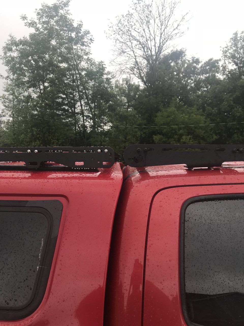

    Alright time to make a cab rack because this doesn’t line up with my prinsu and the mismatch on powder coat is bugging my OCD.

    Pic of lining up issue?

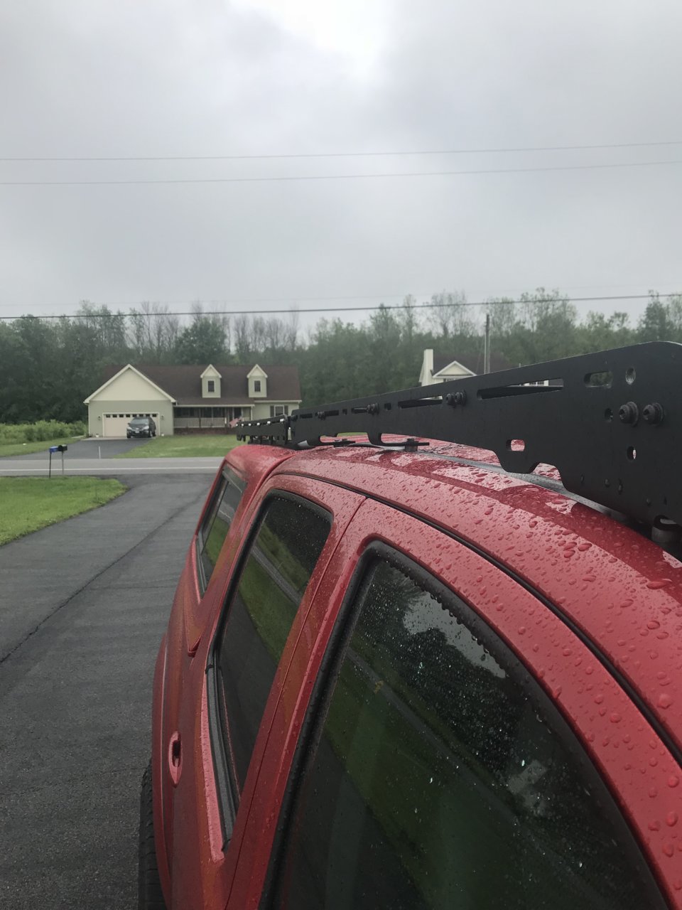

    Can’t right now, too dark. It’s not @BeachBoy fault, I used the Prinsu mounting feet and have it adjusted as far over as I can and it’s still off from the cab rack, also about ~1/8” off on height. I may have to trim the Prinsu mounting feet to get it to shift over because my Cabrac is dead center and I don’t wanna move that around.

    Show pics, off in what direction?

    EAB291AD-A172-4DAF-B5A6-6C42C2F1B908.jpg 77DA509E-75BF-4C8D-ADDF-1961BC57708E.jpg
    Hard to tell but first picture shows the height difference and second shows it’s off side to side. Again this is just because of where my tracks are mounted and also the mounts I used to install it. I never expected it to just perfectly line up with the Prinsu.

    Or raise the BeachBoy rack up by 1/8” using spacers at the crossbar to railmount interface.

    That’s the plan for the height difference.

    So the issue with the height difference is because on the prinsu there is about a 1/4” lip above the crossbar, on @BeachBoy its maybe 1/16” or so. I didn’t measure but it’s a very small lip, and if it matched the prinsu then it would line up. As far as the lining up when looking straight on, that’s because of the difference in the thickness of the side plates.
