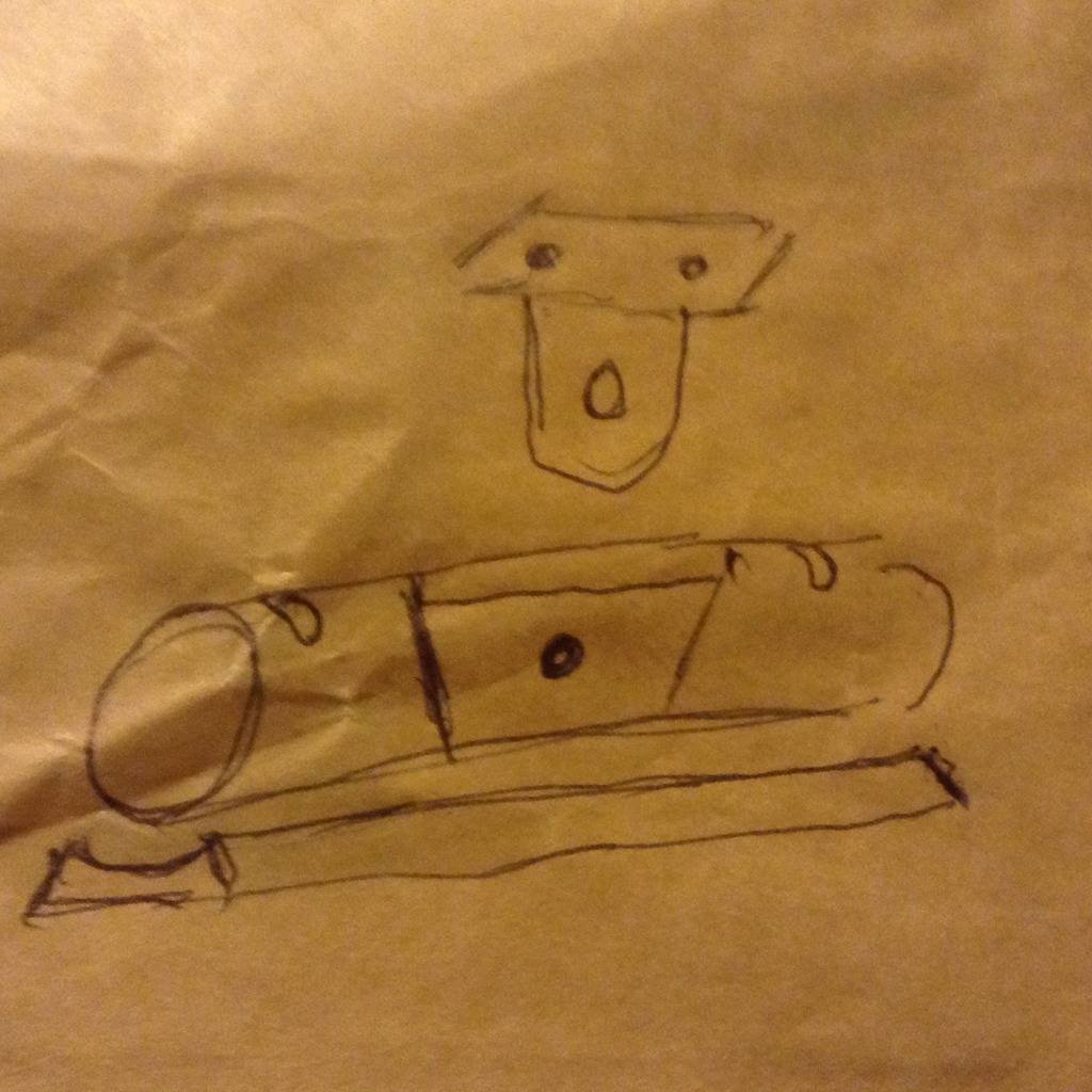

  18. Jul 19, 2018 at 1:50 AM
    #498
    bagleboy
    bagleboy Well-Known Member
    Aug 5, 2017
    #226018
    7,218
    Scott
    Norcal, Santa Rosa
    2014 5-lug AC 2.7L VVTI
    Snug top Rebel, Thule tracks, ditch tracks, Bagged rear suspension, F/R anytime camera, intermittent wiper switch...
    Something like this could work. Top piece attaches to rack bars. Round bar is slotted in the middle to accept the top piece and allow it to pivot fore and aft. It also has the holes for the track v-shaped to allow the round bar to roll in the cradle as the roof tilts.
    4568F1C4-5BC4-4F2B-B363-A7270DF80D05_zps_5b75308dda8cd833be3d0cbcd04f963451ef8d46.jpg
    Kuntrykid likes this.

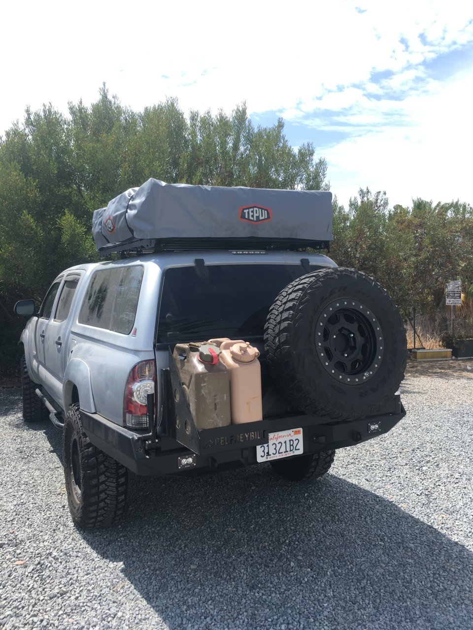

    JACOB
    Still in PNW but moved to Boise.
    Black pinstriped 2014 DCSB 4x4
    IT NEVER ENDS..........
    Which tepui is that and what length are your cross bars?

    Doesn’t help with height difference of the rails from front to back.
