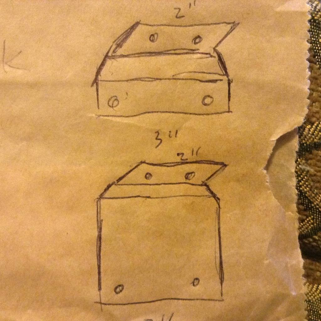

    Lap a tab from the bottom with the tab from the top. You could put the pivot there istead of in the cylinder. Or do the butt hinge idea with a tab from above with two holes, one of the them slotted with a curve. Put the slotted hole on the hinge and two sets of holes in the top plate, one for the back and one for the front. Or do dedicated front/back top plates. Since the double cab ditch tracks curve in two dimensions, one of the lower hinge plate holes would also need to be slotted. It shouldn't because too hard to adapt a single hinge design to work on all four corners.

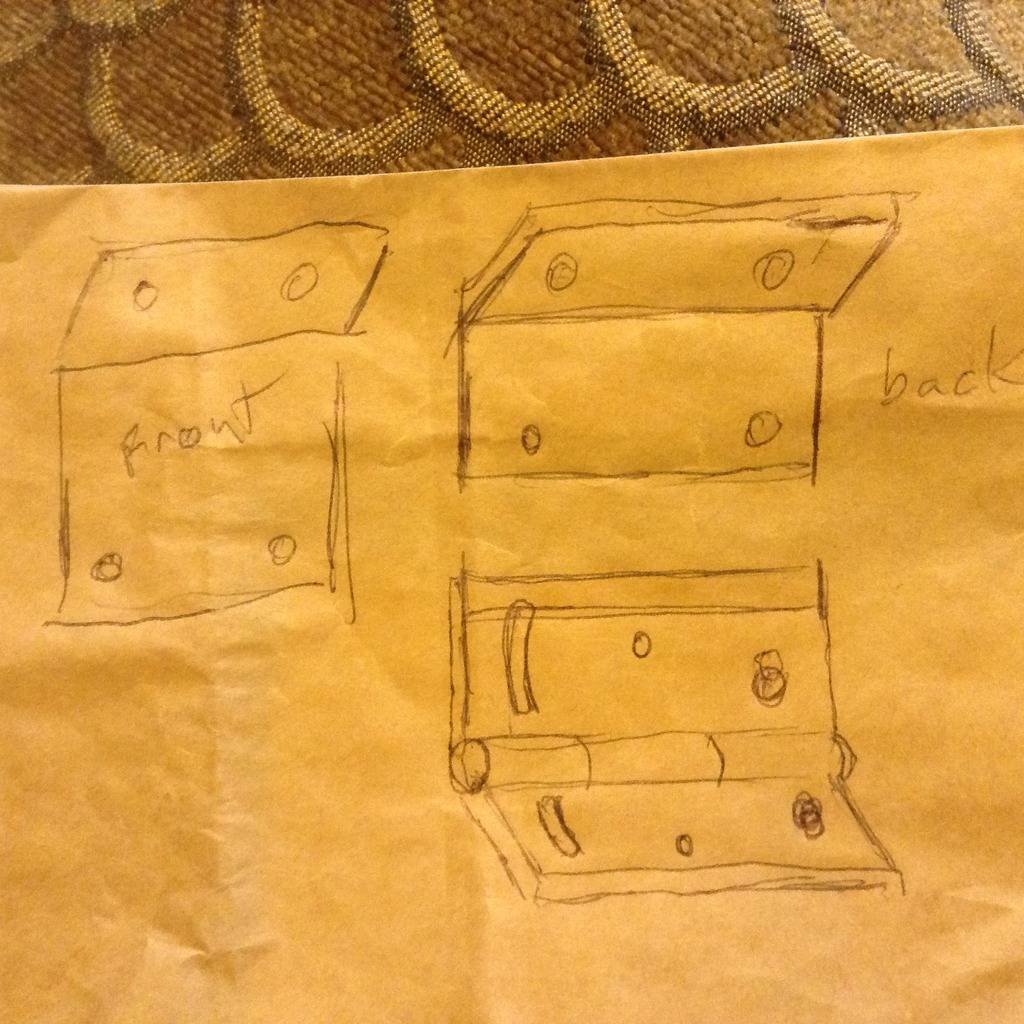

    Maybe like this.
    883A1AEB-617A-49D6-9C6E-4524C3AF10EF_zps_12bc744a344ab774c6b539dbaef837897d296512.jpg
    The top pieces can be cut from sections of 3"(maybe 4") angle and the bottoms modified from 3" butt hinges. The longer fronts would be side specific. Oh, also taper the top pieces down to 2" to match the slotted bars. Like this. Maybe less waste if you used smaller angle stock for the rear top pieces.

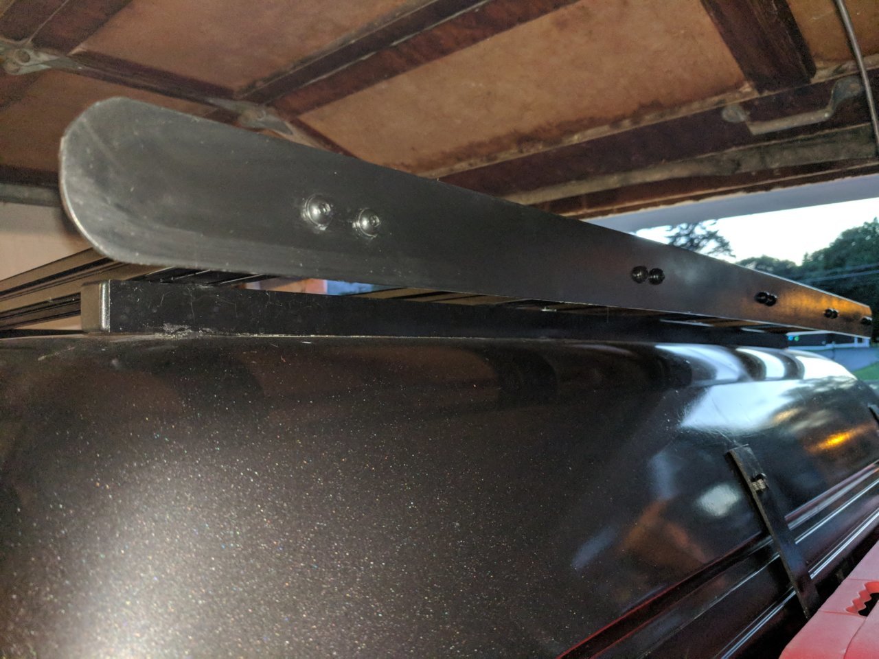

    Awesome man thanks! Those are what I'm looking at getting for the truck and T4R. How is the weight up there and deflection? Any issues with roll off camber? Also debating a trailer build for the RTT so we can park and explore.
