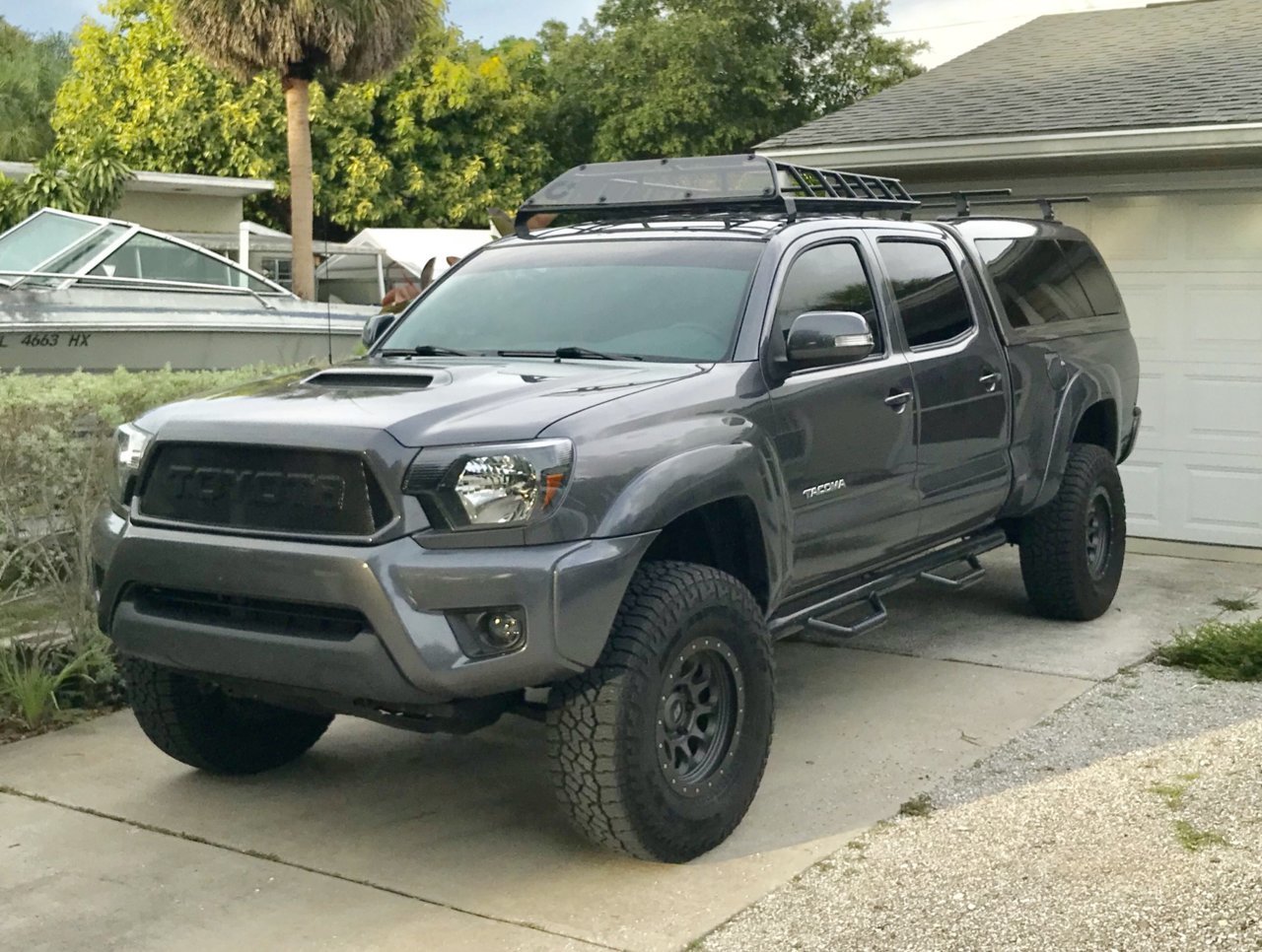

    Ok thanks for the info! I just installed a rack that was custom built for another member, and I bought 3rd hand. It’s been in my garage forever, but I finally got it mounted. I love it but it is quite noisy. Maybe I will just do Prinsu up front as well?
    Has anyone ever done sound dampening in their headliners?
    Sub_Par[QUOTED] likes this.

    Snug top Rebel, Thule tracks, ditch tracks, Bagged rear suspension, F/R anytime camera, intermittent wiper switch...
    Yes, there's even a thread on removing the head liner and sound deadening. You need to close the gap between the roof and the deflector.
    Linkhttps://www.tacomaworld.com/threads/removing-your-headliner-and-insulating-sound-deadening.394469/

    Nice looking truck.
    T@com@Steve[QUOTED] likes this.
