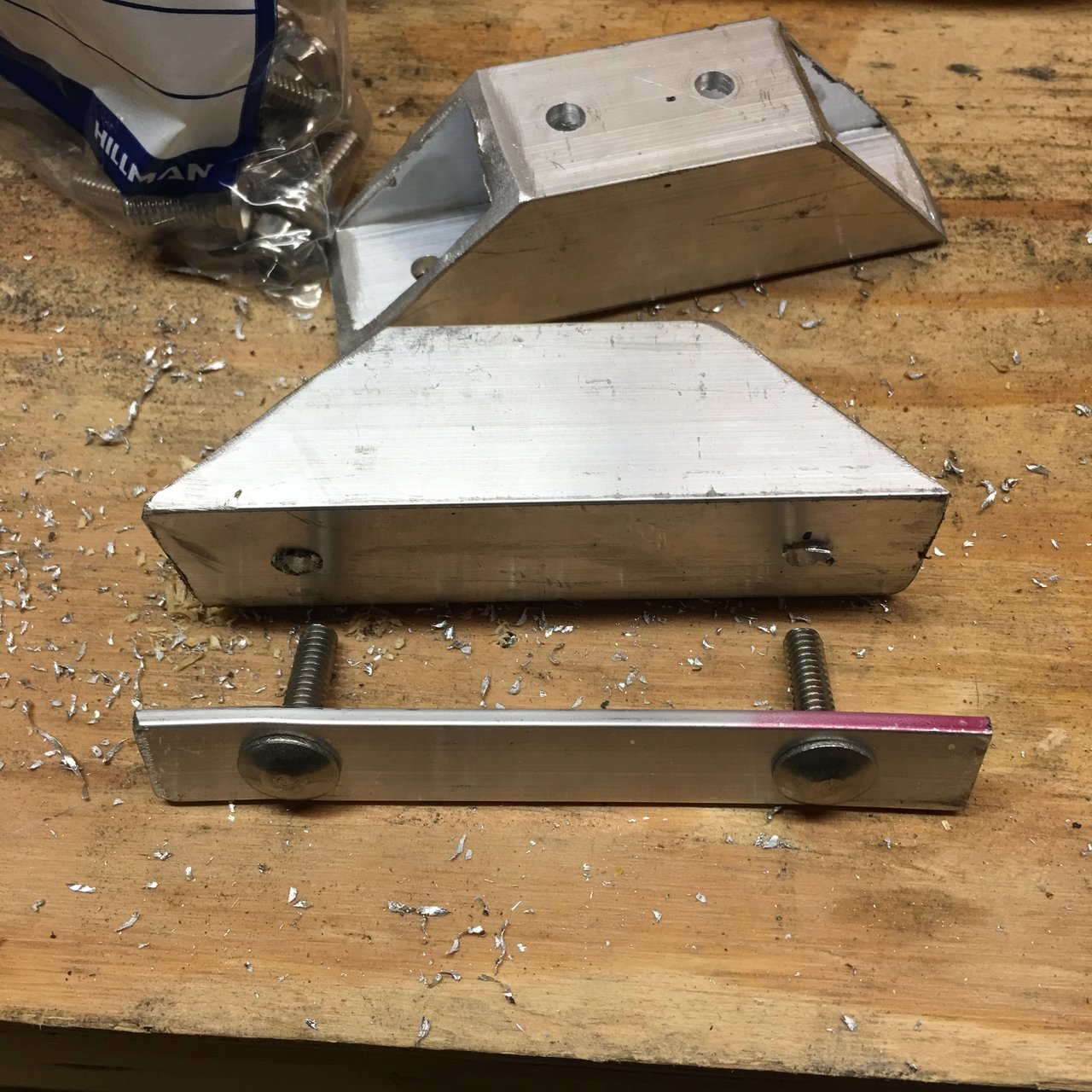

    On your canopy, where did you get that mounting bracket. The one that your rack mounts to? Nice canopy rack BTW. Its the silver bracket on top of the canopy.

    Do you happen to know how long you made the side pieces?

    i would have to go measure, but i made them just a bit shorter then the length of my shell.

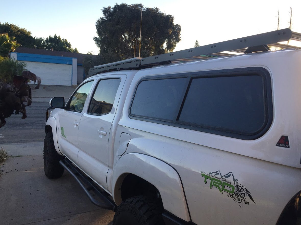

    Currently have just the OEM roof rack. Really want to do this for my shell do you think it will create much wind noise since I don’t have the cab rack in front of it?

    Have a question for you. What kind of weight do you think you can put up there? Do you notice any flexing due to weight or while ratchet strapping things down?

    any rack will make noise. just depends on how good your ears are lol
    i have my RTT on it, and no flexing at all. I did add a internal bracing to the shell as i like to go fast off road and having the RTT up there doesnt help

    yea, i have this now, but planning on doing it again but with 1.75 tubing with a x to give more side to side support
    edit, i dont have any pictures lol, will take some

    OP- how thick are those side pieces of yours? Quarter inch?

    yes 1/4"

    Well this turned out great, thanks @paranoid56 !! I ended up using 1.25" square tube for the feet since the I have the Thule tracks on my shell.

    Is that steel or aluminum square tube?

    Aluminum. Everything is Aluminum except the hardware, that's SS.
