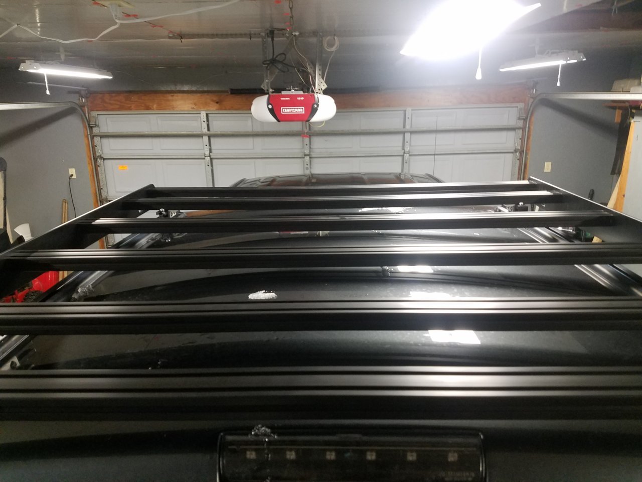

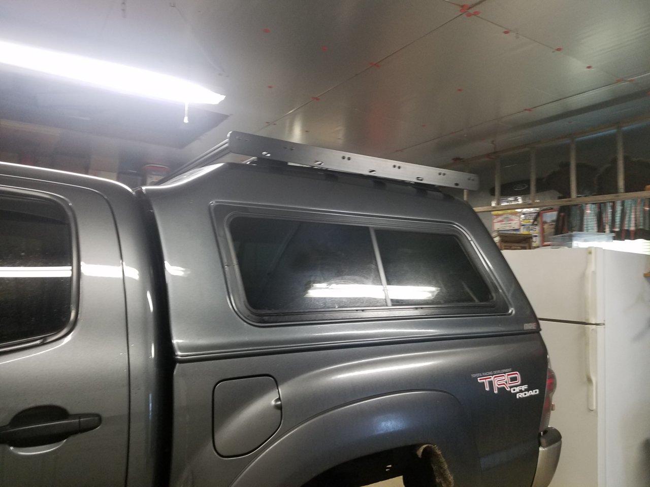

    Here's mine. Just some 1/4" aluminum cut and shaped with holes drilled in it and some 80/20 extrusions. Recently had them powder coated.
    Rebirtha, Cp_3oh, ready6delta and 3 others like this.

    My roof rack screws are hellaflush. :D
    ready6delta likes this.

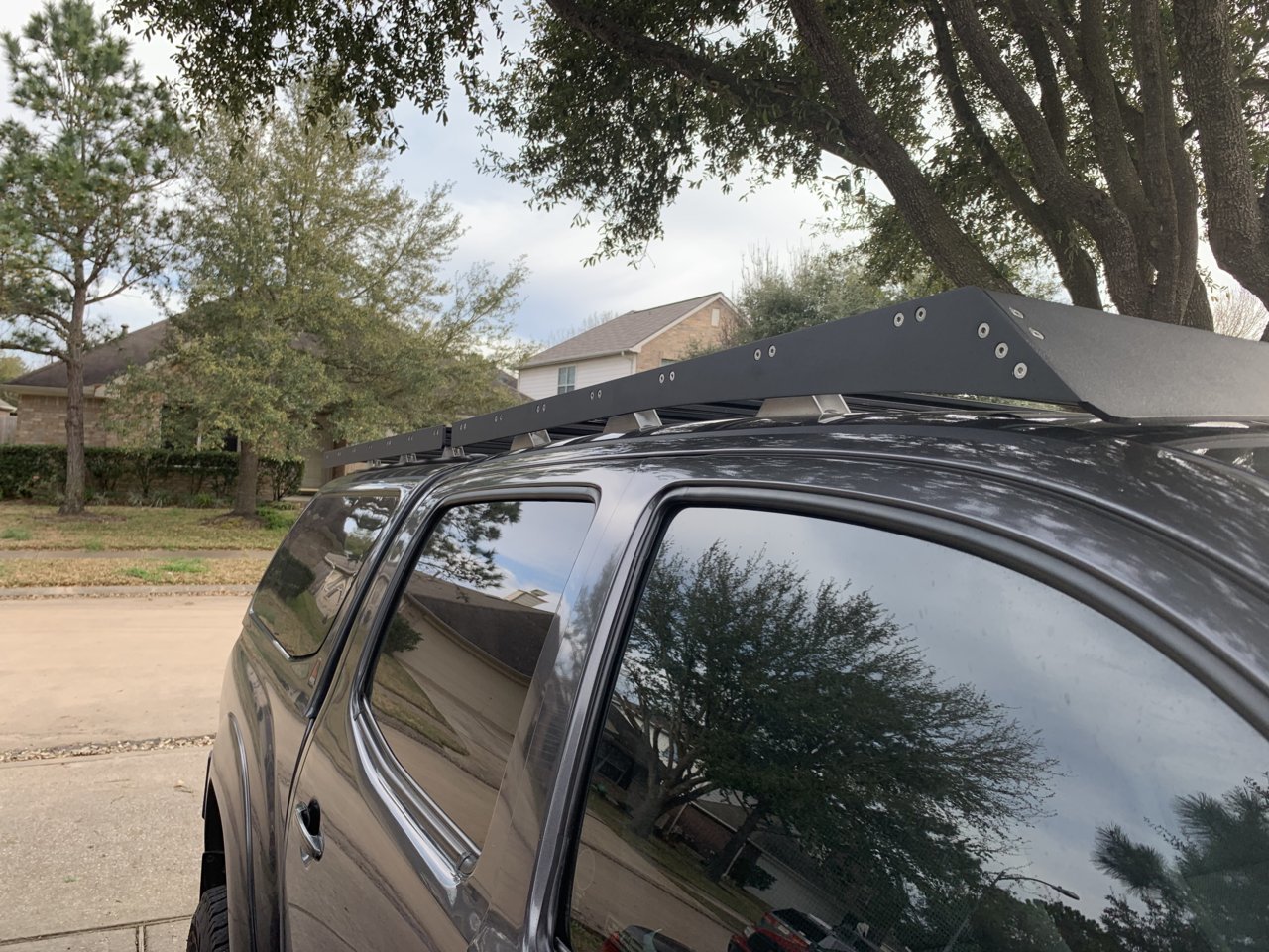

    You wouldn't happen to have a few more photos on how you mounted your rack onto the cab?
    loginfailed[QUOTED] likes this.

    loginfailed Well-Known Member
    Aug 29, 2016
    #195923
    5,156
    Dwayne
    Houston, TX
    2014 DCSB 4WD

    Thanks I was interested in how you attached it to the cab but seeing the Rhino Track it makes sense.

    I didn’t really add it up. Total cost was much less than buying a finished product from someone.
    It was fun to make, but if I were to do it over again, I’d probably just buy the racks from someone with a finished product due to the time invested.
    It did force me to buy a few tools that I’d been wanting. So there’s that cost, but the rack is a one time deal and the tools I can use over and over.
    (2) 4” x 60” x 1/4” 6061 flat bar (cab sides)
    -cut to 58”
    (1) 6” x 48” x 1/4” 6061 flat bar (faring)
    -cut to 47”
    (2) 2” x 60” x 1/4” 6061 flat bar (cap sides)
    -cut to 47”
    (15) 1” x 2” x 47” crossbars
    (1) 1” x 1” x 48” 6061 tube (cap feet)
    -cut according to needs
    (1) 1.5” x 1.5” x 48” 6061 tube (cab feet)
    (~80) M6 x 1.0 stainless screws
    -countersink or not, your choice
    (3) Yakima Y8810074 (8-pack)
    -feet to roof rails
    (30) M6 x 1.0 stainless steel T-nuts
    -crossbars to feet

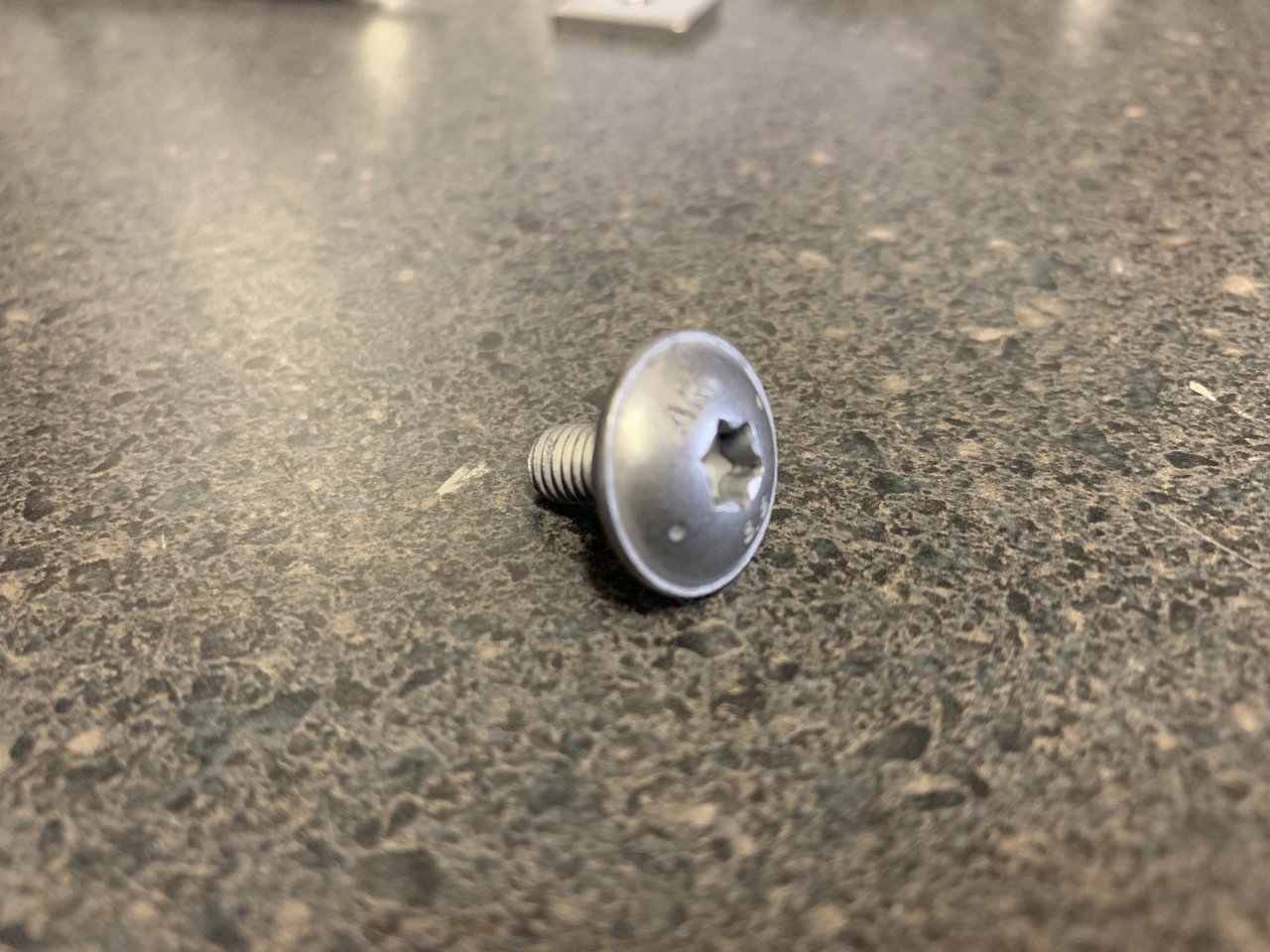

    (24) M6 x 1.0 x 15mm VW sunroof bolts
    -feet to roof rails
    -Don’t remember p/n, here’s a pic:
    (24) M6 x 1.0 stainless hex bolts
    -feet to crossbars, various lengths
    -12mm, 15mm, 25mm
    Powder coating was $150

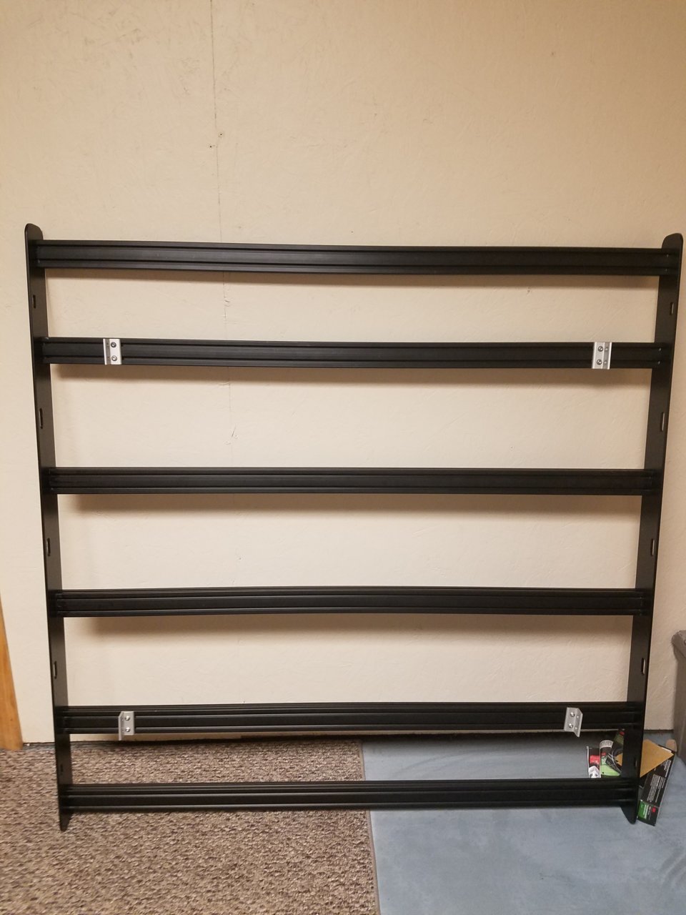

    This is what they look like on my rack

    Got the side plates and square for base locally. Ordered the Crossbars from tNutz and should be $220 total cost for my shell rack.
    WetTaco likes this.

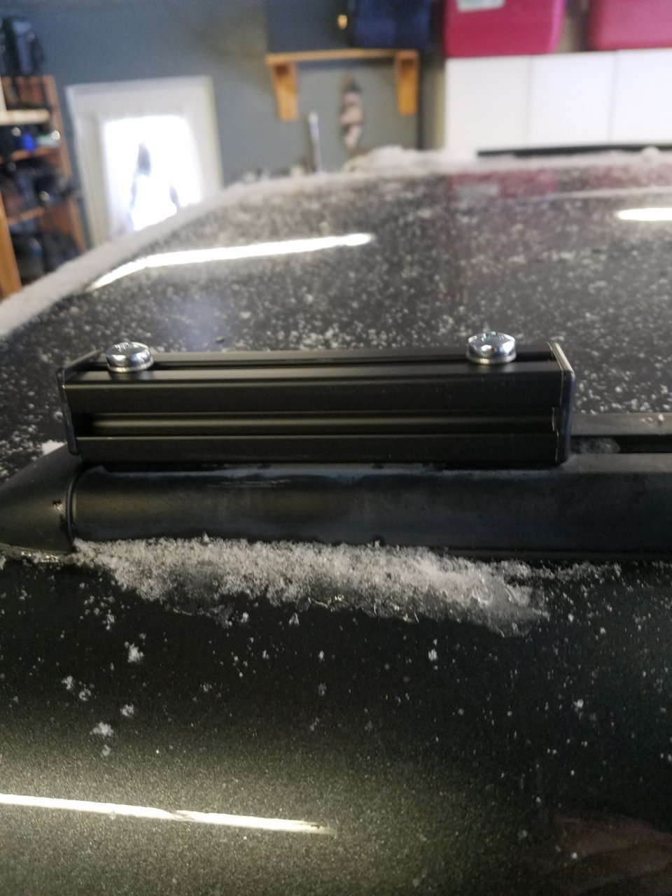

    Nice, Did you just drill through the 1 by t slot and capture a nut in the thule rail?

    Probably not. Just set the angle pieces either inside or outside the roof mounts and use the side t slots.
