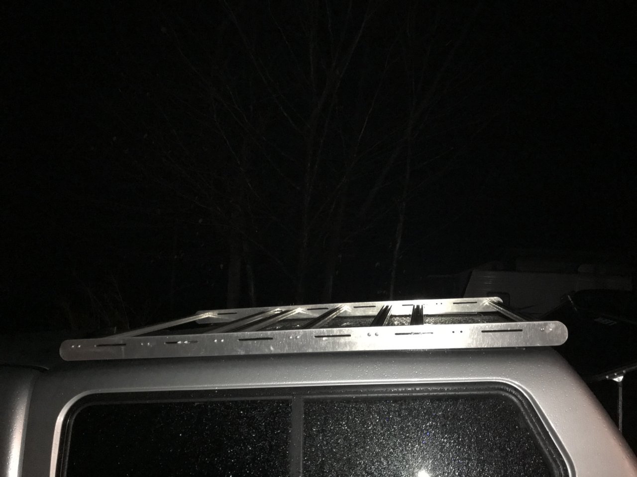

    more progress on the beachburner mounts:
    V1 on the left, V2 on the right.
    Both mounts are just under 2in tall and can be adjusted in all three axes. Height can also be tweaked, either with the use of washers, spacers, extrusions or with v2 - internal bracket configuration.

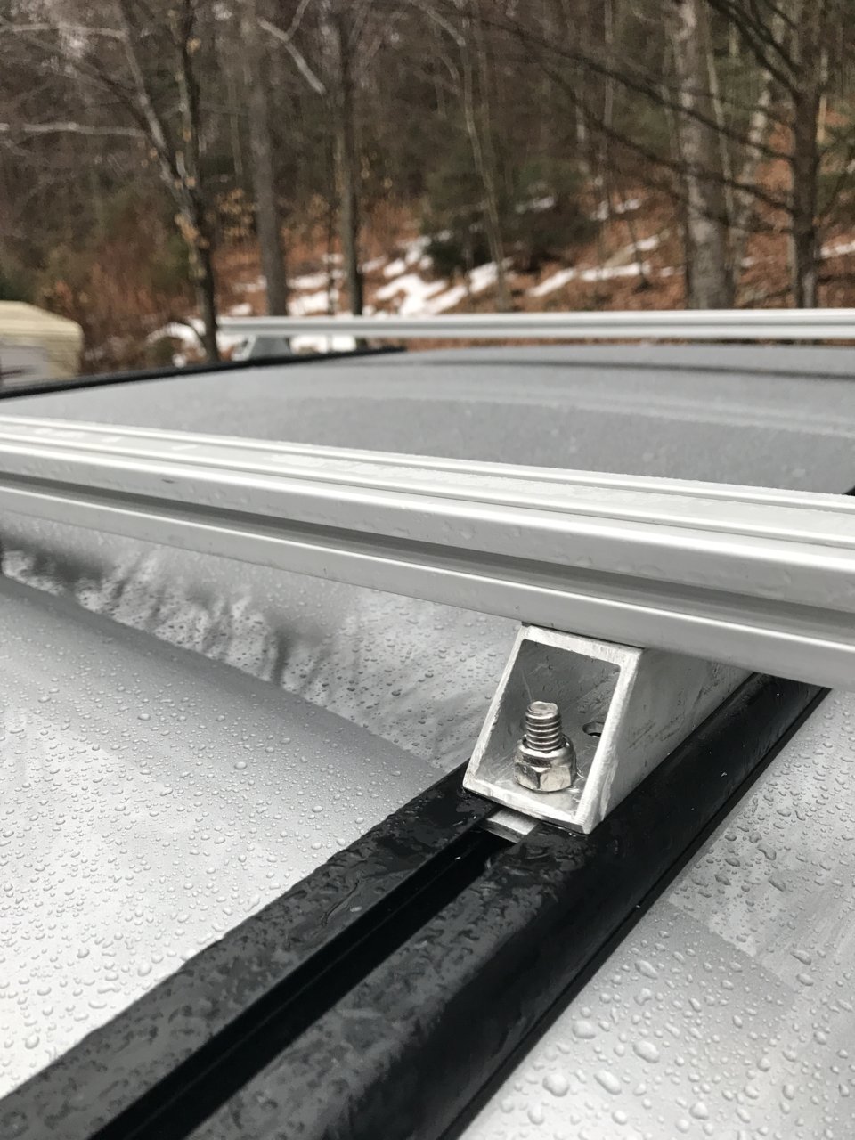

    F2F72915-FBEA-44B9-89DA-5E0995B5D003.jpg 6098D252-FB4C-4FB6-A47C-FA54CD446C8D.jpg Got mine bolted up today. Need to adjust the mounting feet but wanted to get it thrown up. Going to mount grab handles and scene lights then I’ll pull it apart and paint or powder.

    That looks great! What size is the bar stock and hardware to mount to the tracks?

    You can see we've done something very similar to what you've described with the prototype on my truck right now.
    However, this setup only allows us to correct for pitch and roll. This is great if your tracks are perfectly parallel - but we're designing these mounts to be truly universal and able to be installed on vehicle roofs as well. Looking at our roofs, the drip channels where these will mount actually curve away from each other and will require modulation in all three axes.
    Here is a look into the guts to get a better sense:
    with a big degree of adjustment

    Its 1-1/4" aluminum square on top. The top is 2" wide and the bottom is 4" wide. There is a small 1/8" thick piece of aluminum strap in the track with the 1/4-20 stainless carriage bolts that are 1" long hammered into the strap. Doing it this way you have to grind down the heads heads of the bolts to accommodate the clearance. Ill probably swap that hardware for the factory slip in thule nuts and run bolts down like this route
    https://www.etrailer.com/Accessories-and-Parts/Thule/853-7557.html
