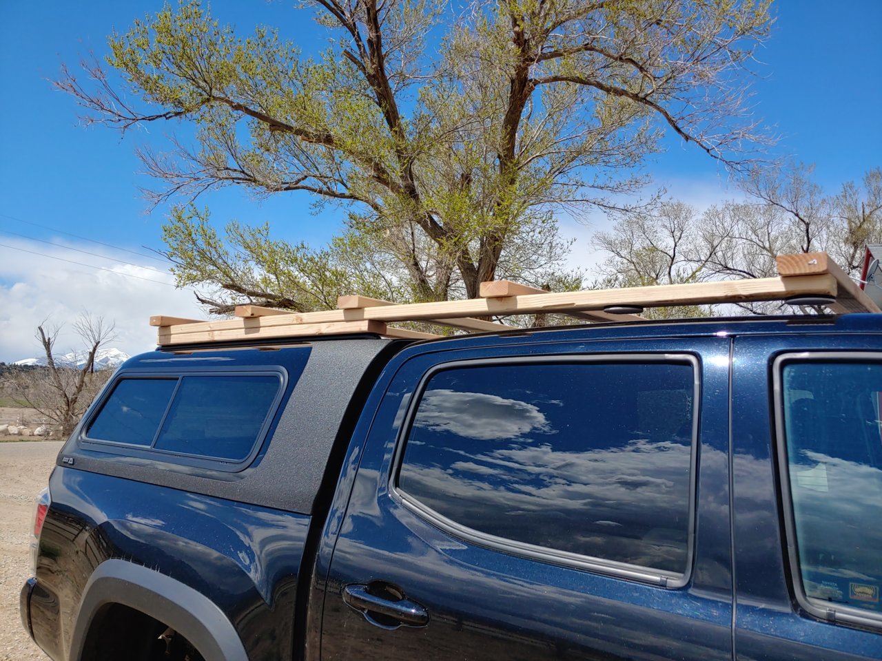

    Lift and cap so far...
    Put the temporary rack back on for a trip to pick up a mattress

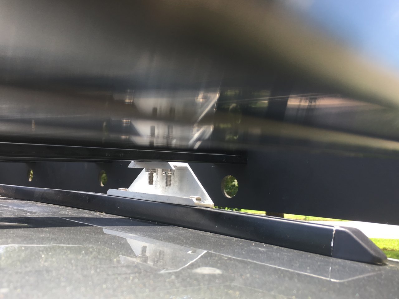

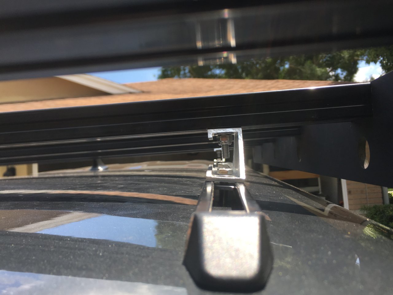

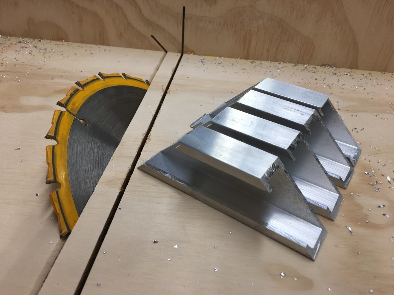

    2014 DCSB PreRunner SR5
    Finally had time to mount it. Ran out of time to make a sexy mounting system so I just ripped down some 1X2 aluminum profile on the table saw. Over happy with the rack but the carriage bolts from Ace Hardware made mounting it painful and when I paint the mounts I will be swapping them for some T-nuts. DBB96B66-D8B1-4770-8AEB-CF3F1BE6D4B7.jpg61F508F6-E3C9-4DDE-B0D5-812638DD5CB7.jpg85676F53-C931-437E-8B14-A1D48FAD4297.jpgF11CE7D8-C336-4E20-B408-37C5BAB7E507.jpg

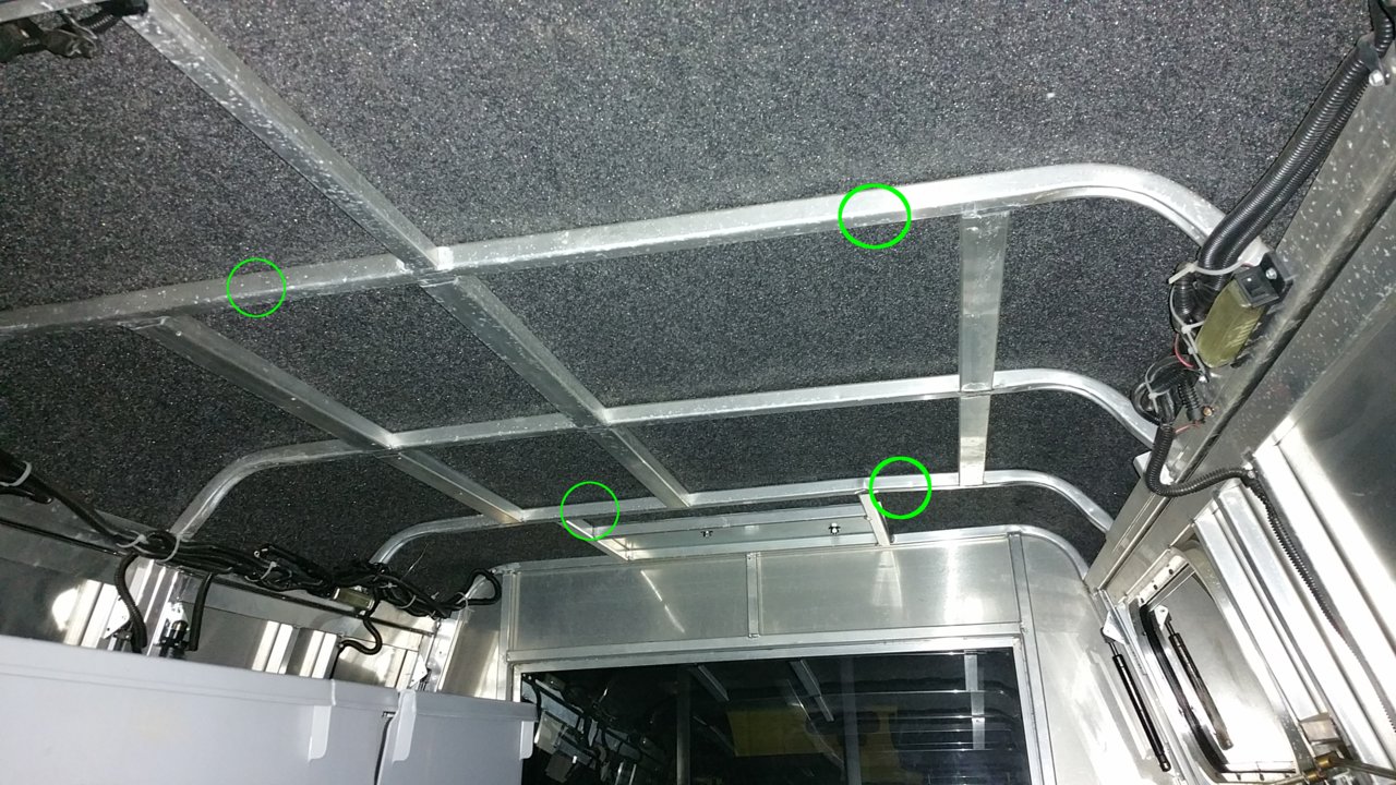

    was planning on doing this but had a question regarding mounting L track to the roof. I have a leer dcc, and the inside cross members are 1"x1" alum. Was planning on drilling straight through and putting a bolt/fender/locknut. Is 1/4-20 stainless steel appropriate for this application or something bigger? L track has 1/4" pre drilled (https://www.uscargocontrol.com/Airline-Track-48-Aluminum-Finish-Logistic-Track), unclear if i should attempt to widen that hole to fit a bigger bolt . Any input is appreciated

    Any 1/4-20 hardware you use will be much stronger than the aluminum cross member or fiberglass

    Pure genius on the mounts, accounting for the slope of the shell. I may have to borrow this idea. :thumbsup:

    Can anyone smarter than me comment on if this type of mount would be susceptible to metal fatigue from any potential lateral movement?

    In my situation the track that mounts are attached to will be the weakest point. They are made of the same material but at half the thickness. If your worried about the aluminum you could always make them out of steel or stainless. Just would have to use an angle grinder to do the same thing.

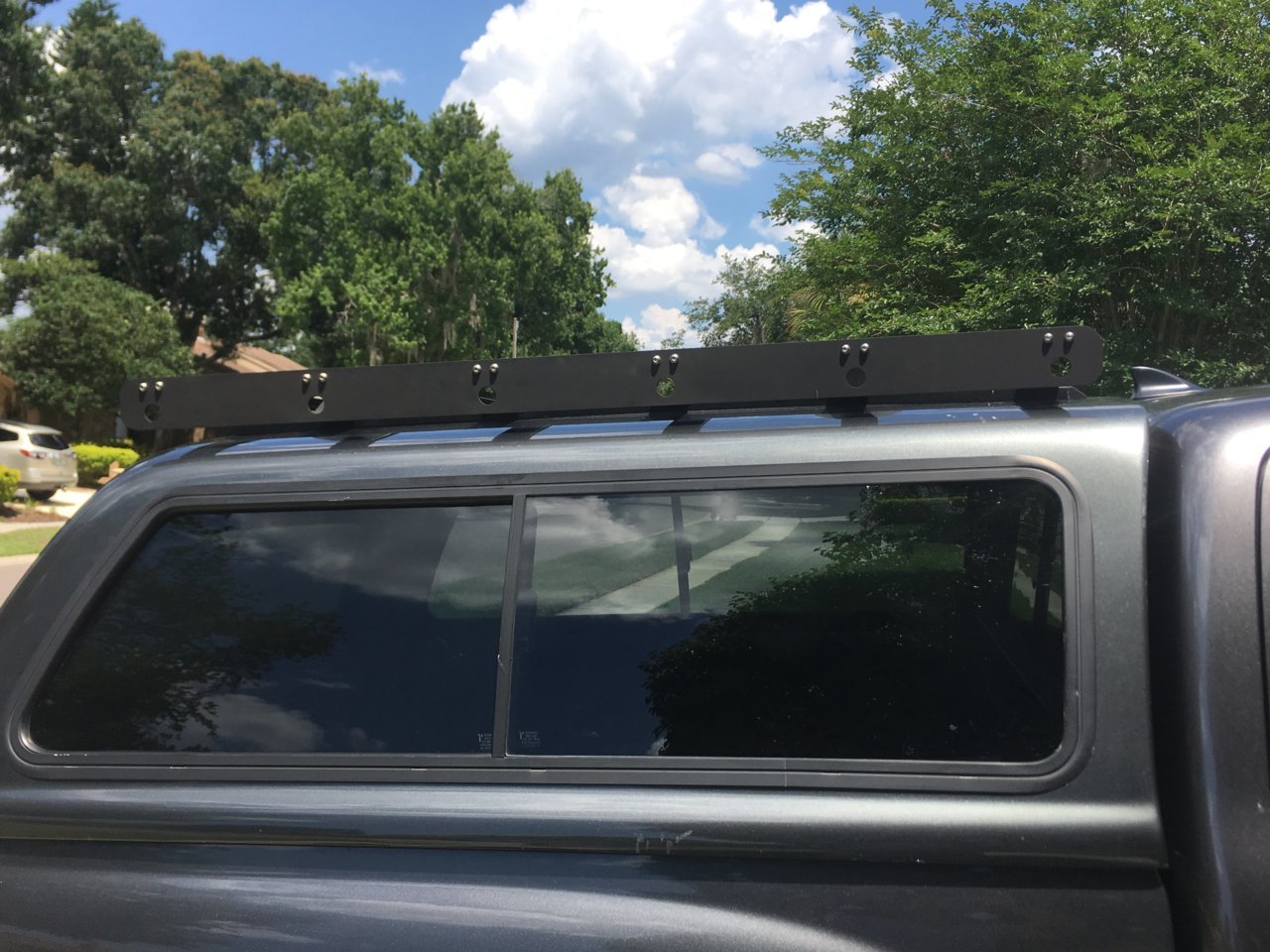

    I just finished putting this rack together last night. I used the PrinsuDesign feet (1.5") and the side plates from this page. The hardware to attach the mounting feet to the extruded aluminum were included with the feet however they only fit the 8020 bars not the TNUTZ bars. The internal dimensions on the TNUTS bars are different and do not accept the domed bots. I luckily had extra bars on the Prinsu and was able to use 3 of those and will have to supplement the Tnuts bars into the other portion of the rack and use a mixed set of hardware.
