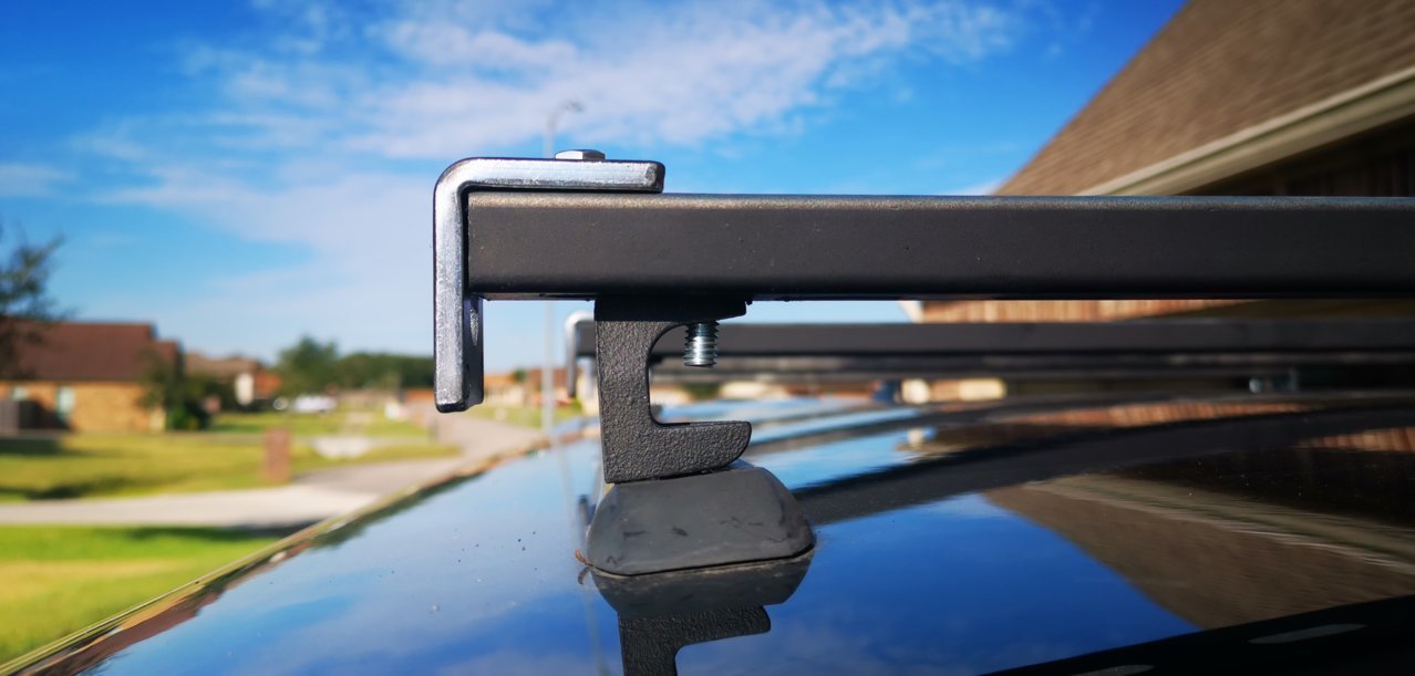

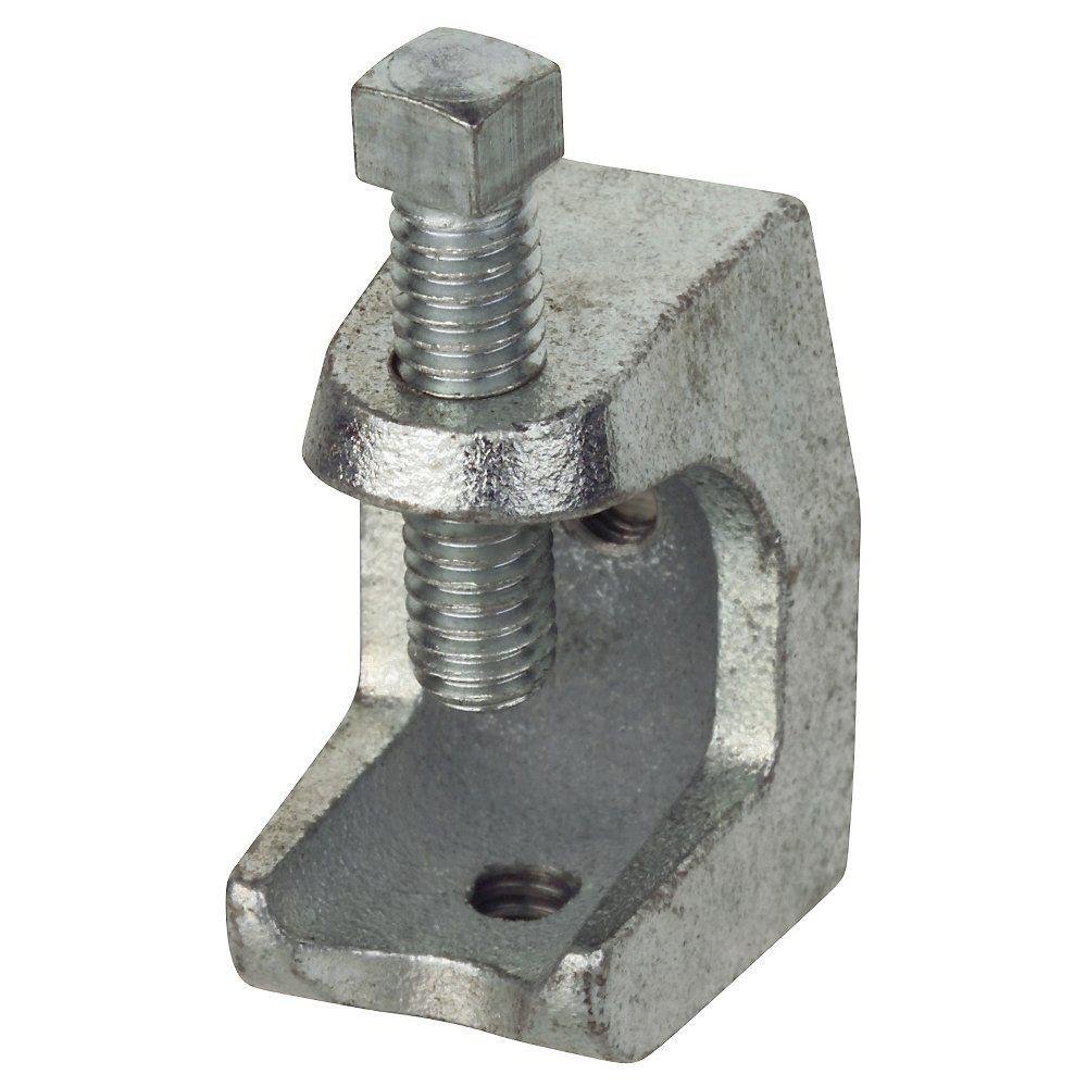

    For my custom rack I used these strut clamps. I drilled out bolt holes in the bottom to attach to the rail on the cab. Got them at home depot where all the unistrut stuff is.

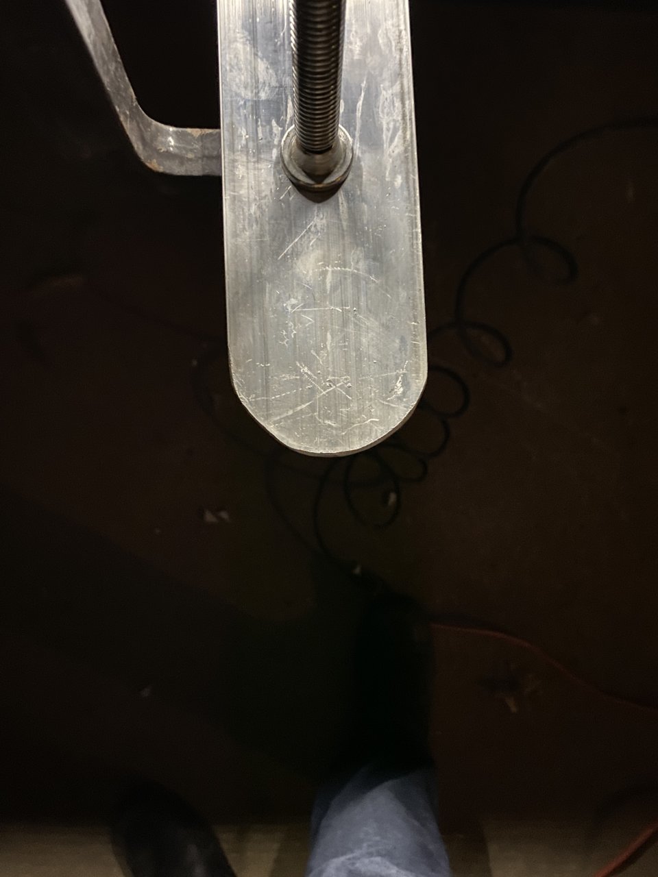

    Mounting feet are in. Tracks are here. Sides plates are cut.... the extrusions are rescheduled for delivery tomorrow. 3D27D4DF-3855-46E9-9D91-115E94CE03A4.jpgBAA31E49-0AAC-4B6B-ACF9-270A129CAAAC.jpg
    followed @EatSleepTacos advice and clamped both pieces together so their is uniformity in the ends. Turned out decent. I’ll probably spend another 2-3 minutes making it more perfectly round. I may not. I make prime and paint tonight and see what they look like. I’m wanting to wait until the extrusions are here so I can drill the sides. And that way there’s no bare metal anywhere. I did get a bonus. The guy that sent me the mounting feet also sent me all the bolts and hardware that comes with the prinsu racks. So I should have everything I need.

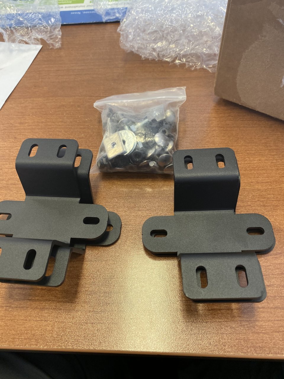

    Got my mounts put on and the extrusions in. I should have read more on the prinsu feet. They would be perfect if my tracks were straight up and down. But my tracks lay like \____/ and unfortunately there’s not enough room to move them over without them being drilled into the reinforced section of my shell.
    do the smittybilt mounts accommodate for this ?
    One of my feet match perfect but the outside foot doesn’t come close to touching.

    Jonathan
    GA
    Yes. They’re a hinge design.

    I went w these mounts. Height adjustable and accounts for the slope of the shell.
    https://sherpaequipmentco.com/components/adjustable-track-mounting-feet

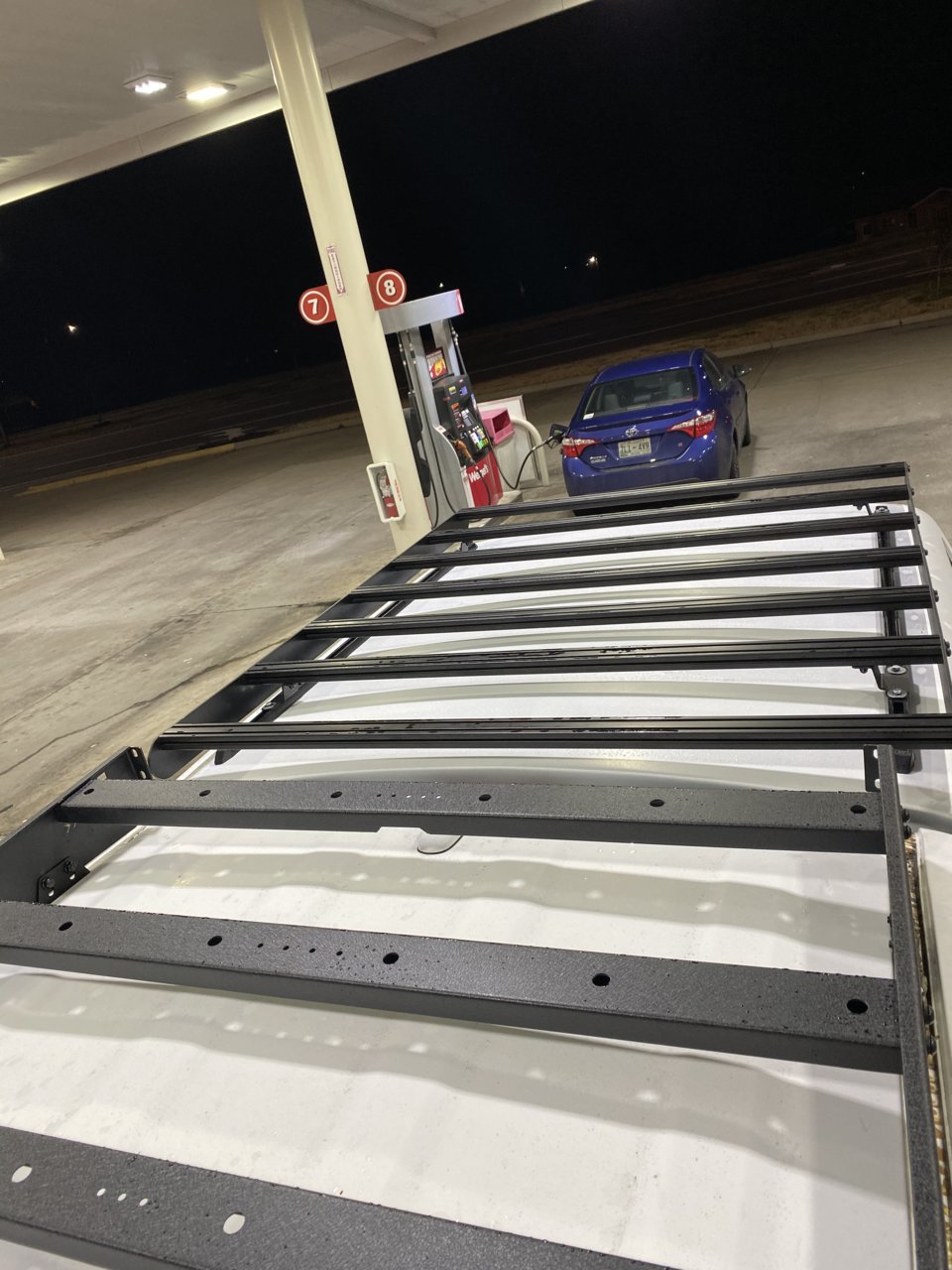

  10. Dec 14, 2019 at 7:21 PM
    #970
    Newlife
    Newlife Well-Known Member
    Jun 22, 2013
    #106845
    8,570
    Adam
    Knoxville TN
    2020 t4r orp
    Bone f’n stock for now
    Well it’s done. I think I’ll have to make a cap rack to match though. 2C58EFCF-9D9D-4928-9776-B1787E624B5A.jpg

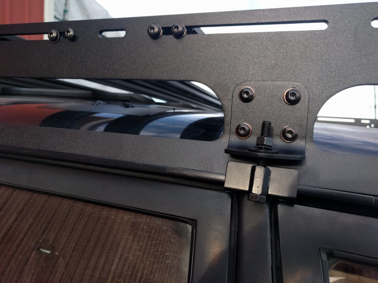

    Prinsu uses gutter mounts for the land Cruiser racks. This how they do it.
    I think you could also just use some thing like these and have them attach to your cross bars. The only draw back would be you may have to make the cross bars wider so the side plates clear these brackets. [​IMG]
