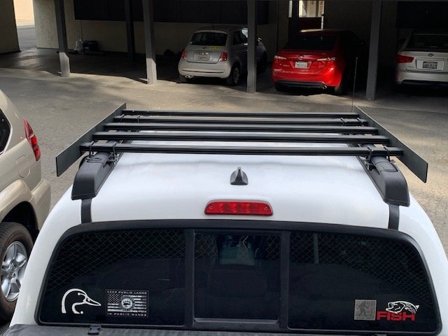

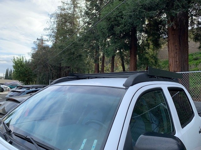

    Rust-oleum makes a primer specifically for aluminum. I used two coats of this, two coats of Rust-oleumbed liner, and then two coats of Rust-oleum professional enamel satin black for my roof rack side plates. So far so good but they haven't been installed very long. I did the same process with different primer for my steel sliders and they are going strong. The Rust-oleum professional enamel satin black seals the bed liner and creates a super strong finish.
    upload_2020-2-25_16-45-56.jpg+upload_2020-2-25_16-46-40.jpg+upload_2020-2-25_16-46-21.jpg
