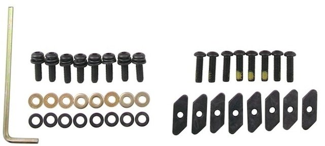

    What’s the best way to attach to the feet of the rack to the Thule rails? I have some of these but doesn’t seem like a strong enough option to hold the tent down. Maybe I’m wrong

    This is what @Bannerman did.
    I pretty much copied him just with smaller feet.

    Gotch ya so that thin piece of metal with the bolts slides in the track. Remember dimensions?

    I just checked and my tracks are actually Yakima, not sure if they are any different from Thule. I bought some 1/8" thick x 3/4" wide aluminum bar from The Depot for like $5.It fit nicely in the track but I had to sand down the carriage bolts to make them fit. (they were too big height wise). you can kinda see in the picture where the tops of the carriage bolts have been flattened.
    One other thing to note is that the feet hit the tops of the screws that attach the track to the topper. I ended up removing the screws to the topper one by one to slide the feet on. Kinda sounds like a pain but it really wasn't bad.

    You can actually buy Flat Head Carriage Bolts on line for a reasonable cost. Search on Amazon and there plenty.
