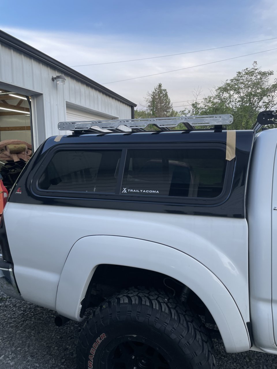

    Almost finished with mine. Getting the sides powdercoated Tuesday but just had to install it up there. Compliments the Prinsu I also put on today. Very very happy with this. Favorite mod I’ve done so far

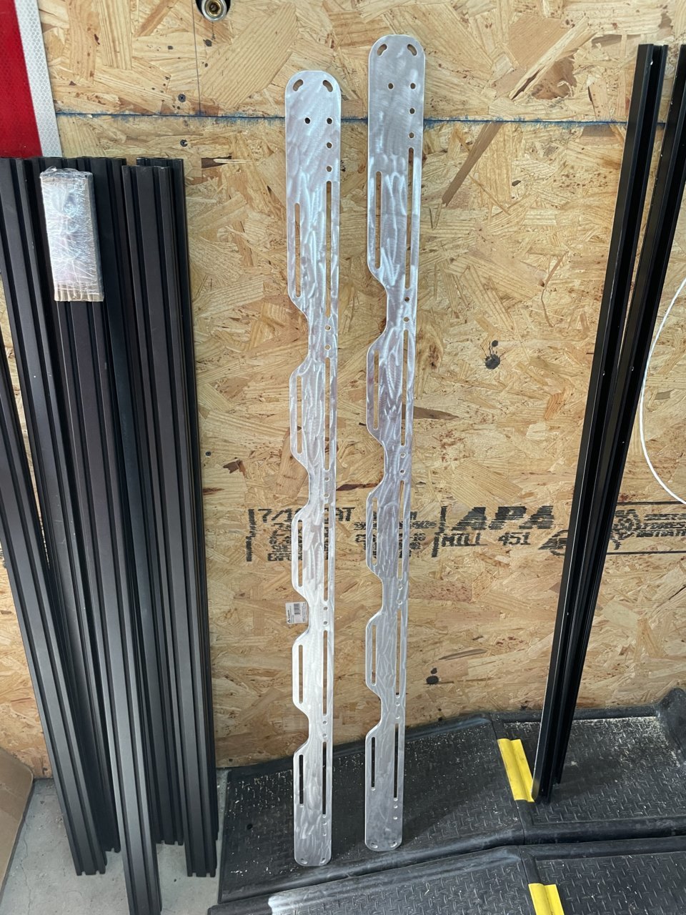

    Did you have those CNC cut or did you DIY? Also what's the measurements on yours?
  8. May 29, 2021 at 10:46 AM
    #1088
    hankkingtattoos
    hankkingtattoos Member
    Jun 2, 2020
    #330224
    15
    Hank
    Kingsport, TN
    14 DCSB
    BAMF hybrid bumper BAMF LCA skids Viair HD On-board DRT Fab bed stiffeners Prinsu Cabrack DIY Cap Rack Mountain Hatch tailgate insert Icon leaf pack ECGS bushing Slims Depot 8 switch fuse panel Fox 2.0 front coilovers at 2” Fox 2.0 rear shocks with reservoirs Procomp 17x9 stealth 42s General Grabber X3 33s Leer 100R cap Trd pro grille Cali-Raised Fogs
    I had them done on a CNC machine.
    They are 1/4” thick, 3” tall and 50” long.
    TNutz 47” extrusions, and the Prinsu feet

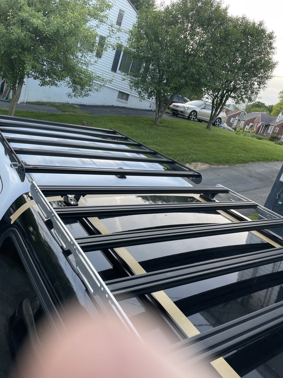

    Nothing fancy, just used the half height uni as a backer for the through bolts. I was going to build a skeleton under it to support the roof of the shell but honestly its pretty stout and haven’t felt the need yet. Here is a couple pics that kinda show it.
