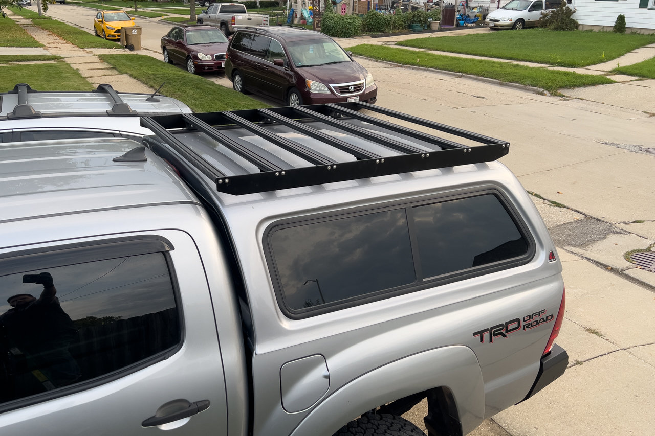

    Ressurecting this thread because it's probably the most comprehensive source of DIY rack info on the site (unless I missed other ones). I followed many of the things shared here to build my own and I'm thrilled with how it turned out. Did a separate write-up because I didn't want to spam this thread with so much detail. Thanks to everyone who has contributed over time, you have my gratitude for the inspiration!
    https://www.tacomaworld.com/threads/wi_taco-diy-extrusion-style-camper-shell-rack-v1-0.815953/
    Blackwolf and BigCountry762x39 like this.

    This is a great idea, thanks for sharing. I'll be making my own based on your plans. Question: I see you installed 7 cross bars. I was thinking of installing fewer to save money, maybe 4 or 5. Any reason you would recommend 7 crossbars instead of fewer?
    wi_taco likes this.

    The more crossbars, the more the load is distributed. Now the real question is probably moreso is 4-5 sufficient for what you intend on carrying? And no matter what you plan on putting up there, the answer is still probably absolutely yes, its sufficient. As for 5 vs 7 bars, and the load distribution stats, I won't even pretend to know. What I do know is I'm really good at making assumptions - and I assume that if a Yakima/Thule roof rack consisting of 2 bars is sufficient enough for a 150 lb rooftop tent plus a couple occupants, 4-5 pieces of aluminum extrusion is more than enough, and 7 is most definitely enough. As for any roof rack system, the crossbar is never going to be your limiting factor to your weight limit/load carrying abilities. Its going to be in the mounting system/whatever you're mounting it to, because thats carrying the entirety of the load. All that being said, opt for whatever amount of crossbars makes you happy! You can always add more later if you want more mounting surfaces. At the end of the day its another $40ish to go for 2 extra bars now. Its another shipping charge to order them later. But if the bars are just "extra" and not needed, thats also added weight. Not a ton, but extra weight regardless. It only matters what you're looking for, what you want out of it, and what tickles your fancy! Thats the beauty of the DIY route - make it how you truly want it :thumbsup:
    wi_taco likes this.

    What he said lol. I replied in my separate built thread already, but the TLDR is right in line with this train of thought. I went with 7 just because $40 extra and time spent drilling everything all at once is much easier than adding later. Could you go with less? Sure. I went with more so I don't have to work on it again. I think the fiberglass cap load carrying capacity is the actual limiting factor in this scenario. My choice to go with more bars is just because my monkey brain says "more better". All depends what you are carrying too, lighter loads mean less bars needed. In the grand scheme of things they are cheap compared to overall project costs.

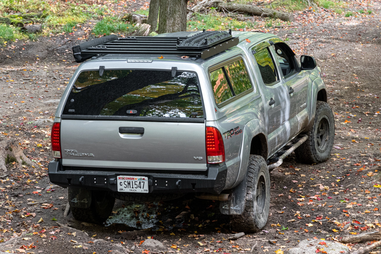

    Got a solar panel on my DIY rack
    Falldownhard and wi_taco like this.
