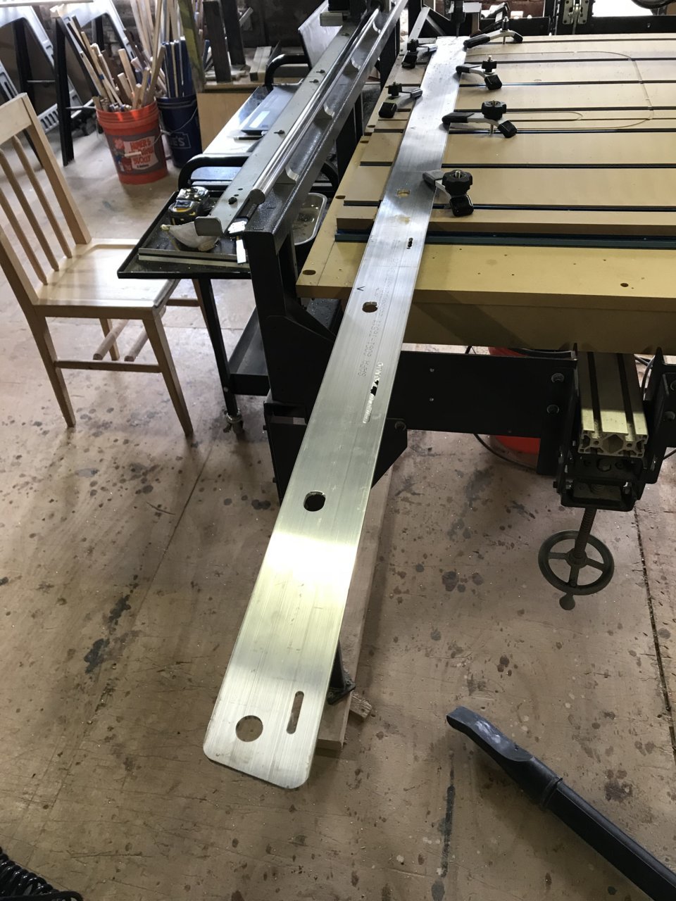

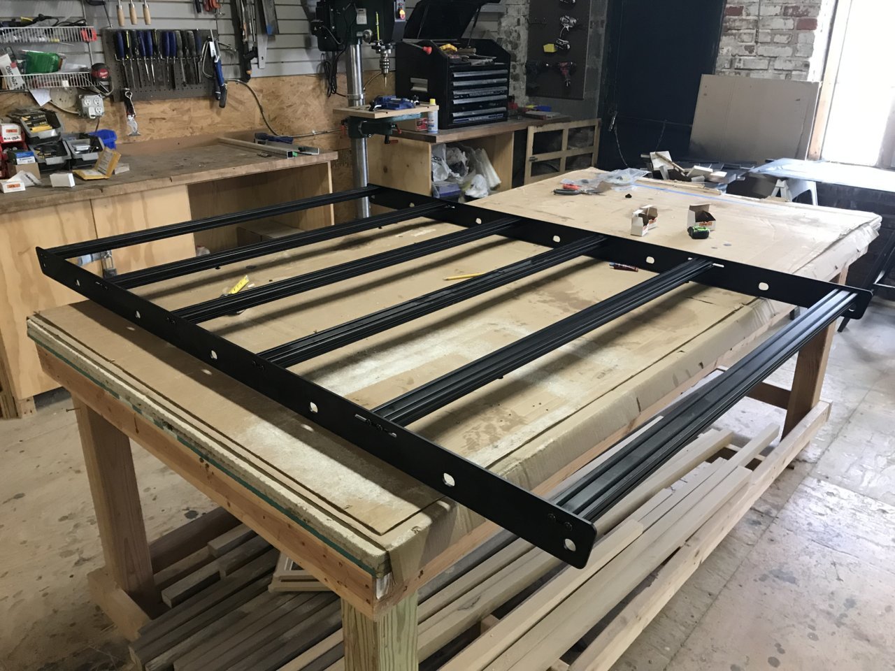

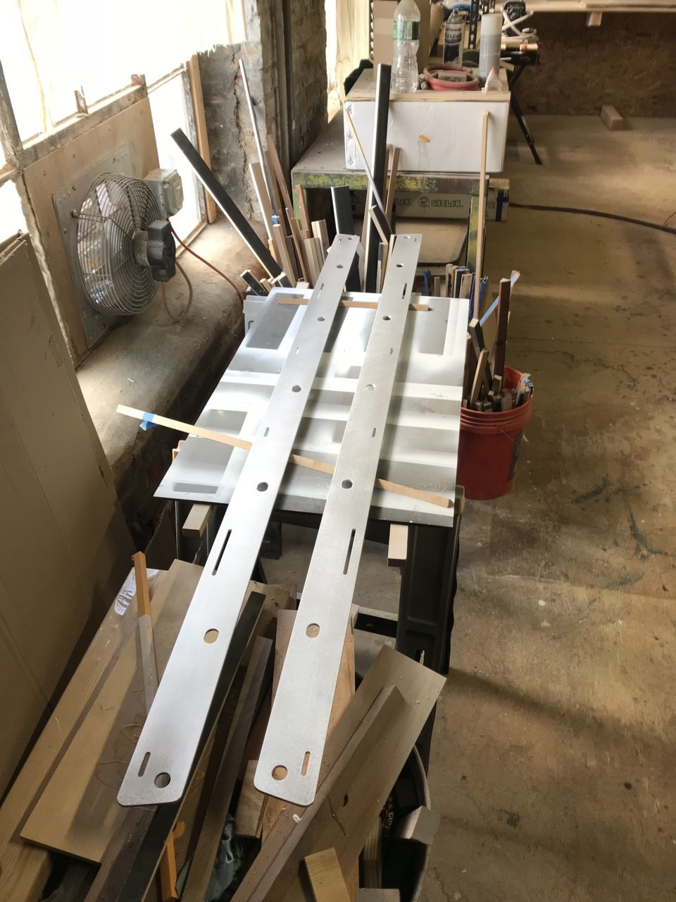

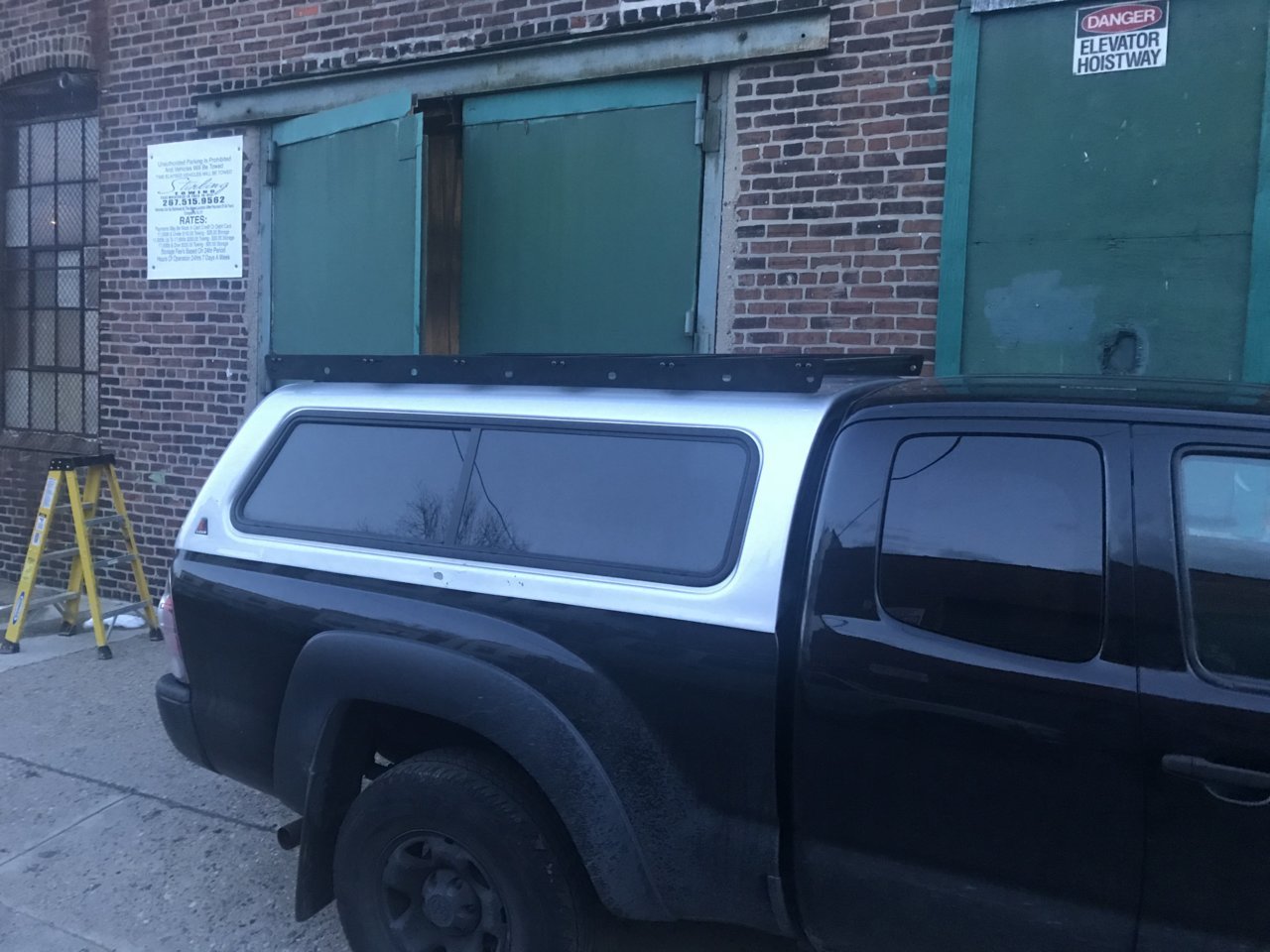

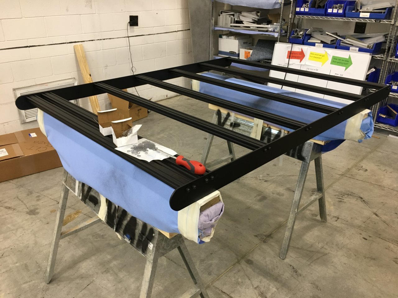

    Had this in mind then I saw this thread! The tnutz link really made me pull the trigger and I’ve wanted to mill aluminum on the cnc, here was my excuse! 3/16” x 3” side rails (I would bump to 1/4” if I was to do it again) feels solid enough. Will post more pics of the truck when I get my 5100s and new tires installed. Hope the pictures work.

    Nice job! I'd stick with 3/16" and do 3 mounts per side, light, more secure, and less weight per point load on the cap.

    Thanks! Good thought! A third mount would be easy, just wish I had done 7 rails so I could have one centered

    Did you get all of the hardware from Tnutz? What length bolt did you use to mount the side bar to the t-slot extrusion?

    1/4-20x1” I believe (it says the thread off the tnutz site) plus flat and lock washers. I got my hardware from McMaster-Carr

    yea thats about what i used.

    I used 6’ and cut it to 70” to fit the long bed.

    San Diego, CA
    2007 Silver Double Cab Tacoma TRD Sport
    Freakin badass man! How did you go about rounding off the edges so clean?

    On my old rack, I found something that was round and used it as a template on the edges. Then just cut/grinded with an angle grinder. THEN clamp both sides together and finish off any minor differences, so they become identical.

    Depends on roof length and shape. The tracks don't bend much so you have to stay in a length where any curve is minimal and consistent.

    This \/ \/ \/, but I used a jigsaw for the cuts.

    I used a jigsaw too, then flapwheel on the angle grinder.

    Where did you guys get the 3 inch wide flat bar? Im having a hard time finding a shop that has it around my area.
