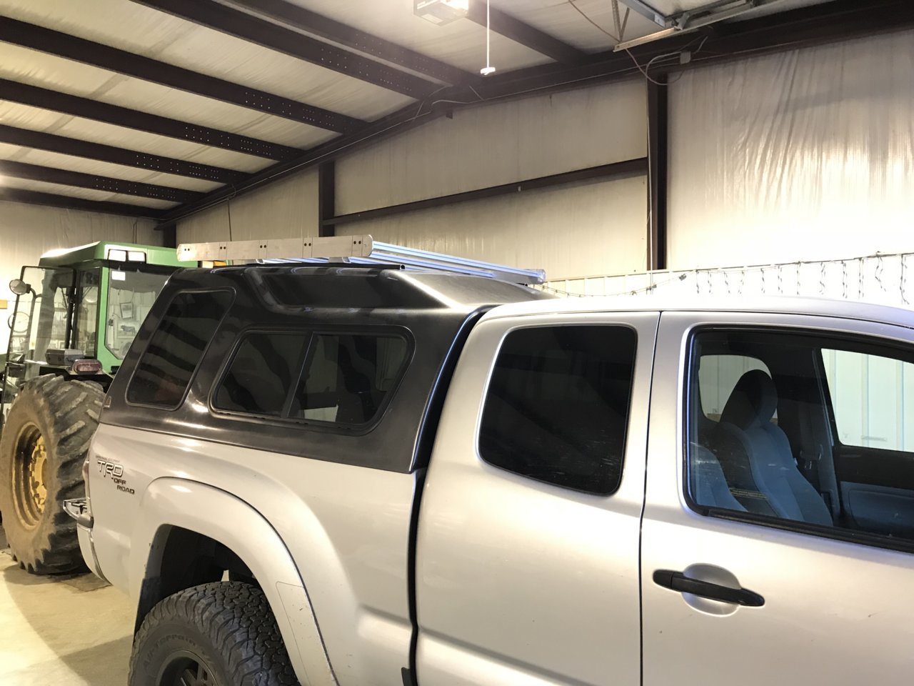

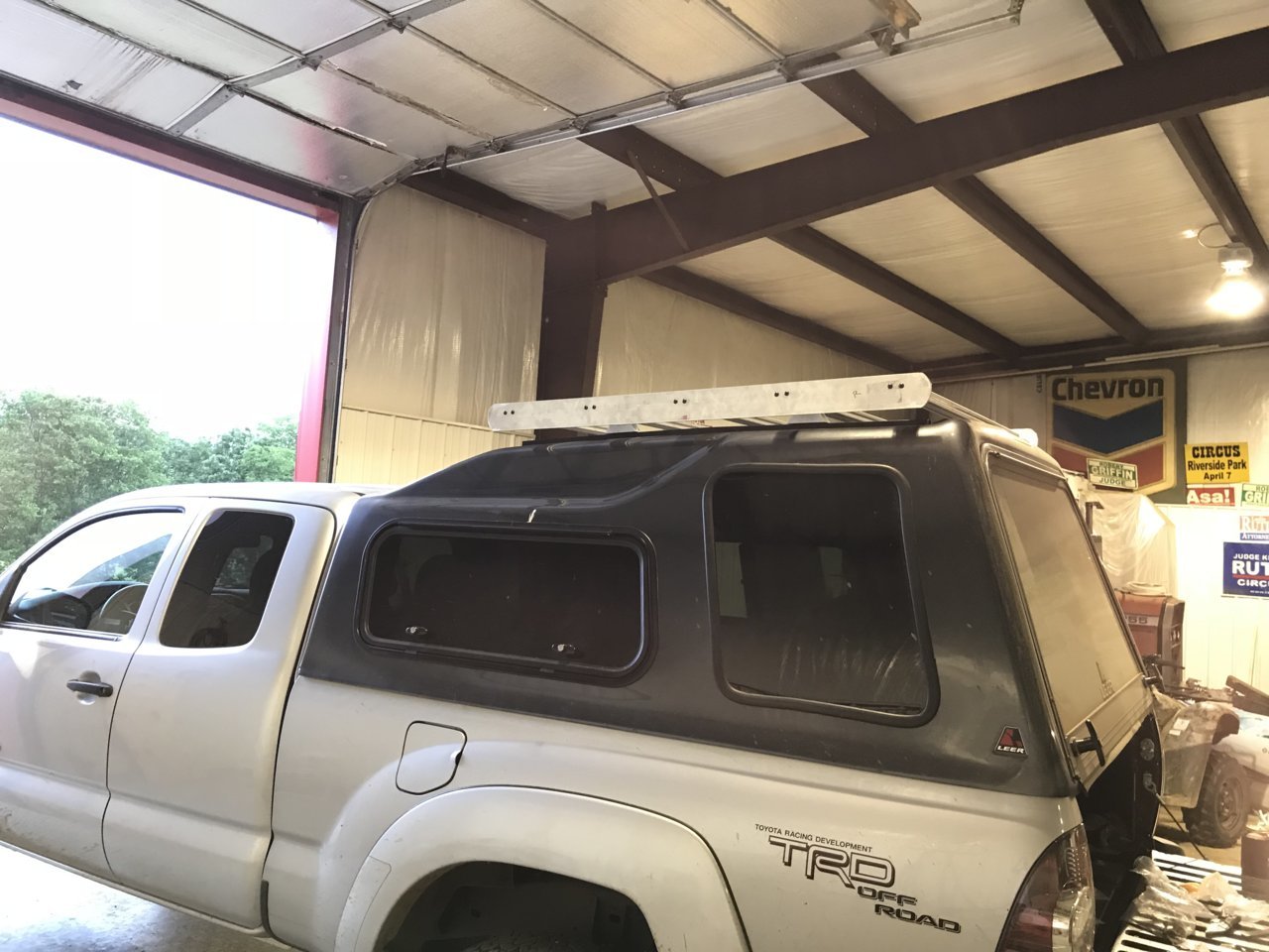

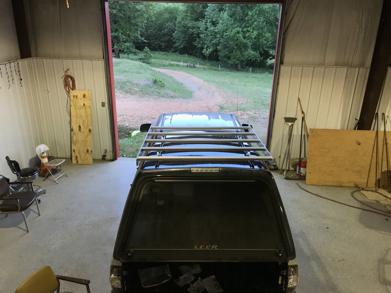

    F543AAB2-1C09-4253-BFC3-1628366124CB.jpg 8CCA6C58-34FE-4B56-9452-29B58E9D676F.jpg 8D067C3B-CB13-4522-8D25-2D86E161BD31.jpg Here’s my take. Thanks for making this! All that’s left to do is paint.

    Looks good
