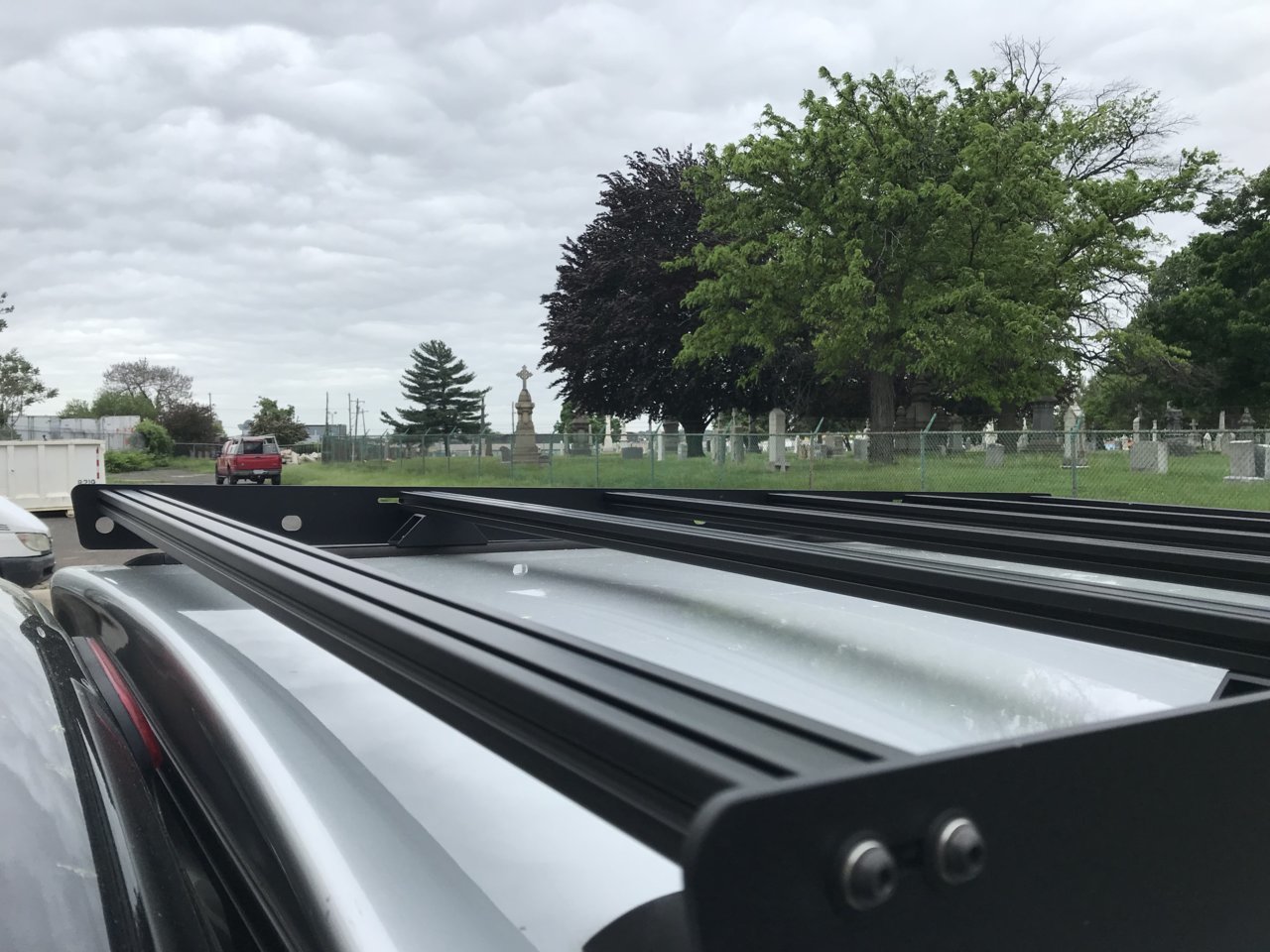

    Here’s a better pic

    There’s a ton of options out there, I have Thule tracks so I just found the replacement t track nuts for their feet from etrailer, for the aluminum extrusion the tnutz site sells any of the nuts you’d need and just the right thread and right length bolts. I wish I could tell you exact but I ordered a bunch of random ish at the same time.

    Yea, an inch on either side for the mitre and 2” for the cross bars

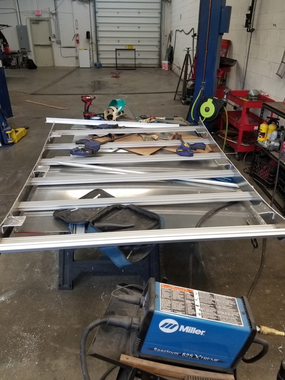

    Home made prinsu knockoff cab and cap rack project in 3...2.....1....

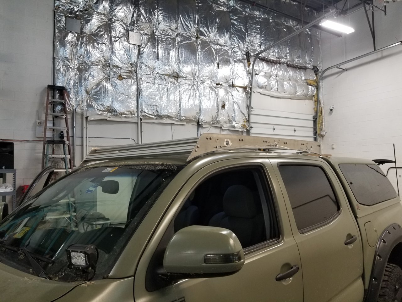

    Damn dude that is gorgeous! Any close ups of the mounting method?

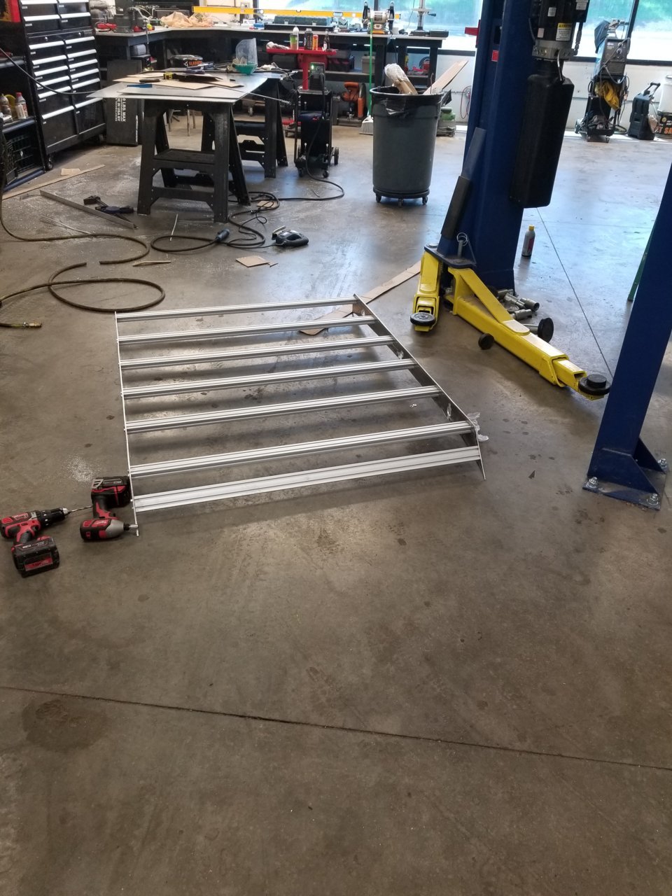

    I havent 100% figured that out. I cut the aluminum into 3" strips and bent it into brackets. Those are bolted to the inside of the rack. I now need to find a 1" spacer 3/4" wide and 3" long to sit in the roof track. The toughest part was lining up the bracket holes. With the holes in the roof. I put the bracket where it should be, marked the center of the roof track on the bracket and transferred a mark on the roof for the cab holes.

    Looks awesome! Good job! What did you use to cut and how thick is that sheet?

    The sheet is 3/16". Which seems to be more than enough with 7 bars. If you were doing less you may want to use 1/4". I started off with a jig saw for a clean cut, but got impatient and broke out the plasma cutter...

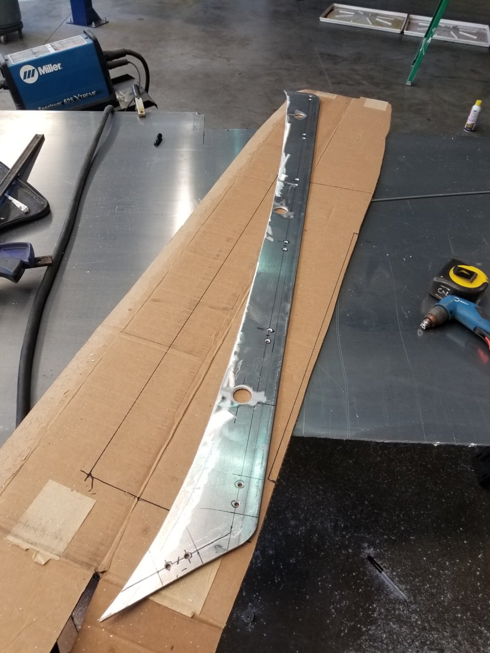

    did you measure to create the side rails curve that follows the roof line? Or used a template?
