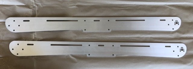

    Very nice design and writeup! If I had seen this before, I would have perhaps done it too, but I am happy with my self-designed rack- even if it cost a bit more.
    I was one of those who ended up designing my own online and having it laser cut from a online machine shop (emachineshop.com). It turned out pretty well and I really like it, here’s what the sides look like:48C0AD4F-1836-4C97-8A0E-8CBC35642675.jpg

    How much was the laser service?

    It cost $150, with the rails (from tnutz.com) and hardware, the rack cost $300. It’s a short one that fits on top of my ARE MX shell like this:A7668D57-66E0-4C8B-8979-AA9A08D8B41F.jpg

    Emachineshop.com has a downloadable cad program that you can use to design and then get price quotes for free depending on your material.

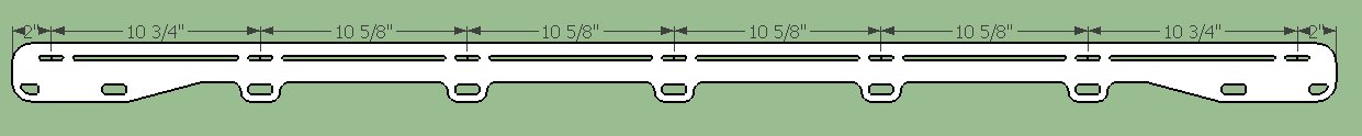

    How far are your crossbars spaced out? Just got all my materials and am ready to get going.

    I'm currently out of town without the truck but can measure when I get back. think they were centered roughly 11" because the overall length was 68" and I used 7 cross bars.

    Most or the bars are 10-5/8" on center. The end bars are 10-3/4". Center to end of rack is 2" on the ends. Hope this helps.
