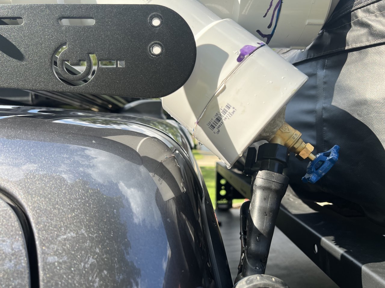

    A couple of days ago, I finished building it and had a test run. It failed. The wing nut clean out plug that you see in the photo below, had water pouring from it once I added a small about of pressure. Plan B is to change this out with a screw cap. Last night I finished this up. One small issue I had was the stack up of this new design interfered with the RTT. I will have slide the tent back a couple inches for clearance.
    Tonight I plan to test this new screw cap design, with some hope, it will be successful. If it is, next step will be mounting it to the Prinsu and painting it black. Thanks for following along.

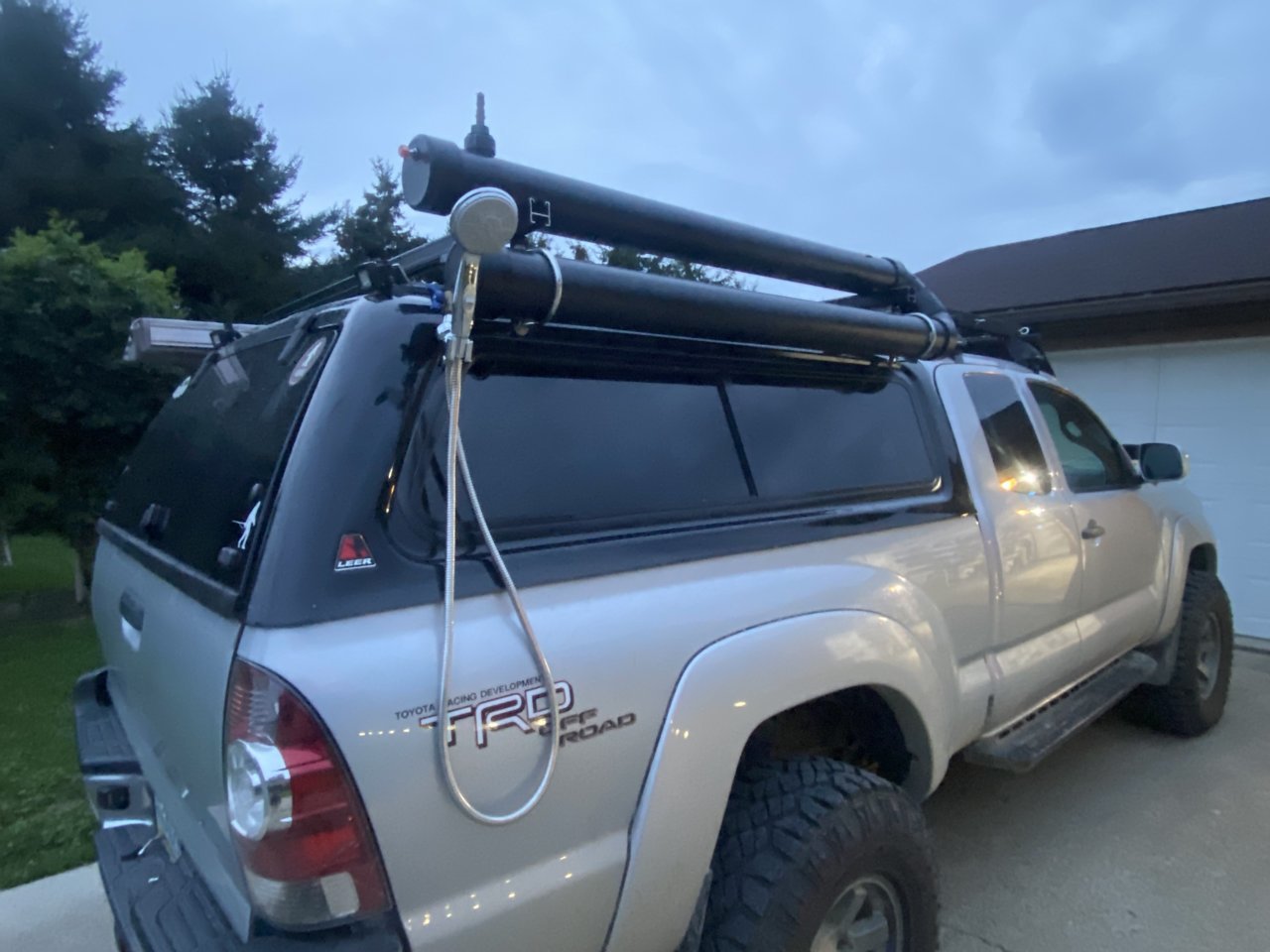

    I have mounted the tank to the Prinsu and have been driving for a couple of weeks, highway included. Tank does well on the rack. I order a pressure relief valve. I plan to add this to the tube. I will be able to set this to the desired psi (thinking 30) without worrying about the tank loosing pressure. I can then run my compressor 100% while using without fear of adding too much pressure to the tank. I want to get a small battery operated compressor to attach to the Schrader valve while in use so I don't have to use my big compressor.
    Once the valve is mounted, I can do another test run. If all goes well, last is paint. Then were going camping.

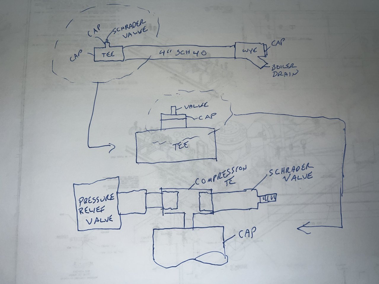

    As noted above, I am looking to add a pressure relief valve. Where would be a good place for this? I am thinking at the cap where I have my Tee at the from of the tube. I am thinking of doing a compression fitting tee that has the pressure relief valve on one side and the shrader valve on the other. This would tap into the top of the cap. See sketch.
    Or is there another place I can locate either of the two valves? Can the shrader valve be in the water column (ie, adding it the end of the tube)?

    Ahh I see we discussed this a bit early in this thread. So if I install the schrader valve at one end (it’s okay to be in the water column?) and replace the current schrader valve location with the above pressure relief valve, I should be good with this setup?

    If the valve is below the water line, just disconnect the hose before turning off the compressor or some water will Beck feed into the hose because of the tank pressure.
    Make sure the pressure valve is above the water line, or it’ll blow water out when it opens.

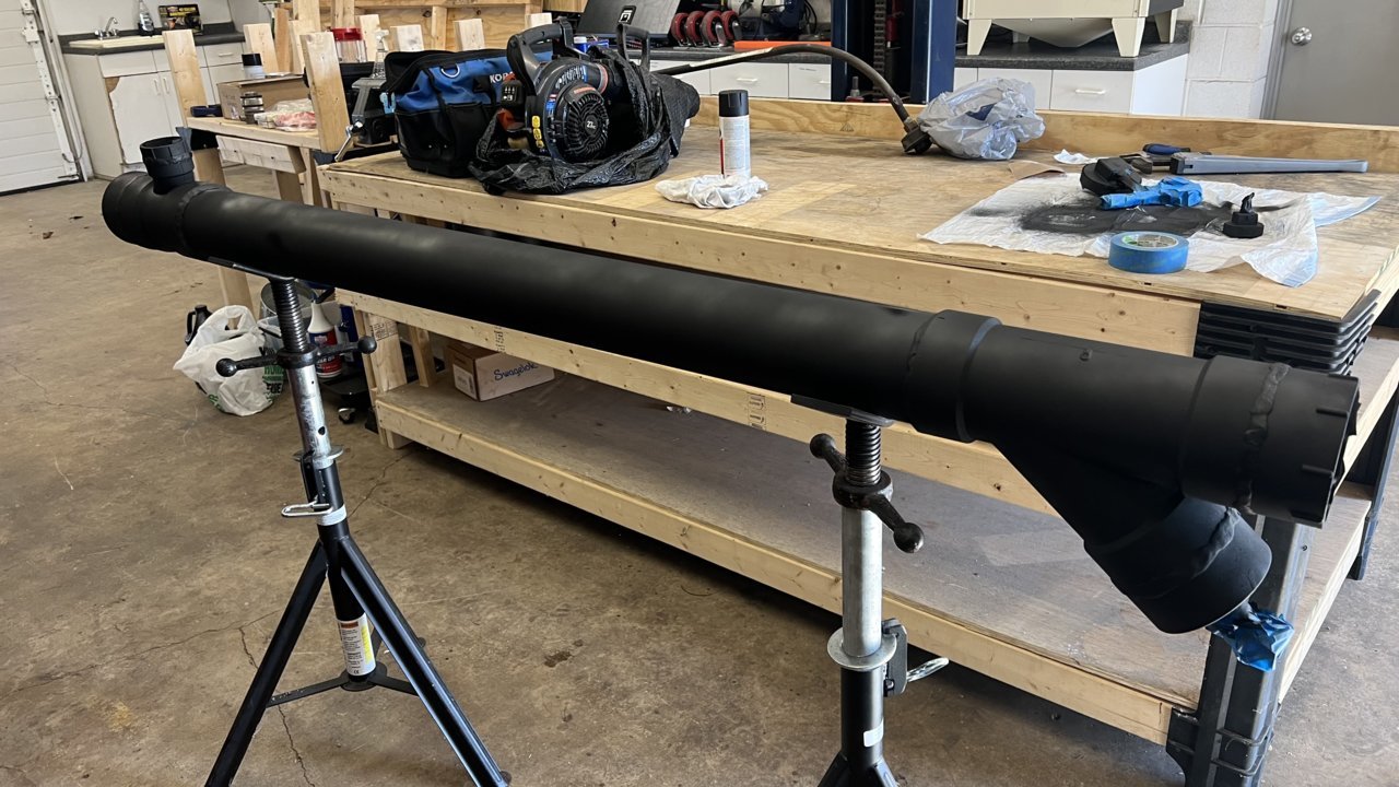

    Water tank was sanded and wiped down with acetone. The pressure relief valve and pressure gauge installed and primer is done.
