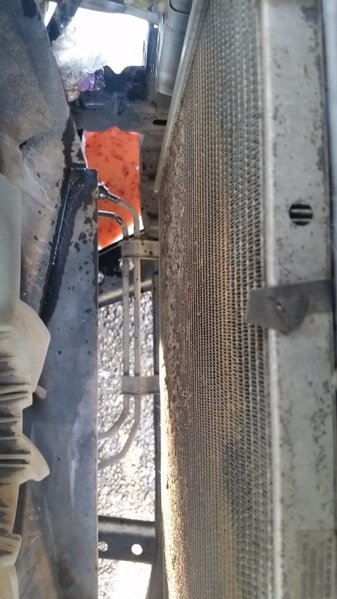

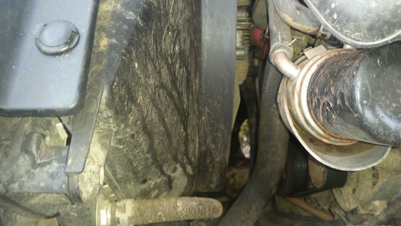

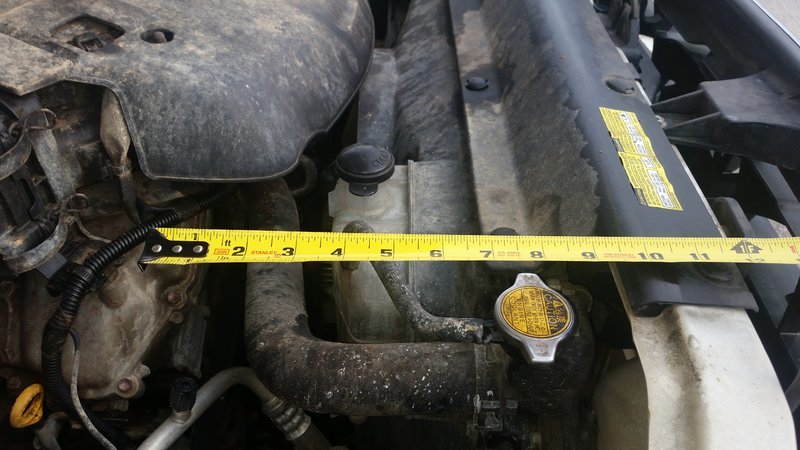

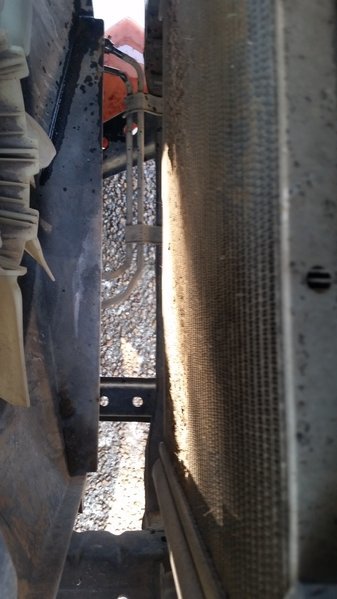

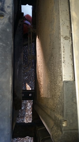

    Hi All,

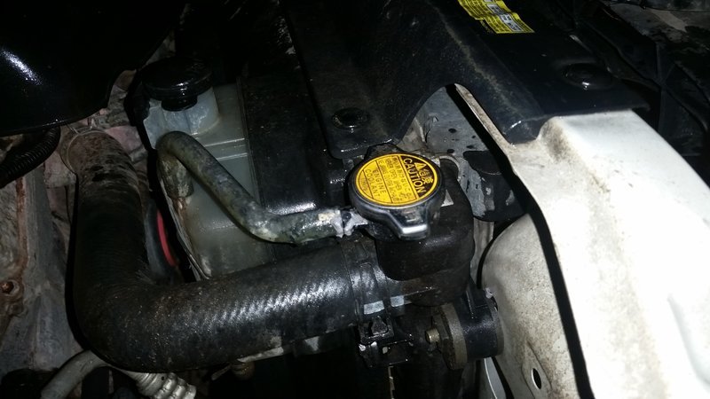

    My son's '05 taco developed a hole in the coolant reservoir line stem off the radiator cap stem and spewed out a considerable amount of coolant. He has a leak somewhere and we've had to fill it back up several times. When coolant levels are normal, engine runs fine and remains in the normal temperature ranges. And, when this recent rupture occurred, he immediately shutoff the engine and coasted off to the side of the road. So, I don't think any overheating damage occurred. Where it has been leaking off too is another story, but no tell-tale smoke in the exhaust. However, I've not had compression tests yet on coolant system or cylinders. No obvious drip puddles or burnt coolant odors either. But it has definitely been leaking off somewhere PRIOR to the rupture that stranded him.
    This said, my shortterm issue is that the radiator needs to be replaced no matter what. I will have to have it towed 20 miles no matter what. I checked with a local non-dealer toyota-lexus repair shop, and with OEM radiator and hoses, they wanted $700 for the job (not including tax). I've changed out a few radiators, but not on a Taco. I've always felt this shop shot me straight, so I tend to think they've a reason for $300 roughly in labor. From my local Napa store, I can get a Denso radiator my my model for $150 and new hoses and cap for $50. they have an OEM thermostat (with housing) for $70. Plus replacement coolant. So, $300 in parts. The Toyota dealer said the OEM replace for the radiator alone was $300 and that is was also a Denso (same model#??? - not sure).
    I've looked at the compartment and aside from the fan and shroud, I can't see anything that make me think that in lieu of $300 in estimated labor (3 hours I'm understanding), I can surely do this myself. But am I missing something? This Taco has the off-road plating on the bottom, so that does make the bottom access a little more of a hassle. I should add that I did find the factory service manual online and printed out all pertinent sections for replacing the radiator. So, I'm not just winging it! :)

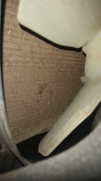

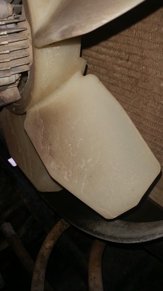

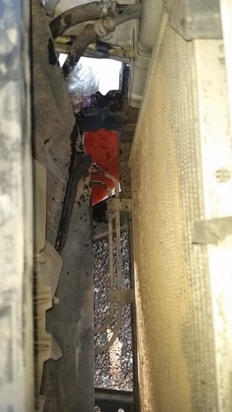

    Attached are some images. You can see the hole near the cap in the images with the tape measure. I should note that the redness of the fan and the radiator surface does appear to indicate a coating of Toyota Red that seems to be more baked on than just spewed upon. So, I'm wondering a little about possible leakage around the water pump now. Note that the very last image was taken shortly after it broken down. I did notice some gray sludge around the rupture. Does that hint at anything?
    Any suggestions would be most welcome! I have to decide if the $100 tow is to my house or the toyota-lexus repair shop. That's my immediate dilemma.
    Thanks!!
    Mark

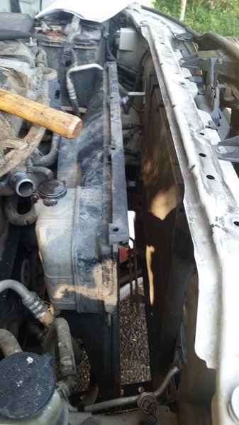

    I knocked out the radiator replacement in a couple of hours, no problems! One point to note, though, at least with my 2005 4X4 Taco, it was not necessary to remove the fan and fan shroud (as the FSM procedures outline). 20160721_162713.jpg 20160721_162717.jpg 20160721_162730.jpg 20160721_162733.jpg 20160721_162746.jpg
