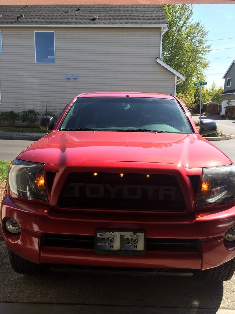

    looks good. How did you mount the outer ones right there? Isn't that where the grill mounts are. In the way? Or did you do it different. lemmme know.
    Pro tip.. when blurring out license plate don't forget the street signs in the background ;)

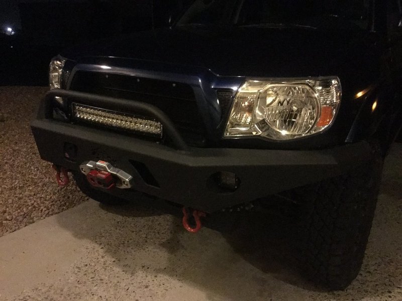

    Made a 24" angular aluminum bar which mounted the LED"s and zip tied on these bended parts of the mesh.;)raptor10_f5133f48c8ab0a73fc2b0725eaf1ebc80860c9a8.jpg

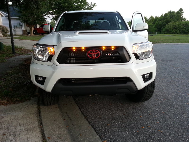

    S.O.S bolt-on sliders, XB Morimoto fogs, bumper mounted 20" led bar, amber leds in grille("raptor" style) and Relentless fab hi-lift mount. Plastidip?
    20150516_200156.jpg Put some ambers in over the weekend and added a lil TRD badge to the front (that I'll probably paint white along with the Toyota emblem). Ambers are connected to DRL's so they blink with turn signals and on lock/unlock.
    They are off when headlights are on

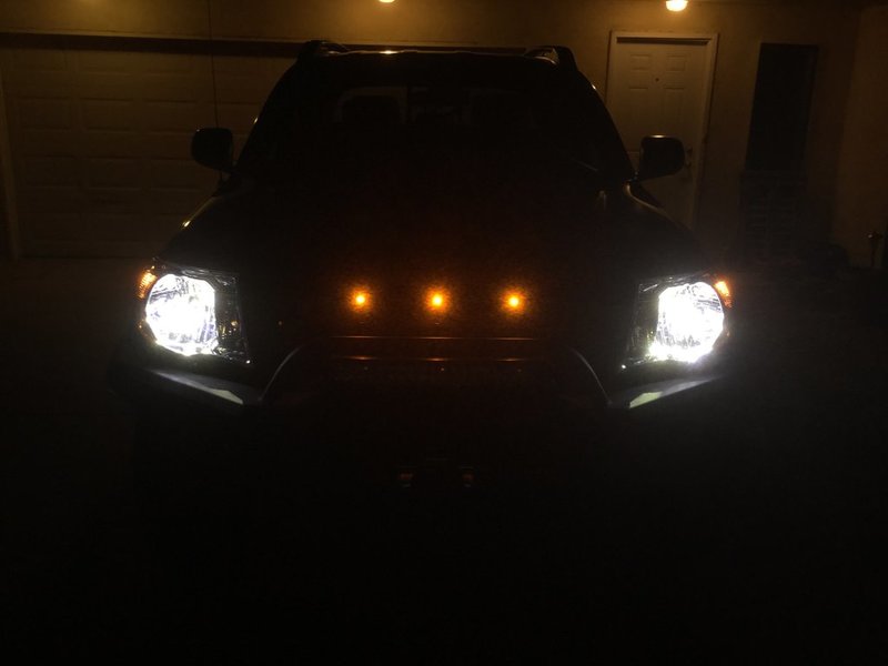

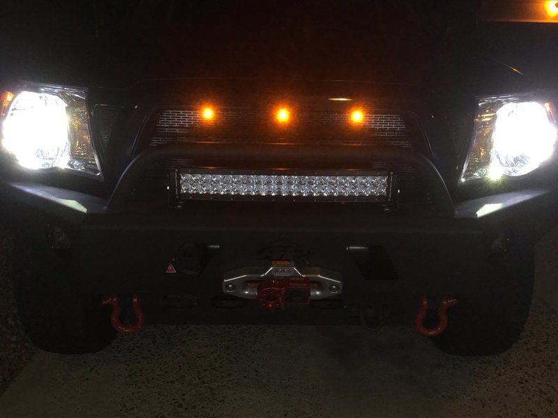

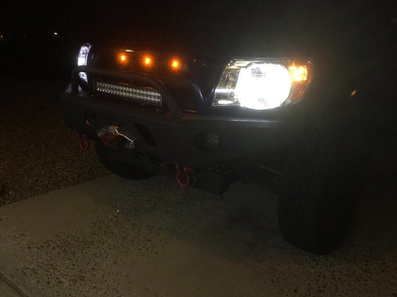

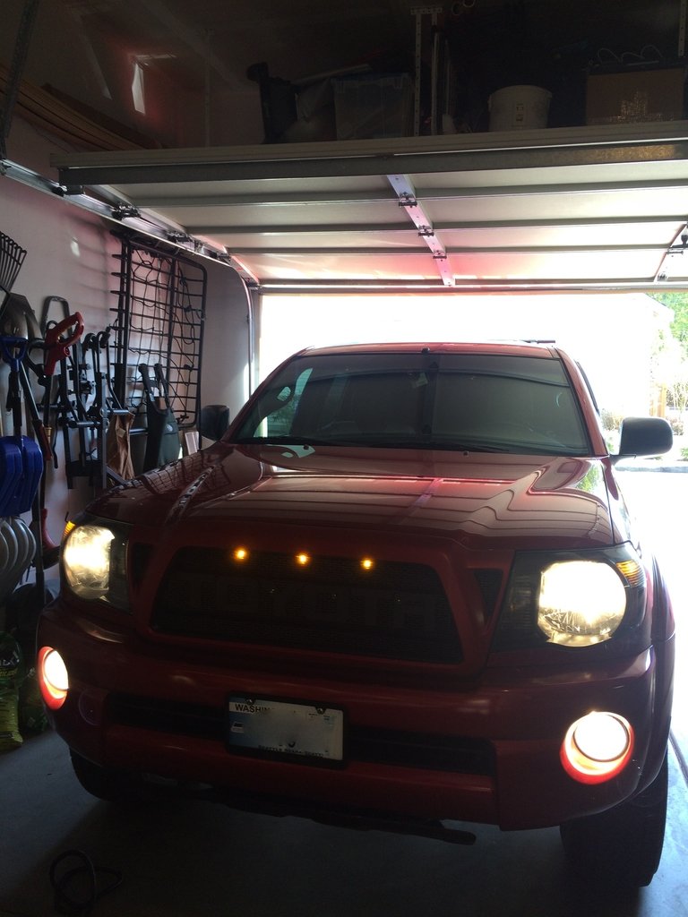

    Finished my Satoshi grill last weekend. Installed it and wired up the "Raptor" lights tonight.

    Nice job. Looks good.

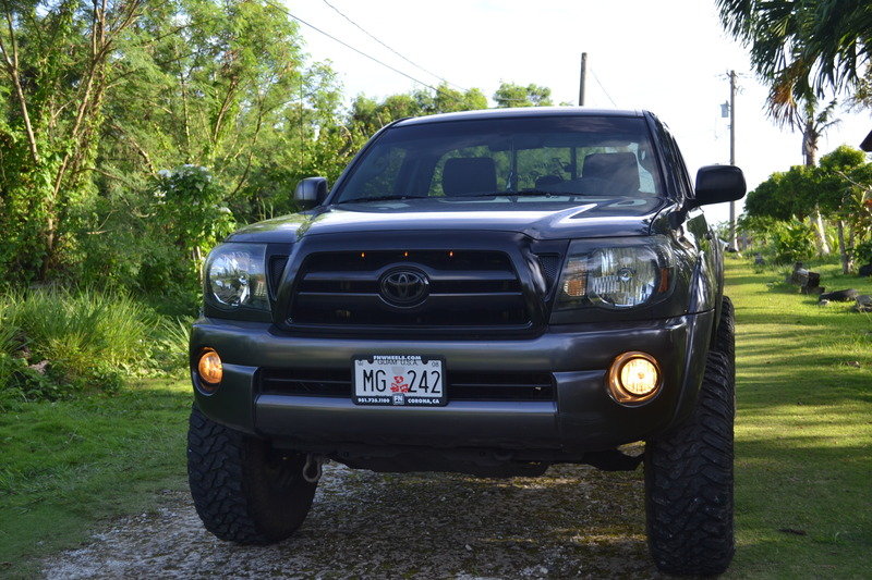

    Came across this thread and thought it looked pretty cool. leds were pretty cheap so why not.
    tapped mine off of my aftermarket fogs so i could switch it on or off. I usually leave my fogs on all the time even during the day.

    what wire do you tap into for it to come on with the brights? or is that not as easy peasy

    These pictures are sweet! And just to clarify....what do you need to tap into for them to stay on when headlights are on as well? So they are on with DRLs and low beams

    For "on" wit highs only: Using a fuse tap in the main fuse box under the hood, tap into one of the highbeam circuits left or right. Then they will come on with the brights.

    The parking/corner light wire. It should be a light green color
