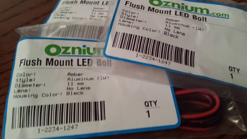

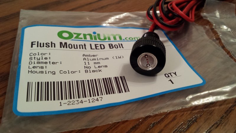

    (NEW) I have 3 of the Oznium flush mount LED bolt lights for sale .. they are AMBER light color with black housing. These are the 11mm diameter (1w) with no lens. They are waterproof and have 3' of wire to make easy connections
    $15 shipped conus for all 3

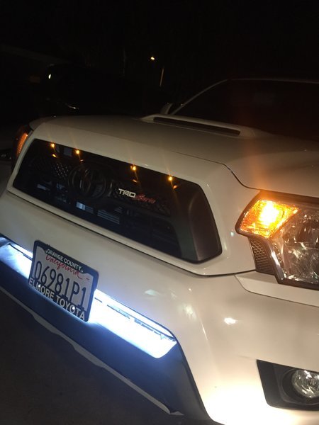

    Ok, I just doubled check my truck. My blinker (drl's) lights stay lit on every setting. Not sure it this is supposed to happens. In the picture my lights are on the headlight setting. Obviously my headlight are running as well the side markers, but also the drl's.

    These are the ones I used, and to tap in to the wires I just used the 18-22 gage wire tap. I hope this helped you out good luck, this is one of my favorite mods I have done.
    https://www.amazon.com/Solderless-W...=1478087725&sr=8-1&keywords=18+gauge+wire+tap
    https://www.amazon.com/Schottky-Dio...ell&keywords=schotty+diodes+rectiffiers+3+amp
