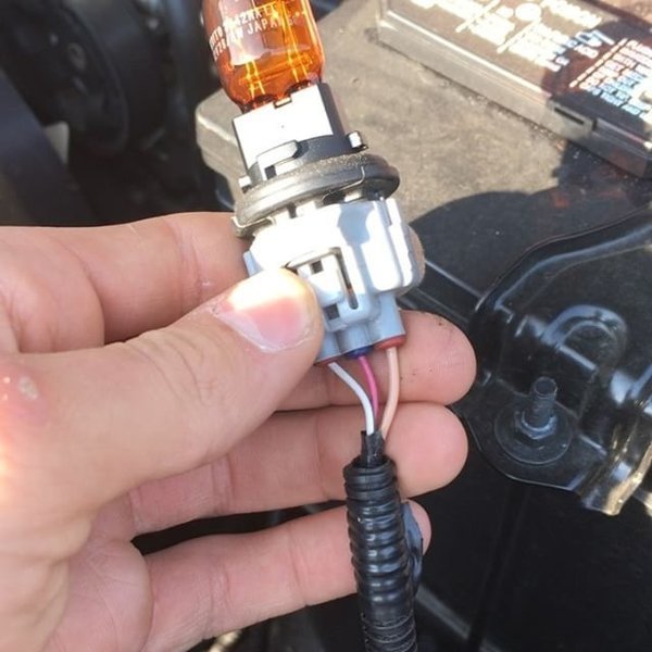

    IMG_0030.jpg What wire of my DRL do I tap into??? I have everything else completed

    I'm not 100% sure your wires are different then mine, my advice would be to use a light tester.

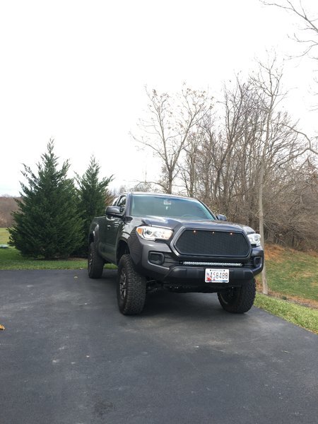

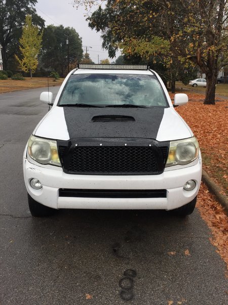

    IMG_0038.jpg Do you guys think I should move my lights closer together or leave them spread out like this??

    Looks good to me the way it is.

    Agreed nice job

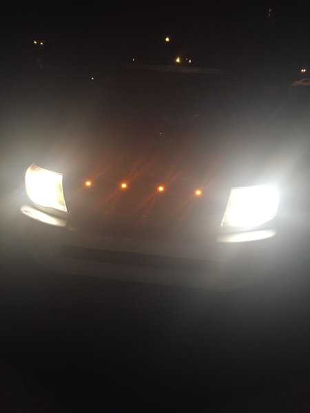

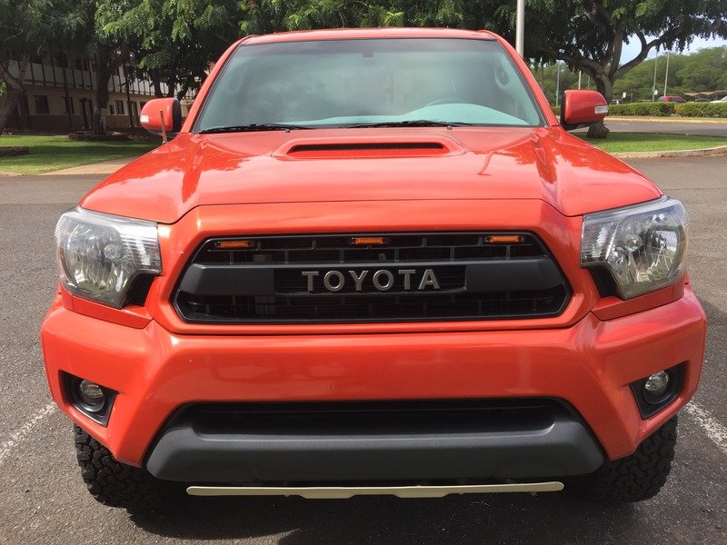

    Used these from Amazon for my Raptor light mod. Love the way it came out, subtle but not overly bright.

    Adio - can you show some pics how you mounted this to your pro grill? I have the same dilemma....been trying to figure out a clean way to do this. Shootz, mahalo bro.

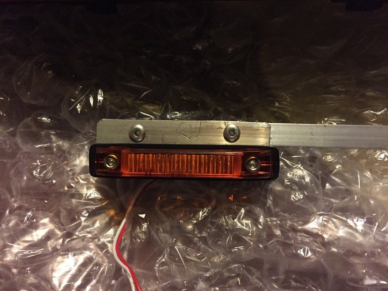

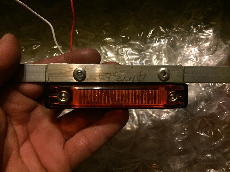

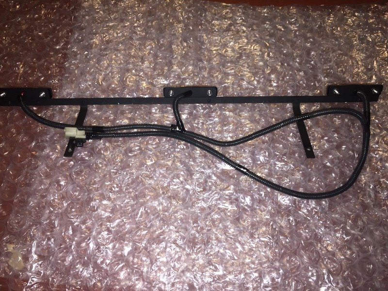

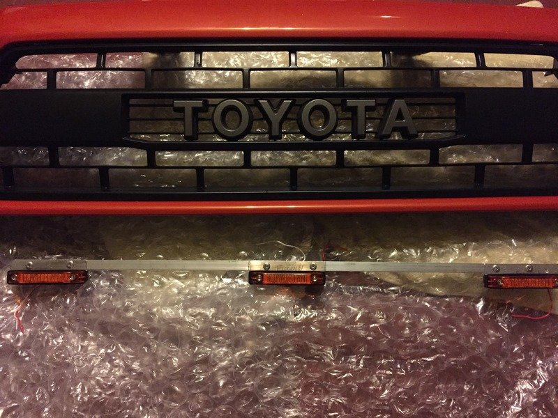

    I made a bracket. This is what I came up with. Kind of overkill but I wanted something stealthy and stock/clean to look at plus didn't have to drill onto to that Pro grille. There's only one slight trimming that I did(see below).
    D041C3A4-A1F6-4421-96B6-32EDA6C19030_zps_732a889b19d65b43b43c47f55fbe6c9406f2ffd5.jpg
    How each light is attached.

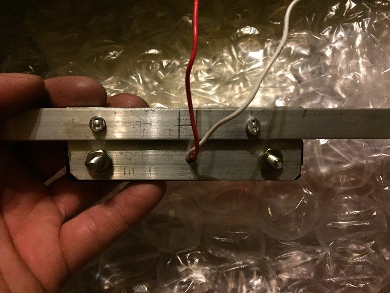

    D0ED8482-7983-459D-BF32-28F68638A3F8_zps_ab4b8a59d8cad7df39cc1cb5cec79b33e30b46ec.jpg
    0B7984D2-5207-46CE-B0F8-8FA0AEE8EEED_zps_8b67194b48c83fb5ab67ea49ba7d504f48245caa.jpg
    D9B3F78B-44B9-4FB2-9575-9F2BBA73334F_zps_0787062b483c8ccc7d6865b87493e22b8b41225c.jpg
    Final bracket. You can see the 2 vertical bracket from it that'll attach to 2 existing holes on the grille. If you look closely at the grille, you can see the notch that I trimmed(top, between the Y-O)
    4A82BF68-C04E-4084-B815-622617BD98ED_zps_db2ef2f1349624dd48df763c9e8ab6a9d8596b0c.jpg
    Painted it flat black. Installed the wiring with a connector.
    2C64EA5D-0DF3-4764-A48A-8131AD133DB4_zps_905aef10f4ab705fb16eb6f5965393a2c9158dc1.jpg
    7D3A23D8-62B0-4434-AC70-BA534A603DCD_zps_17f56f60c850a5159d791d4f9bb42f6e4facdd7d.jpg

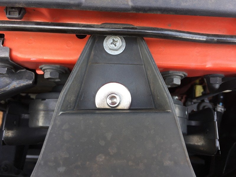

    Existing hole that's used to attach the vertical bracket. Left and right side of the grille.
    71F2636C-BFDB-4BC9-A591-A7A199C8426B_zps_0da3a7c9bfe7a45f051d7cc89462a44a52492753.jpg

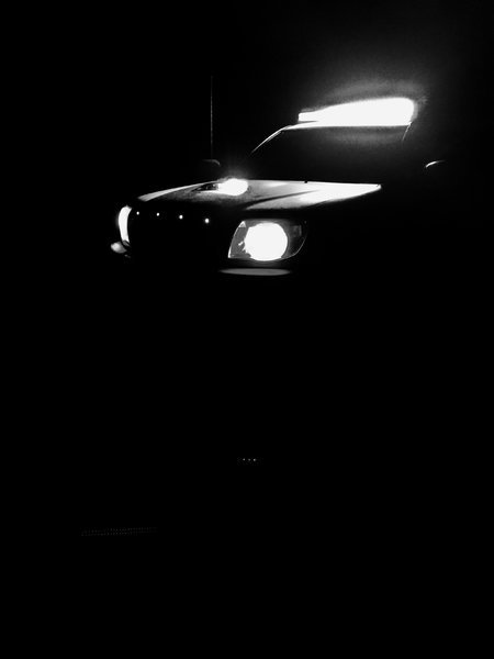

    Here's mine. It's an easy mod that really is unique and I love it
