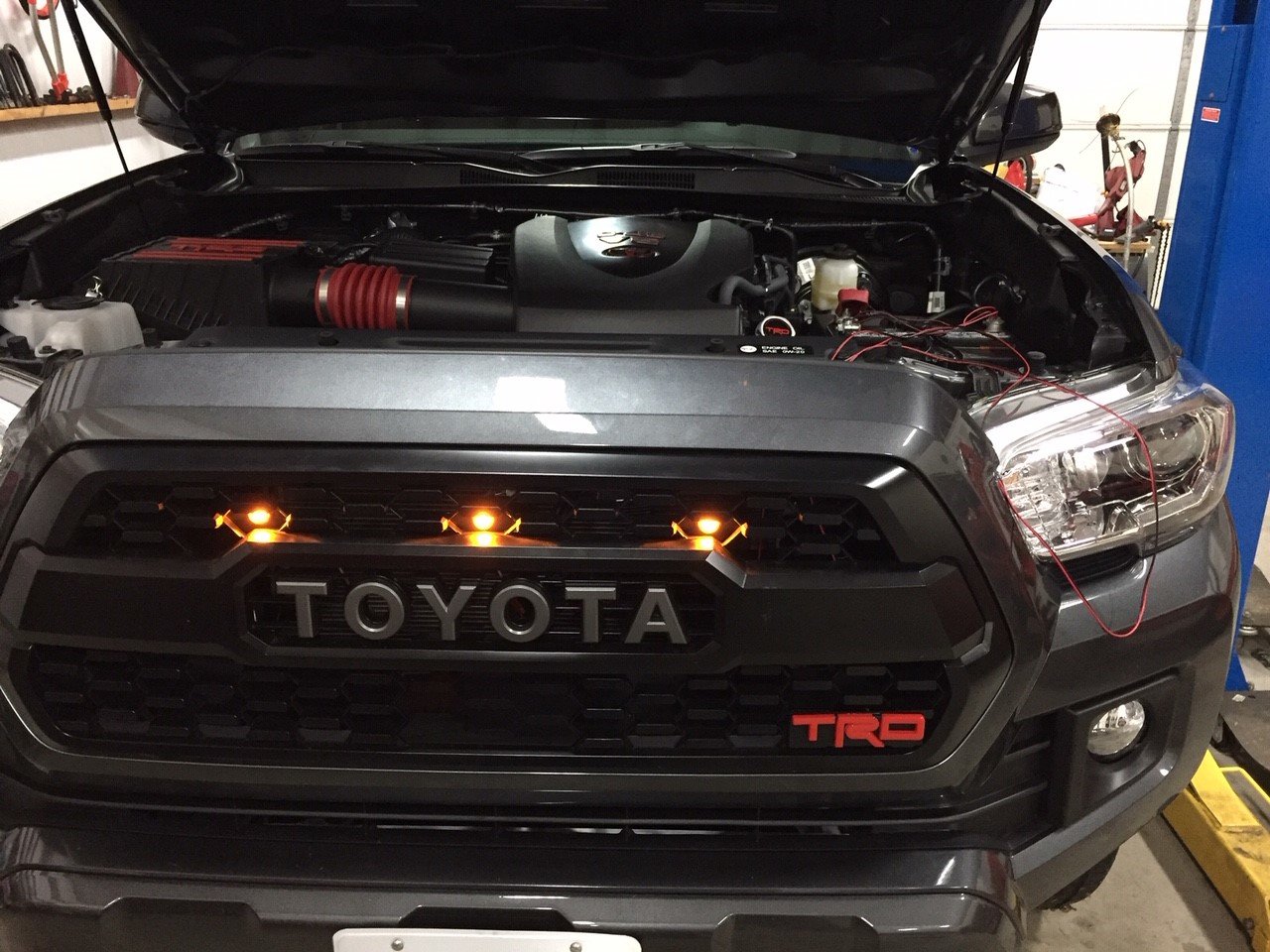

    Got mine installed today!

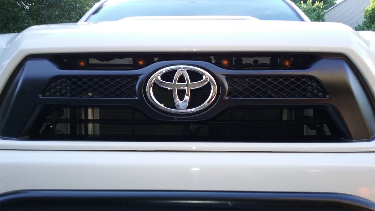

    King 2.5 Ext. w/ Compression Adjusters (Front & Rear), Dakars w/ D29XL, TC UCA's & LCA's, ARE CX, 17" SEMA Pro's, 265/70/17 Falken Wildpeaks, BORA spacers, Rigid Side shooter ditch lights, ATHF bedside reinforcements, OME carrier bearing drop bracket, extended rear brake lines, Northstar 27F battery, Yakima Jetsream crossbars, OEM roof rack, OEM skid plate, TRD Pro grill, URD TCAI, 5.7L Throttle Body, BensonX bedside tool mounts, fire extinguisher bedside mount, AMP research bed step, Redline Tuning hood struts, ECGS needle bearing mod, CV Boot slide mod, Differential breather mod, U-Bolt Flip Kit w/ Timbren Bumpstops, A-pillar RAM mount w/ cell phone holder, ProFX tow mirrors with turn signals and heat, "Raptor" lights, DEPO taillights, motorized Pop n' Lock

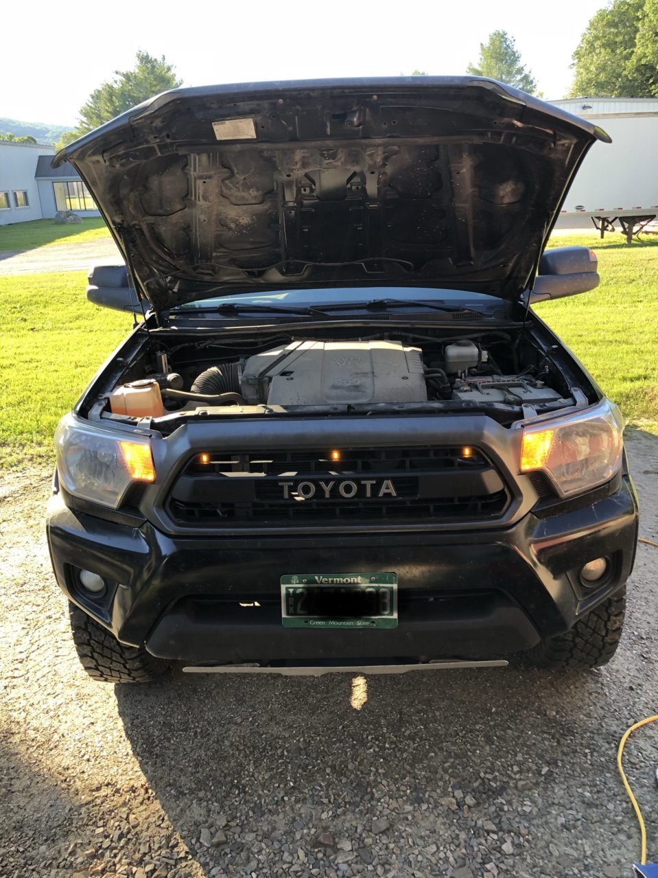

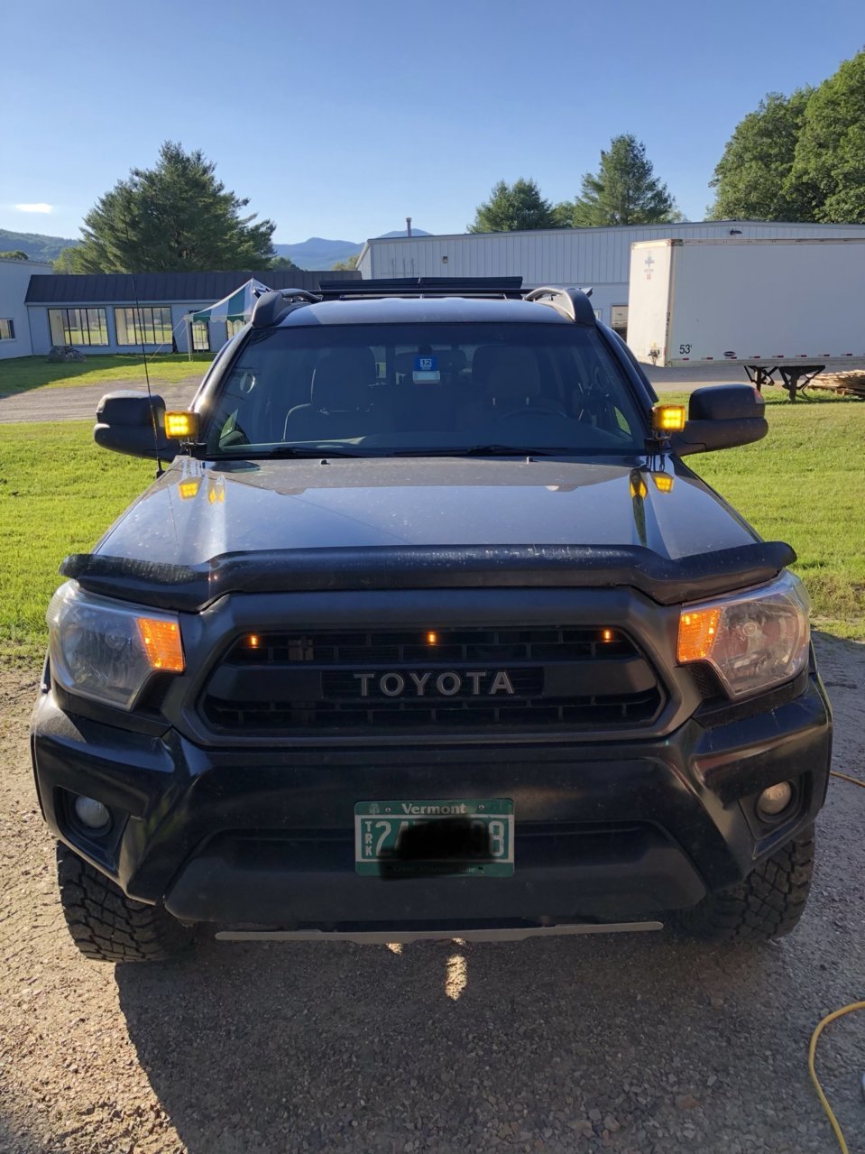

    Got my “raptor” look completed today. Shout out to @TortyB on the superbrights recommendation. They match the OEM ambers perfectly!

    @MadRiverTaco, how did you mount them with the Pro Grill? Any details / Picts would be appreciated

    I didn't take pics of the install along the way due to a time constraint. But I started by measuring and drilling the 2 holes on the sides. For the light in the center, I used a Dremel to remove the piece of the grill that the light would replace.
    After I got all 3 of the lights mounted, I spliced them all together and brought the positive wire (red) to the add-a-fuse circuit and then grounded the black wire to the engine bay of the truck. I used a 10 amp fuse for the raptor lights because it was the smallest I had, but I'm quite confident that these don't need more than 5 amps.
    Tested the setup to make sure it worked (it did), then ran the 1/4" wire loom throughout and dressed it up nicely with tie wraps so the wires weren't visible looking head on. I spent a little more time on this than I wanted to, but I'm an electrician and a bit of a neat freak when it comes to wiring. I'll get some pics of this soon.
    All in all it was pretty easy to do. The hardest part was drilling the holes in a tight space. There's not much room to work with whether you have the grill on or off the truck, so be sure to take your time on this step if you decide to do it.

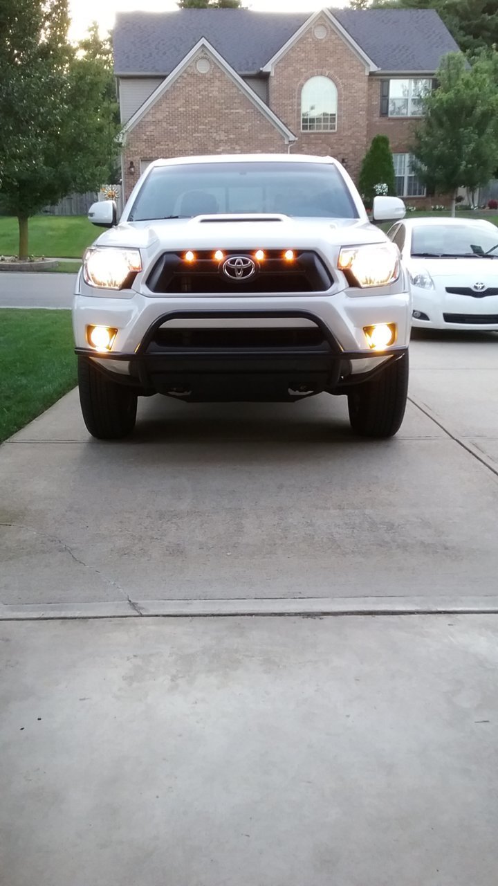

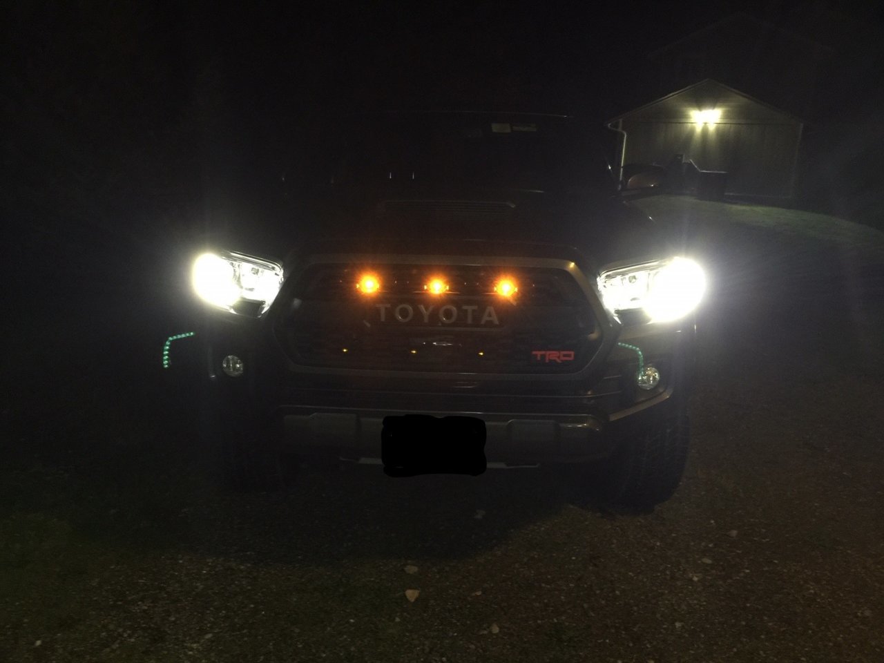

    Yeah, I wanted something different than the bolt LEDs that others are running. Nothing wrong with those. Just wanted something a bit more unique and much brighter.
    I tried getting some night shots.....but they just washed out my camera.
    This is them running on a 9 volt battery. So just imagine 3 more volts running through them.

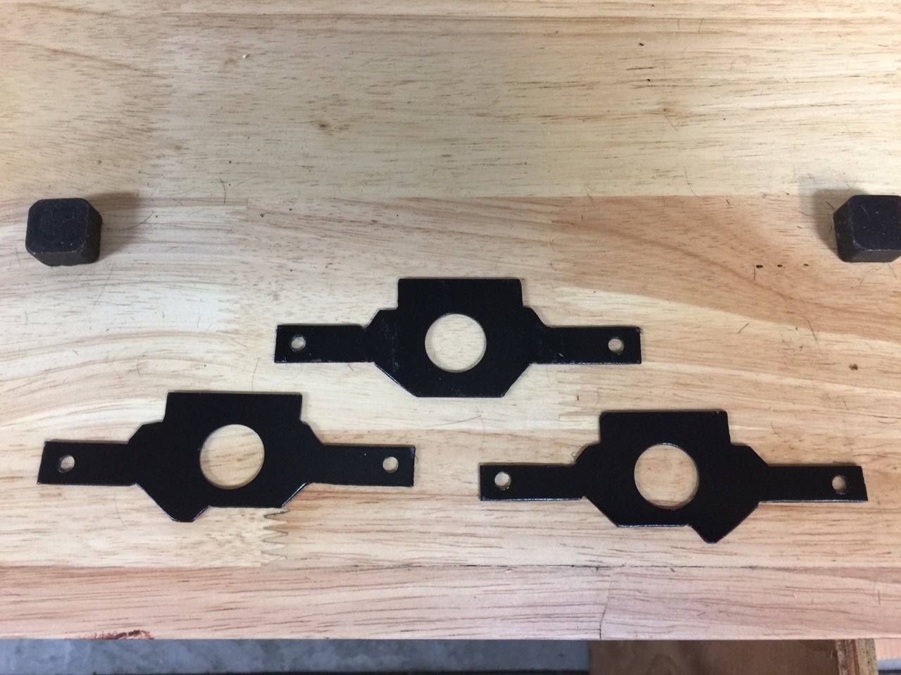

    Made some custom mounts for them. All the wiring is completely hidden from view.

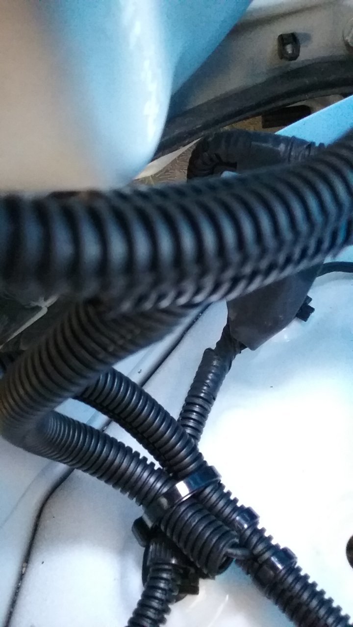

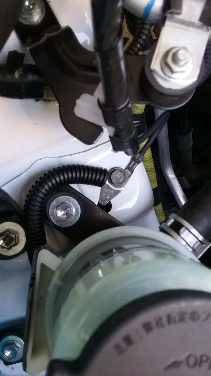

    They're juiced off the passenger side marker lamp. I'm a little anal about wiring. So it may not be obvious. But it's the the connection running downward from the factory loom...kind of forming a "T".
    This is the ground, located at a factory point.

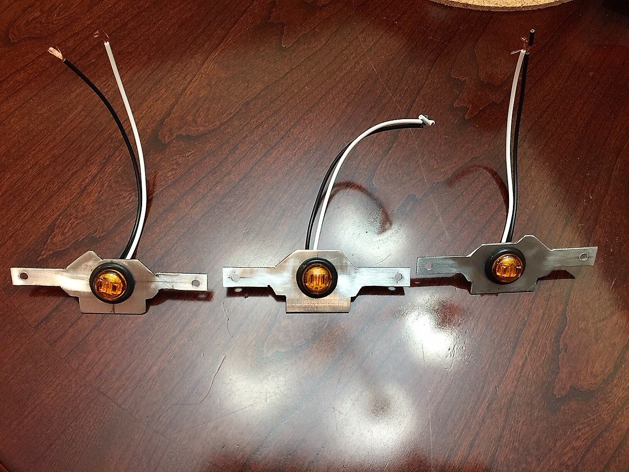

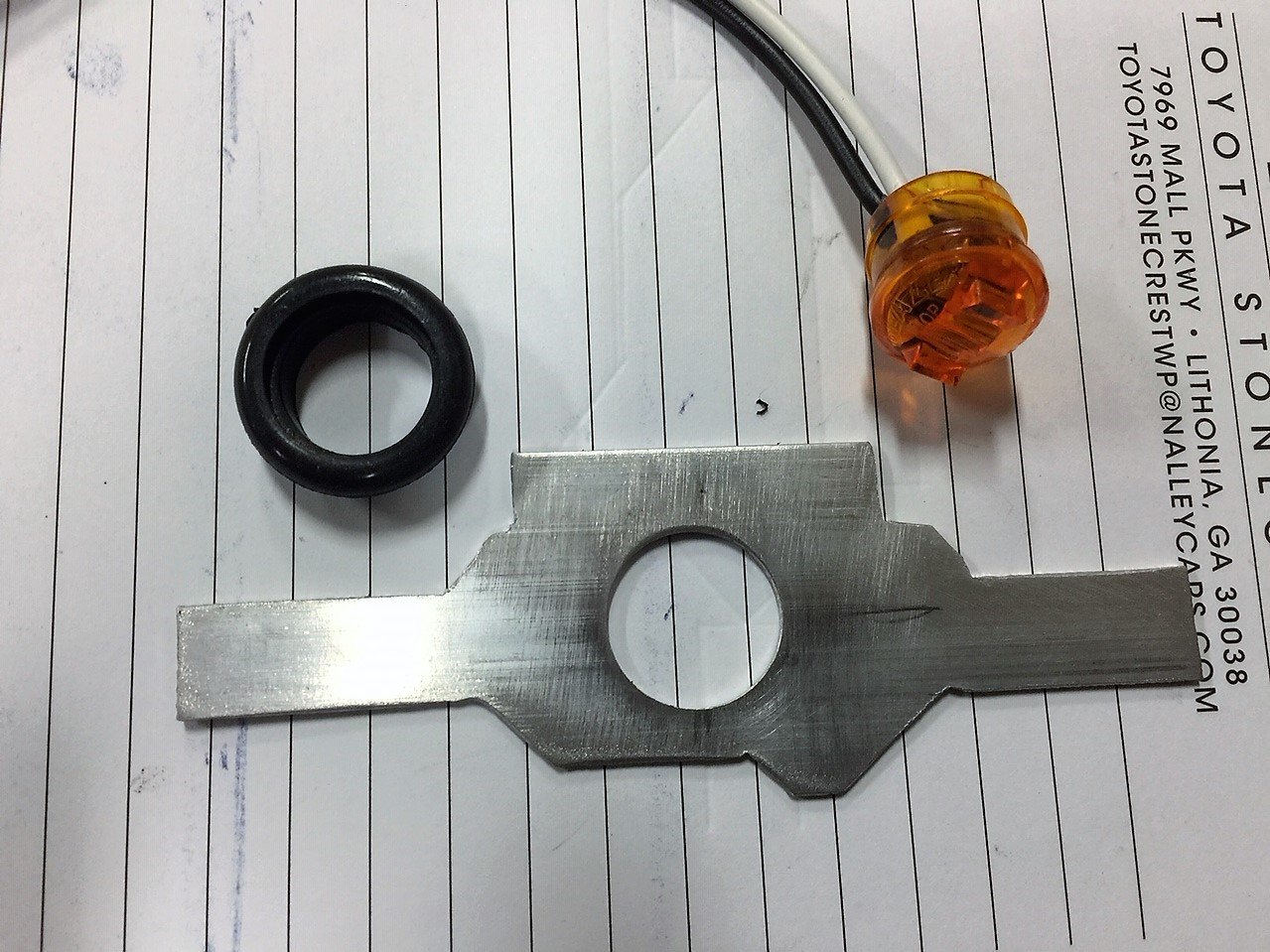

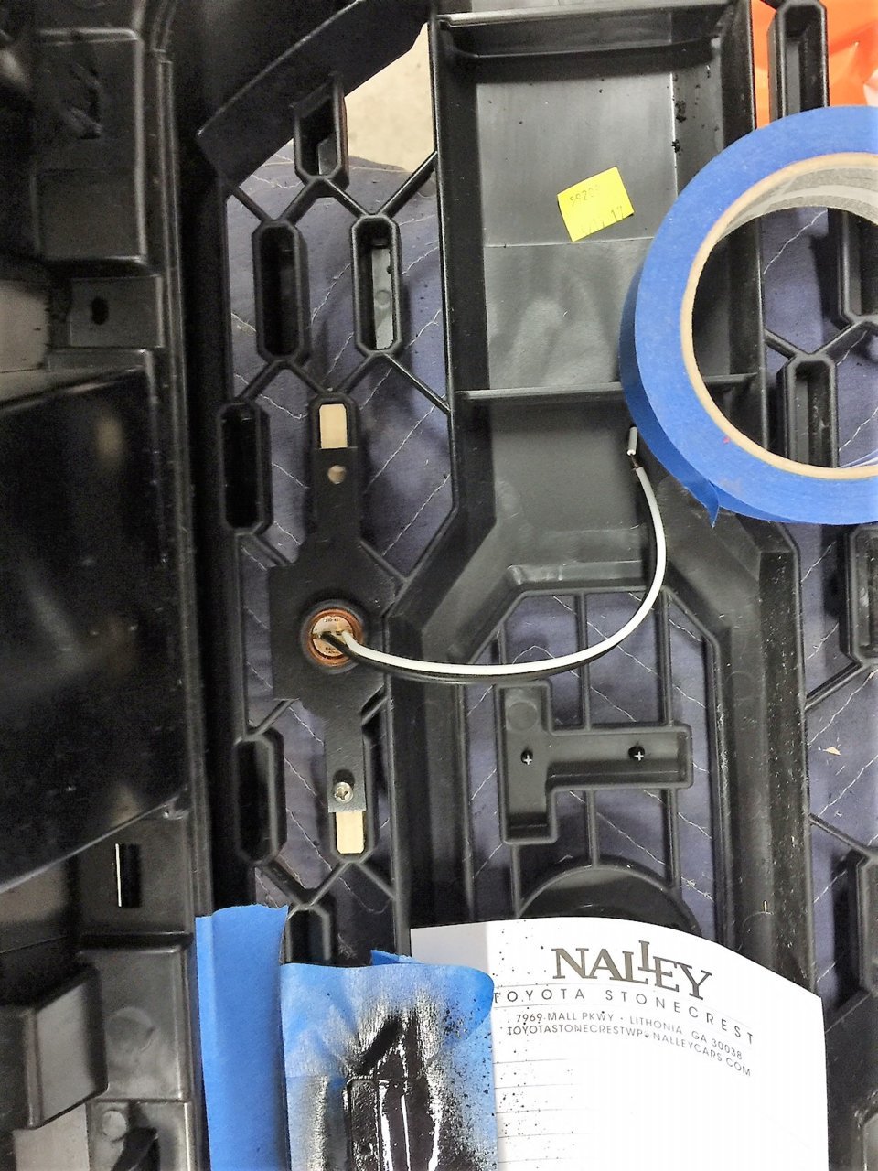

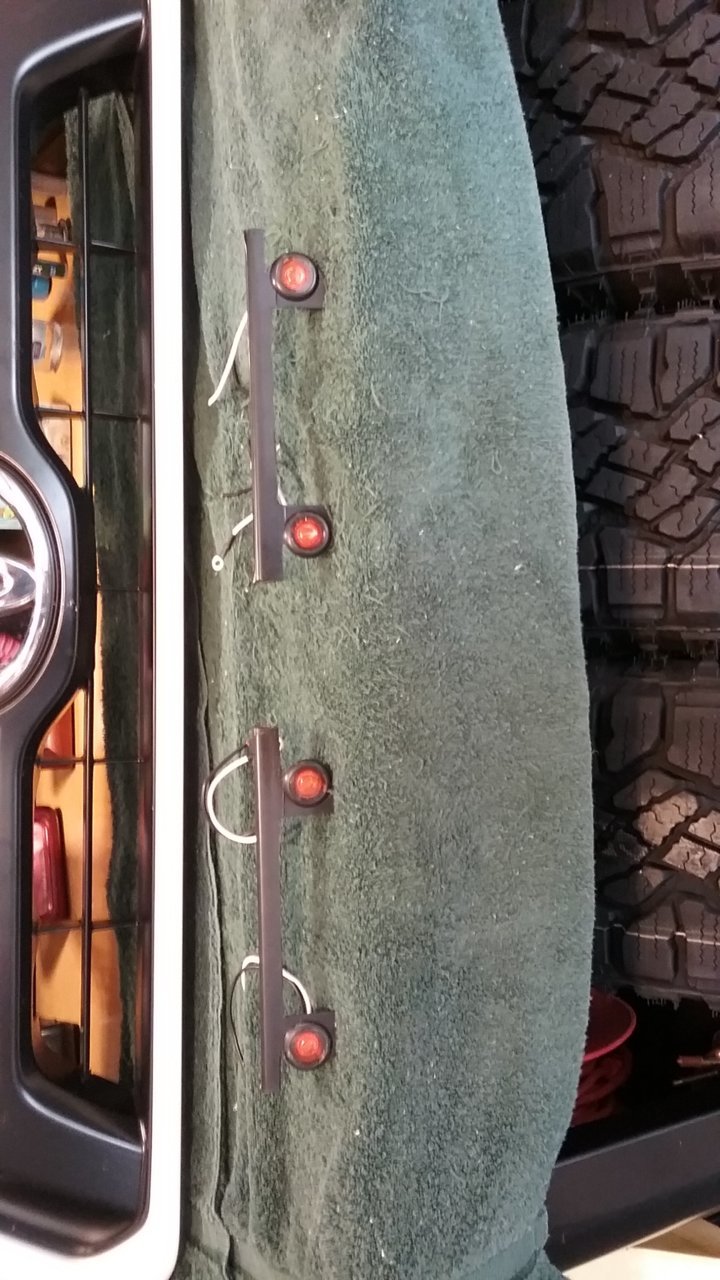

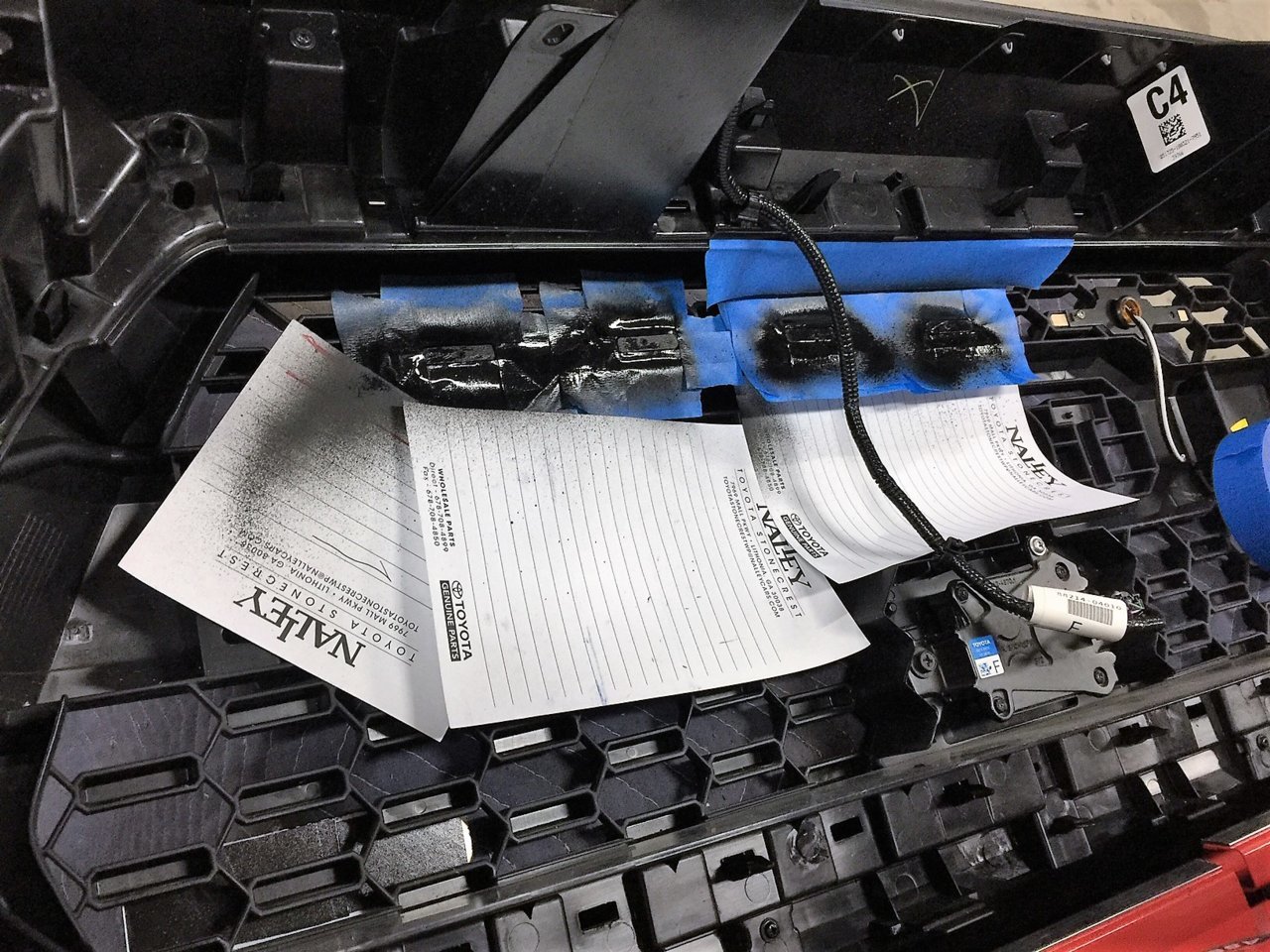

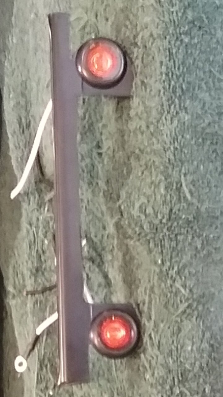

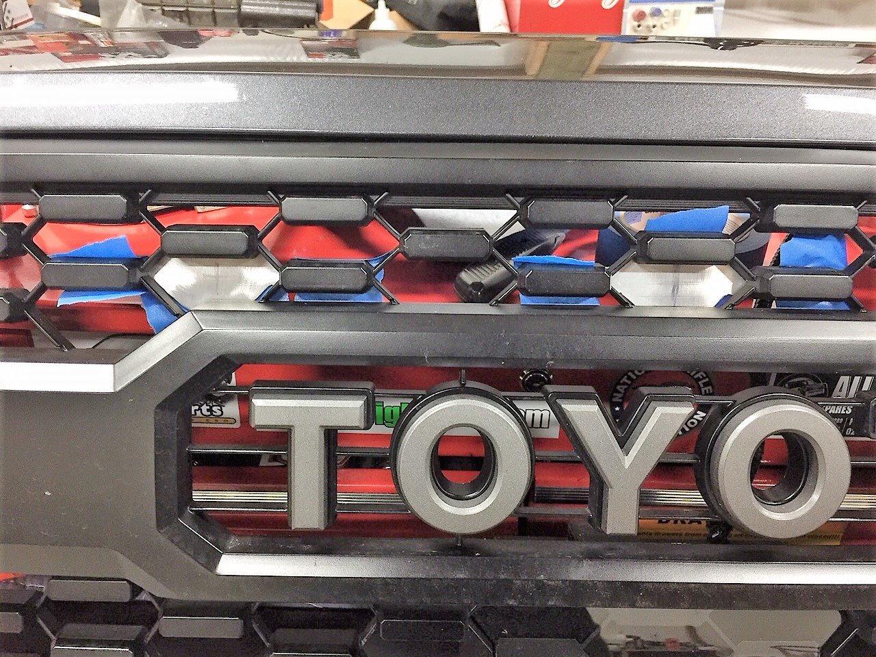

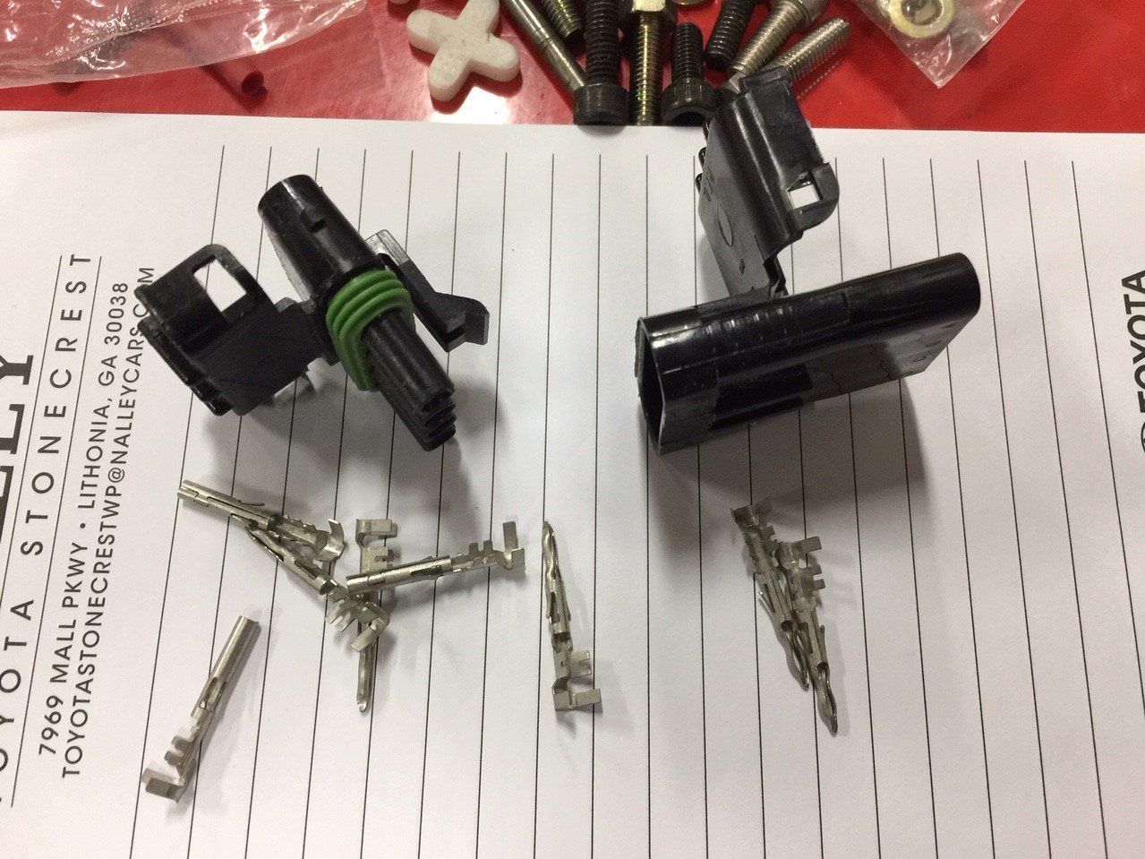

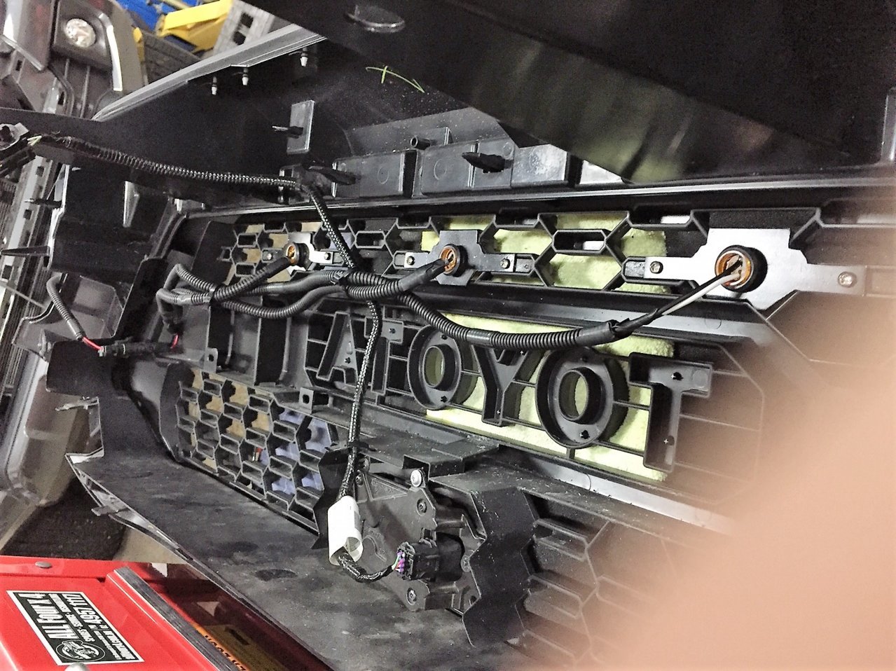

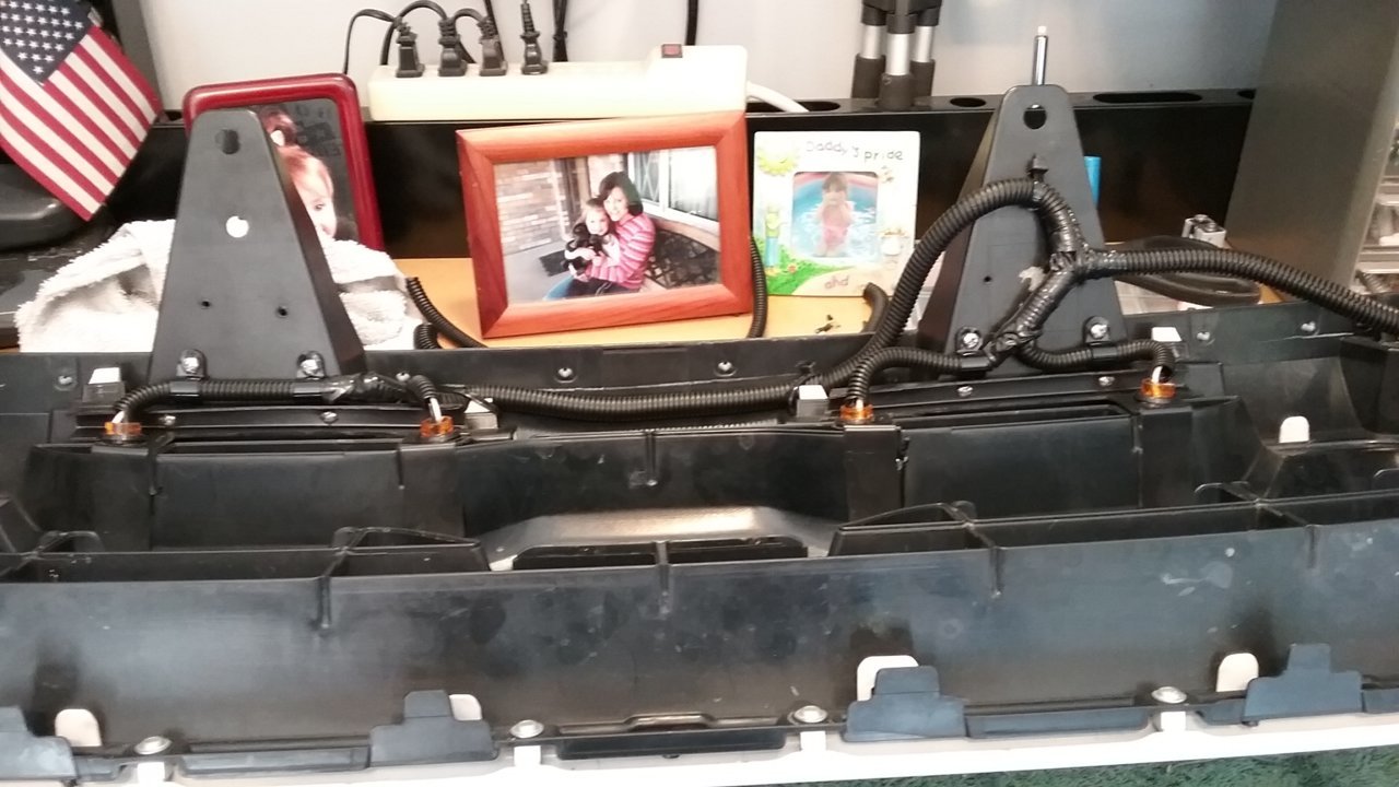

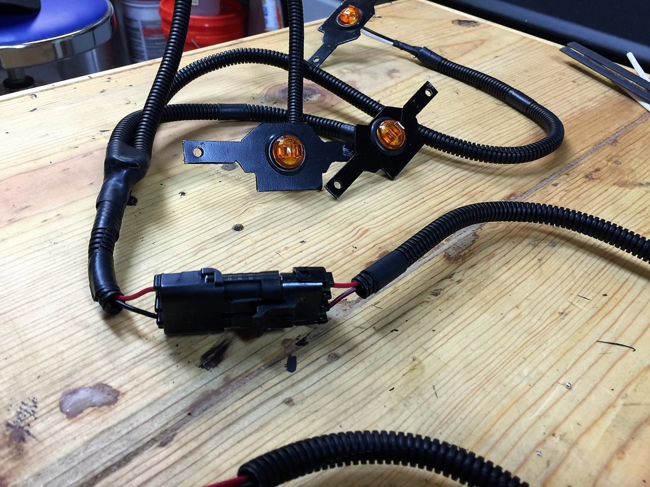

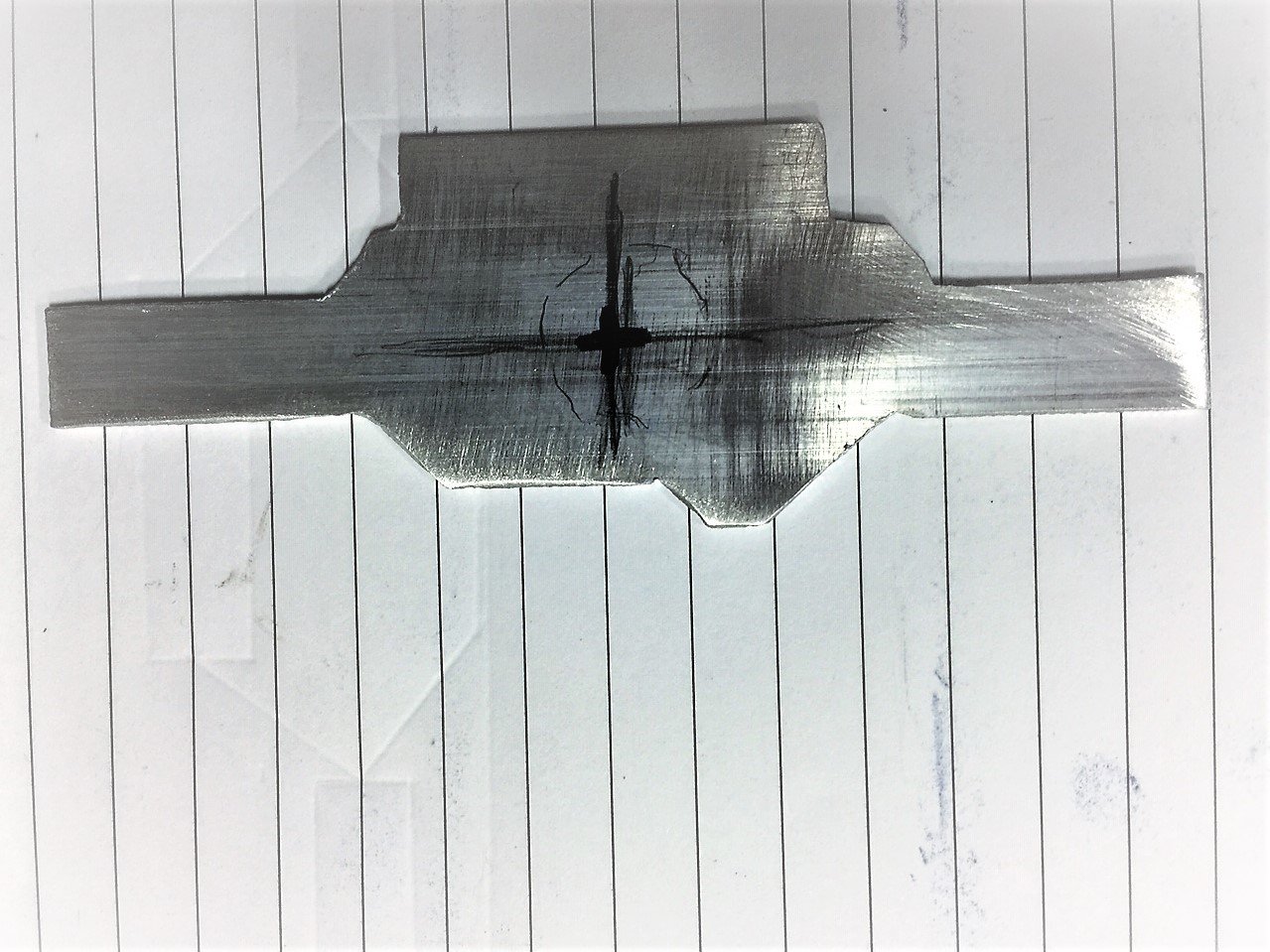

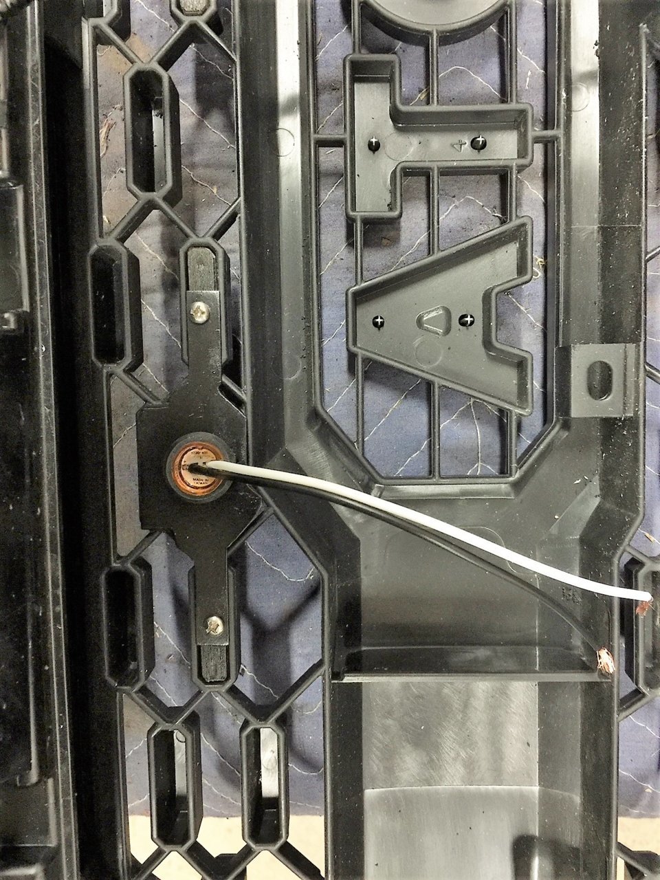

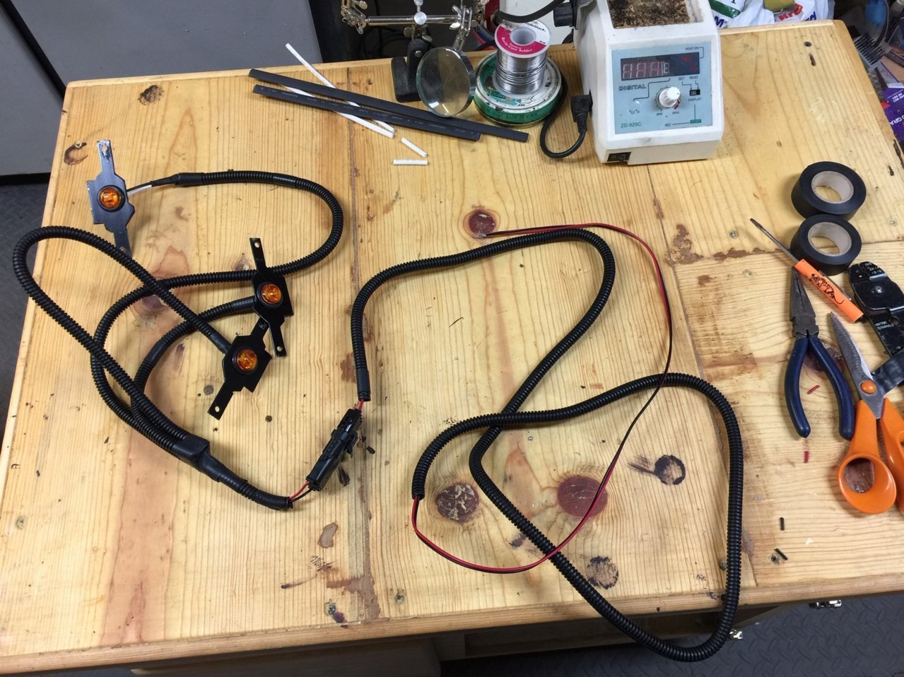

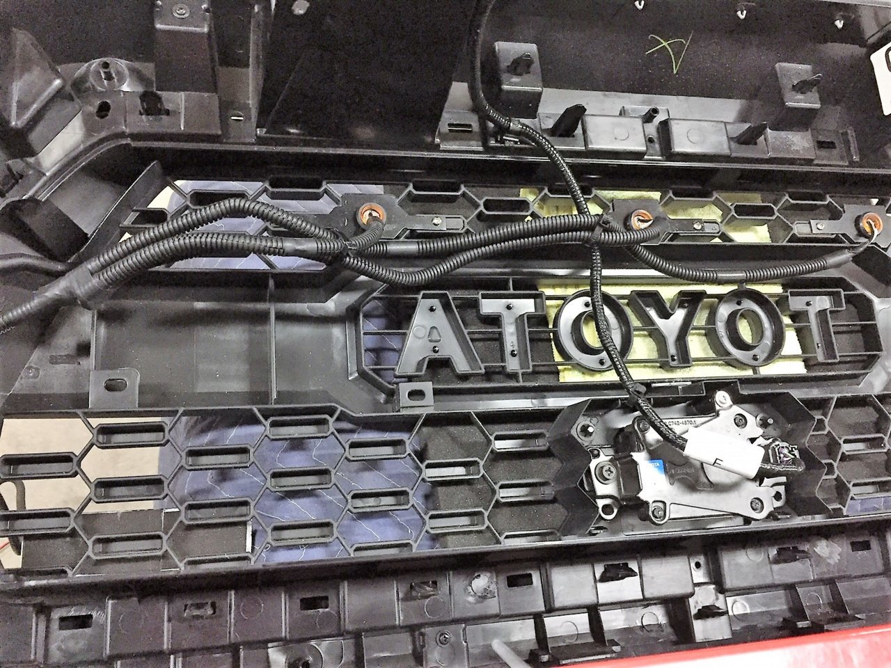

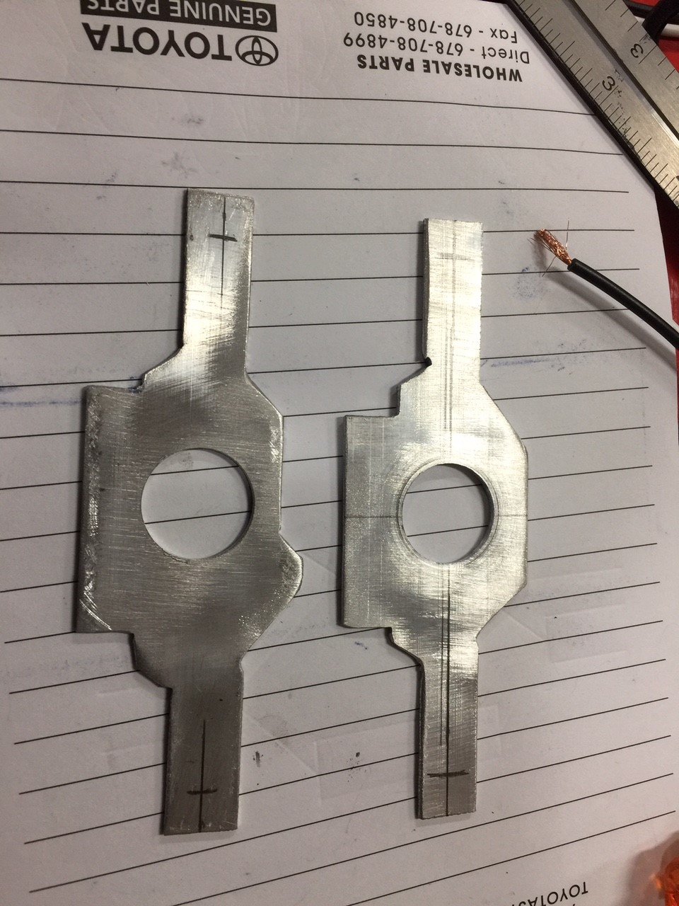

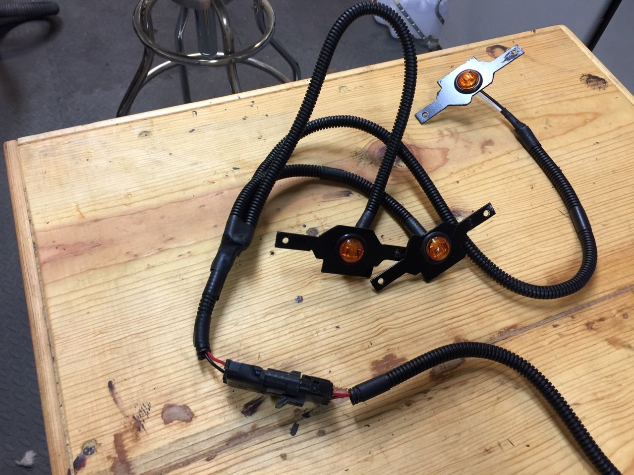

    Here's my $15 dollar Mod, yes $15.
    I purchased a packet of 6 LED grille lights from Autozone. The wiring and loom were leftovers from my bed lighting, and aluminum strips leftover from FJ40 project including the waterproof connector.​
    Here are pics of the fabrication and installation process:
