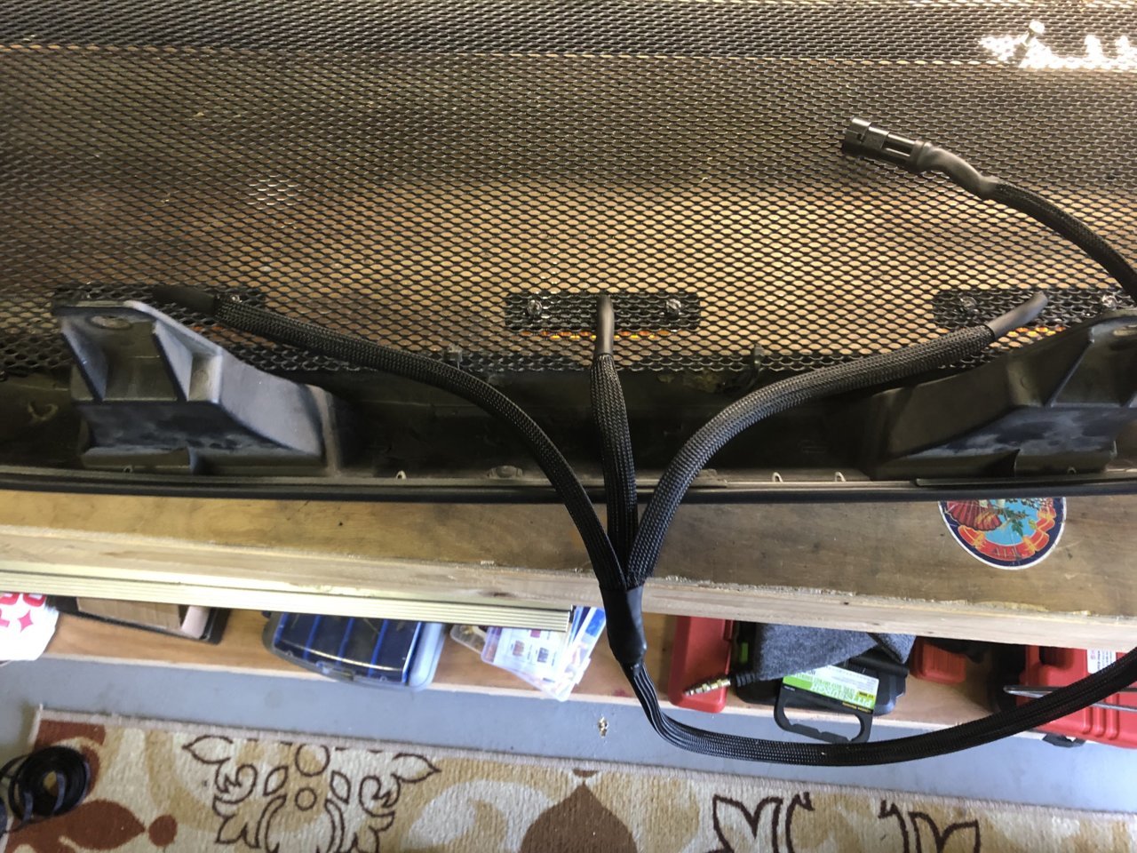

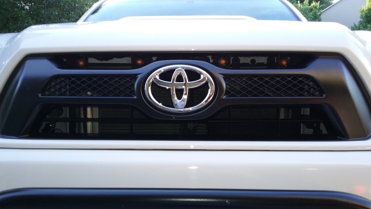

    i did the bar lights @adio did back on page 25, but i only did a couple of them
    TortyB and Plain Jane Taco like this.

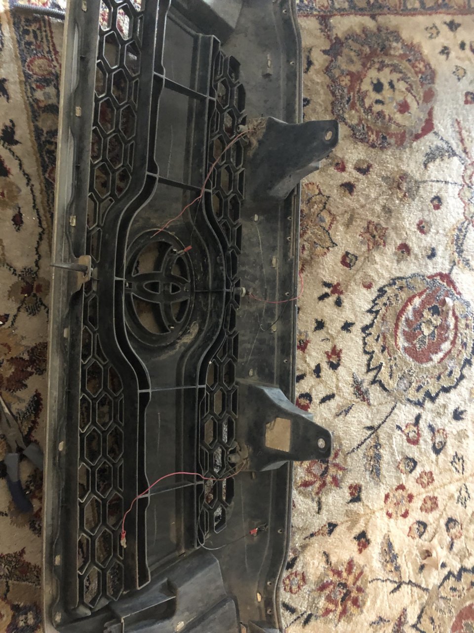

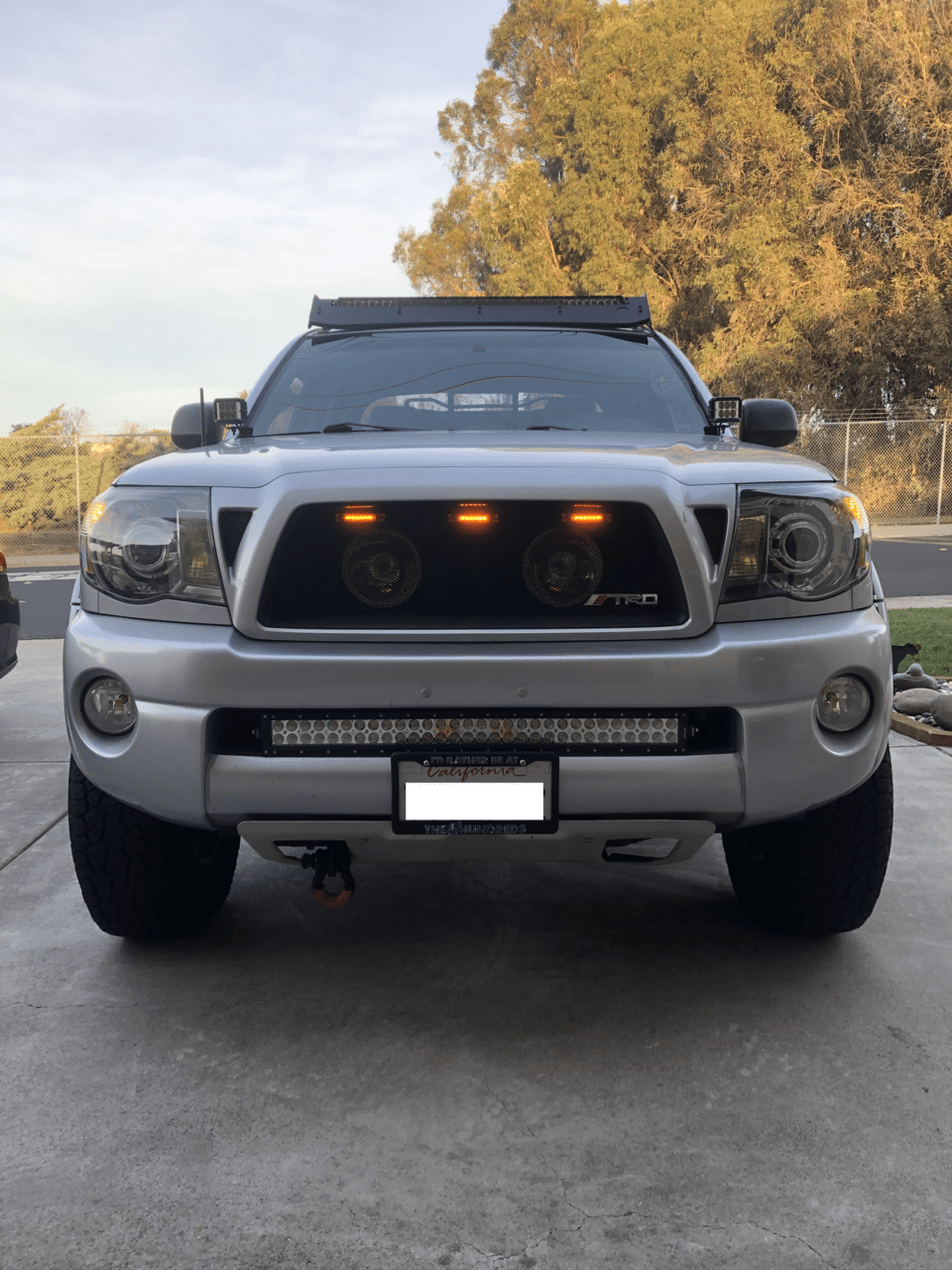

    Looking for some help with power source for the Runnin4Taco lights. They had them running to the headlight 10A fuse in the box with an add-a-fuse, but I would prefer them to operate with the LED DRLs.
    I tried the DRL and Fog 10A fuses, but they were giving constant power (even when DRLs/vehicle were turned off). The headlight fuse worked well and only supplied power when the headlights were turned on.
    What is the best way to tap into the DRL lights?

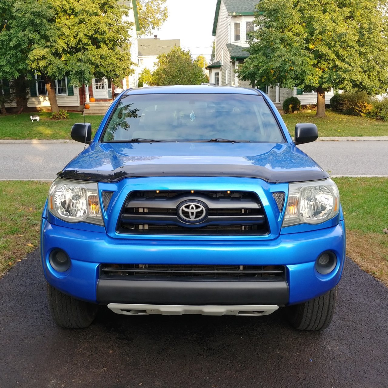

    For those with a 2005-2011 grille before the small refresh, I have a few questions:
    1. How did you install 3 lights? My grille has a connecting tab in the center holding it together.
    2. What was your spacing between the 3 lights?

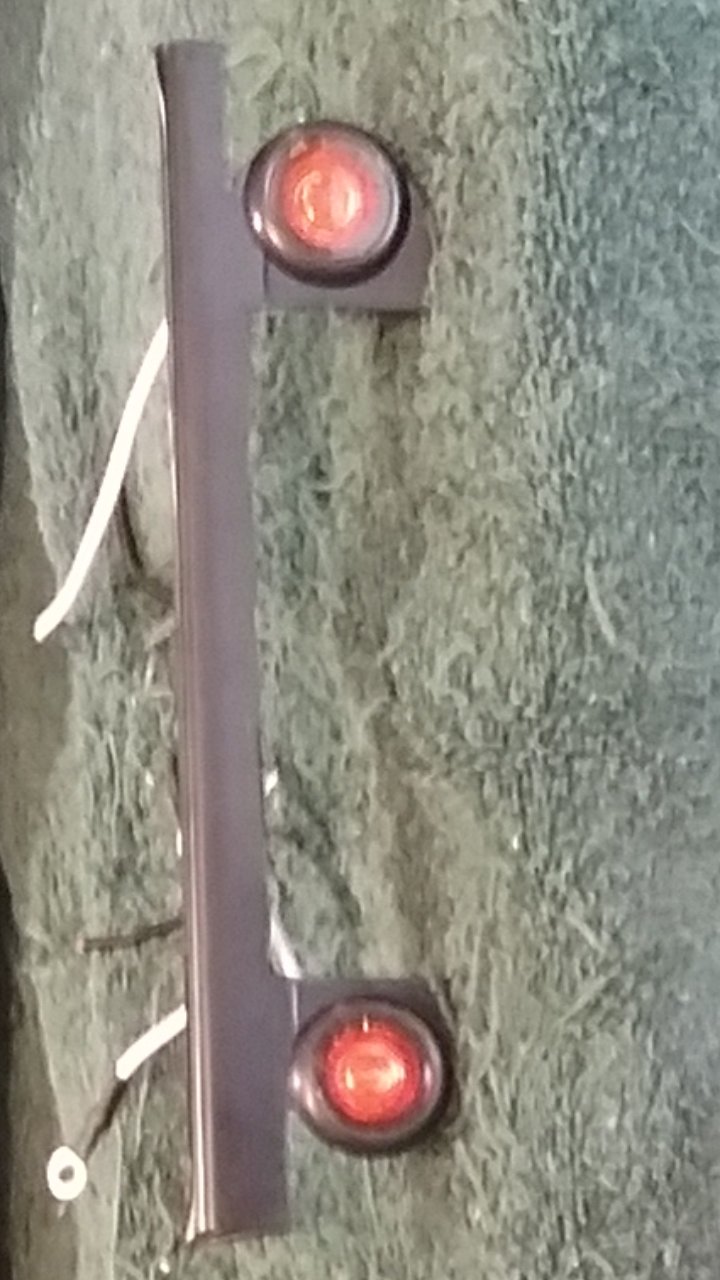

    Did you use prefab metal brackets or fabricate them yourself?
  16. Apr 3, 2019 at 5:13 AM
    #596
    Plain Jane Taco
    Plain Jane Taco Well-Known Member
    Apr 19, 2009
    #16179
    40,279
    USA
    I custom made some out of black plastic.
    DLillest[QUOTED] likes this.

    I may do this as well since my 07 doesn't have a lot of room under the upper part of the grille to drill holes to run the lights.
    I purchased (3) lights but I may have to buy a 4th one since the 05-11 grille has a connecting tab right in the center, blocking where the light would shine.
    I wanted to do this, but because of the tab in the middle, I dont think I can.

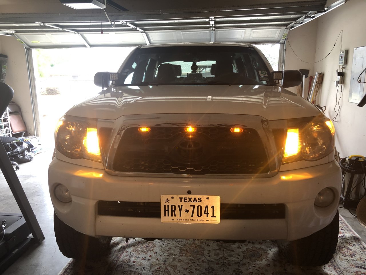

    Currently working on re-doing my raptor lights.
    These are my old Oznium bolt LED’s, they work great but are very small and not too bright.
    This is how I originally installed them for those who may wonder
    I found some Blazer 2 5/8 marker lights at home depot for $1.53. For that price, why the hell not buy 3. I just hot glued them into place, and wired them up.
    These are 20x brighter than my previous ones! Extremely happy with them, I’ll post more pics at night later.
    CC678EBF-195E-43E0-AC23-D36A010364BA.jpg 561A6CC1-3682-423D-B9F2-908BF908B8D3.jpg 399CBA6B-B8D1-423B-8E66-F69A3A36DBB5.jpg 31309ECA-C904-40F4-A792-9260F5FFA9F2.jpg
    Comparison between the two, the picture doesnt do it justice, there is a BIG difference in output and brightness in person.
