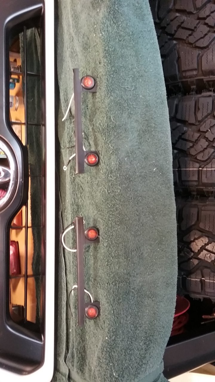

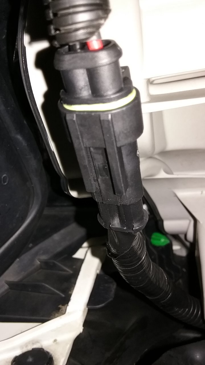

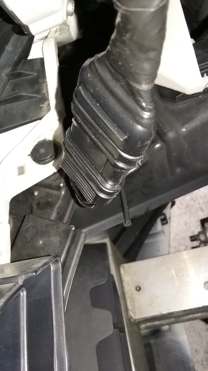

    Wanted to be able to remove my grille without cutting or removing the wiring. Used a trailer pigtail.

    So what did you do? Just used two of the wires? Great waterproof idea!

    Yep. Just used the 2 middle wires. Cut off the 2 outers
