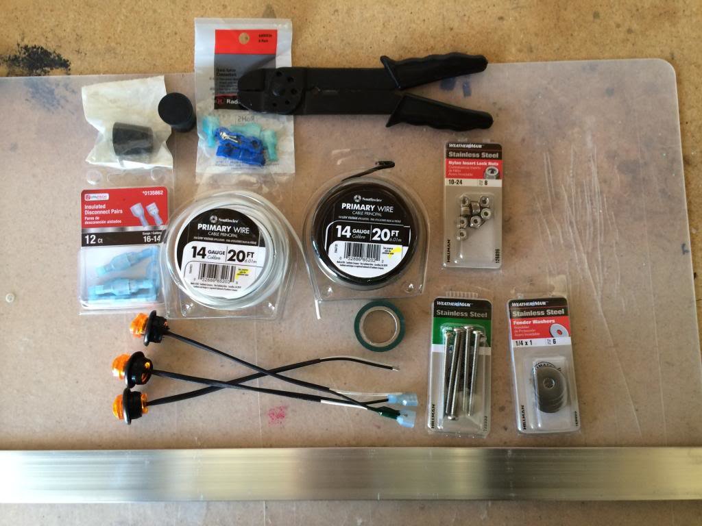

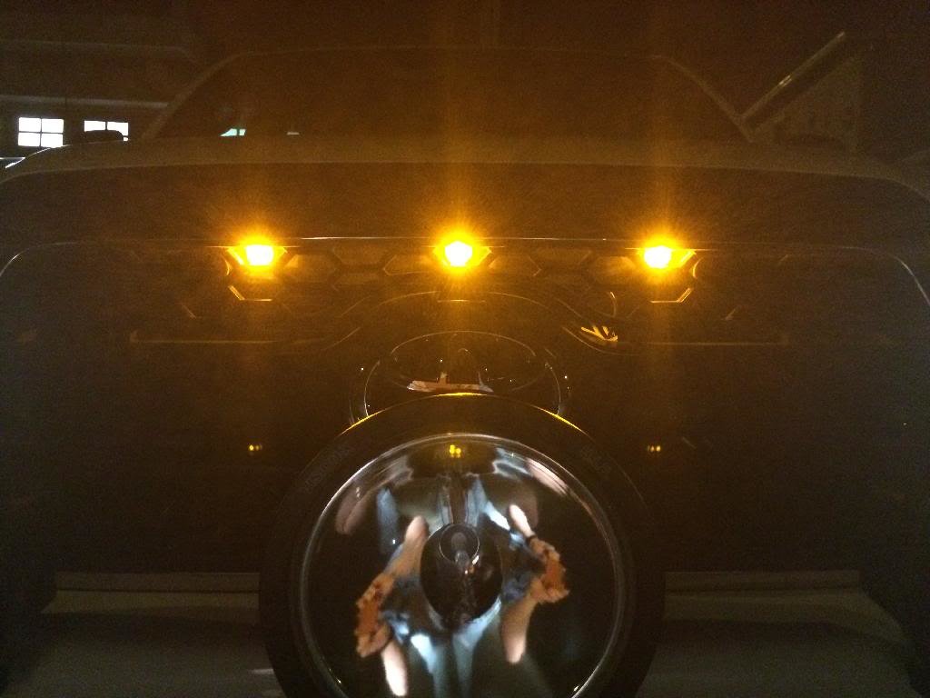

    Added lights yesterday! I used the Optronics MCL11AKBs from www.etrailer.com:
    http://www.etrailer.com/Trailer-Lights/Optronics/MCL11AKB.html
    Here are my supplies, mostly from Lowe's:
    0B0BDF25-4385-45B1-8543-F07FF049FB9A_zps_b33f6845b935725f36f4a3ef34bb4709e4ed53e4.jpg
    I'll try to remember to get some pictures tonight of the lights in action.
    To connect to power, I used a "fuse tap" or "add-a-circuit". That way, no factory wiring was harmed. I do want to replace the fuse tap I bought (ATM style) with one for the ATM Low Profile shape. Since the LEDs only draw 0.03A each, I used a 3A fuse those. Also, I'd like to identify which fuse is for the running lights, as I'm currently tapping off a headlight circuit.
    Add-A-Circuit:
    http://www.autozone.com/autozone/ac...M-fuse-tap/_/N-25gq?itemIdentifier=32416_0_0_
    As this is just an interim mod until my HomerTaco Raptor grill shows up, I wanted everything to be able to be pulled apart. So lots of weatherproof connectors. I also used rubber stoppers through the front of the grill with stainless hardware to hold my aluminum bar with the lights mounted to it.
    Overall, a very easy mod, and it looks great!

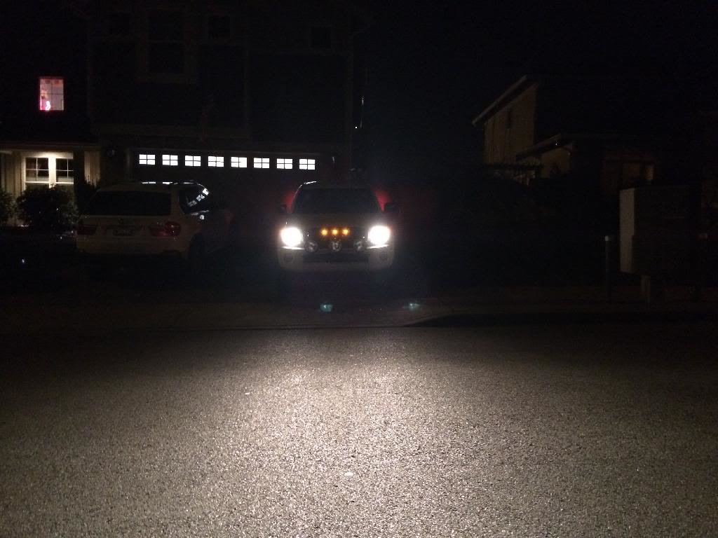

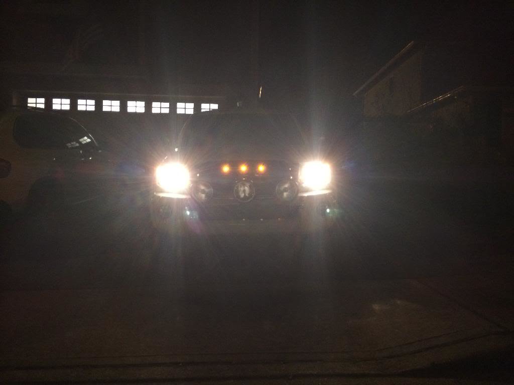

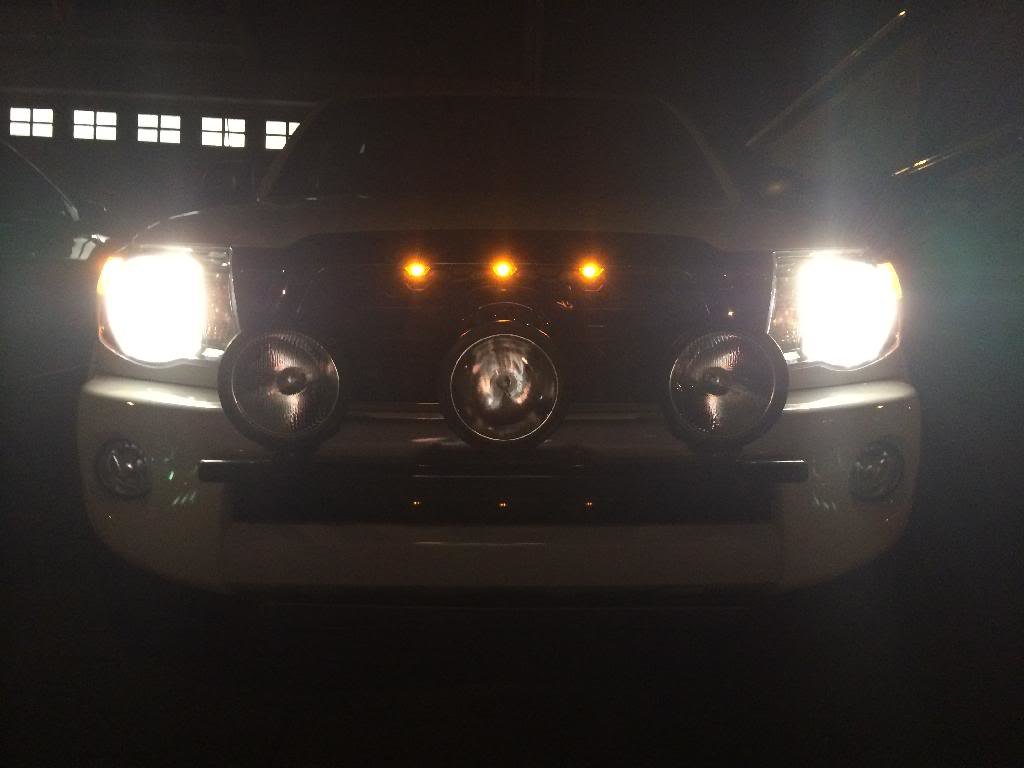

    Night shots, moving further back with each shot. The Optronic LEDs are DOT approved and PC-rated. In the last shot, you can still see the lights even with the headlights on. I guess I should have flipped on my 3 VisionX 8500 HIDs for a real test!
    564A8E2F-85EB-44FF-B95D-A99C7BD08958_zps_8b27975c57ac9215804da821b4017c2e0db6be7c.jpg
    88DEF3FD-C32F-45DA-95E9-D93FA9275AB7_zps_5cbdae3bea09b718dfe5bd4217166b57d1e64ffb.jpg
    7E78B9E4-38C4-416C-AFA2-D2044720434F_zps_c9d32b226223584a053983e0f569e2519c43798d.jpg
    B87D476A-B7DD-4E04-90AA-0F069A8213E2_zps_e8bd758167829a9bd7a3c5967ab304a6b6d0e70a.jpg
    I'm actually tempted to get 2 more and mount them in the bumper for a genuine setup.......
